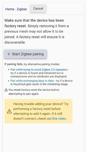

2. In Hubitat, pair by selecting "Devices", "Add Device", "Find by device type", "Contact Sensor", "Generic/Other", "Generic Zigbee Contact Sensor", "Add", "Start Zigbee Pairing", THEN press the sensor's button quickly every 2-3 seconds until "Found a Zigbee device, initializing ..." appears (at which point, stop pressing the sensor's button).

  2. Start pairing the sensor while within inches of the hub [maybe try picking the "Aqara Acceleration Sensor"]; and
  3. Press the reset button quickly every 2-3 seconds until "Found a Zigbee device, initializing ..." appears (at which point, stop pressing the sensor's button) [I'm assuming your sensor HAS a reset button]
