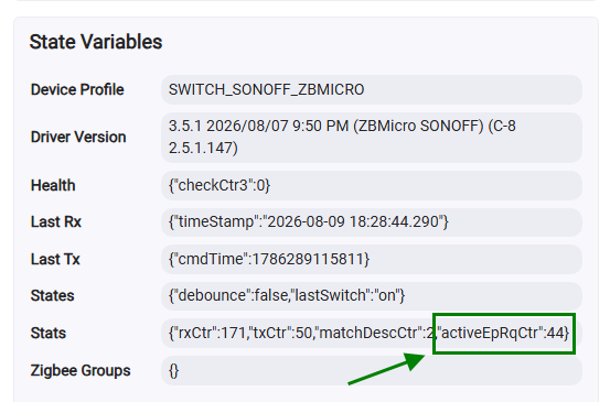

A ZBMicro oddity is that it uses a non-standard way of checking the online/offline status of the Zigbee coordinator. It periodically sends ZDO Active Endpoints Request messages to the hub and expects an answer :
