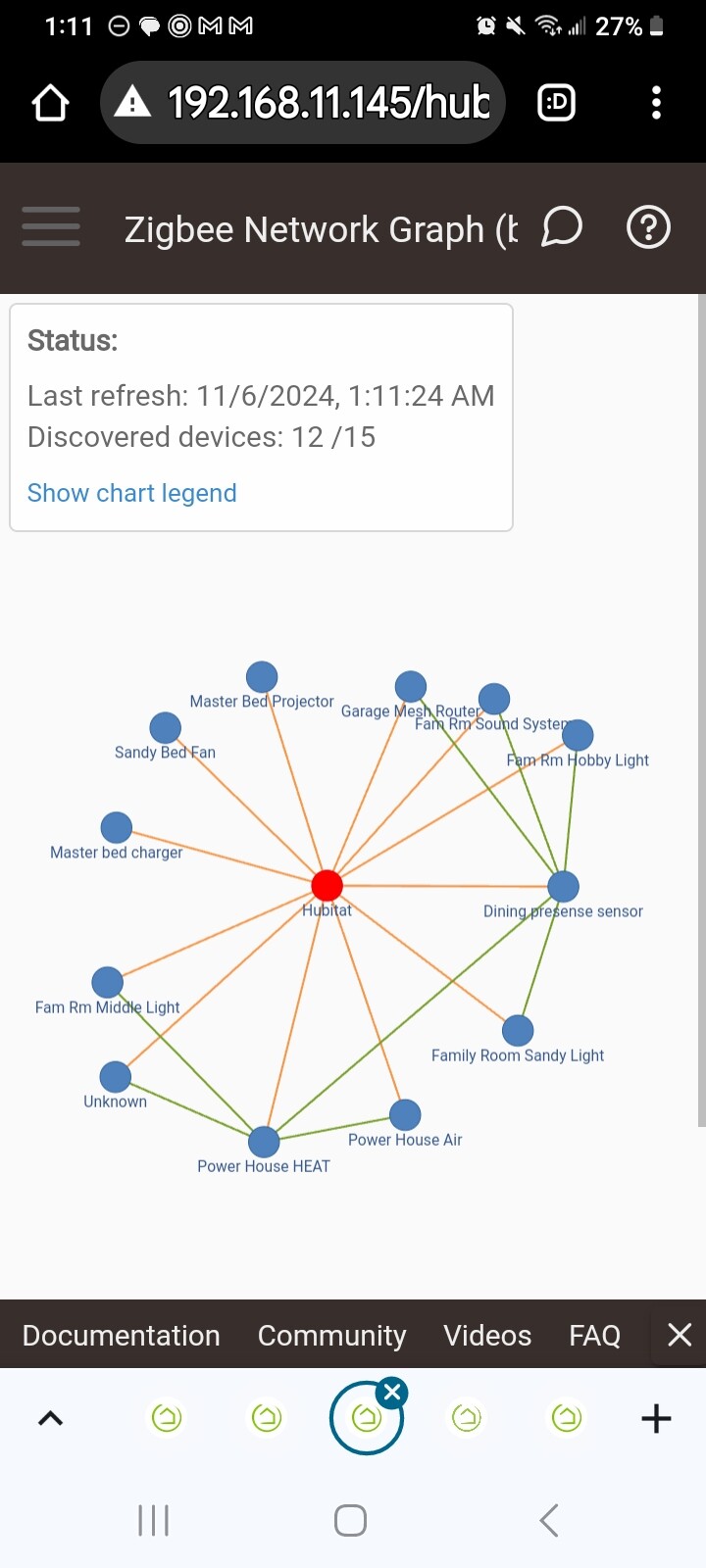

When you go to the Hubitat Zigbee details section, do those devices that don't show on the Zigbee map show with recent activity:
Curious if it's a Zigbee communications issue, or just something on how the zigbee map tries to retrieve them.
My Zigbee routing map has a bunch of devices that show with the red circle, but the neighbors map populated them all (actual more than all, 52/51 :slight_smile: )

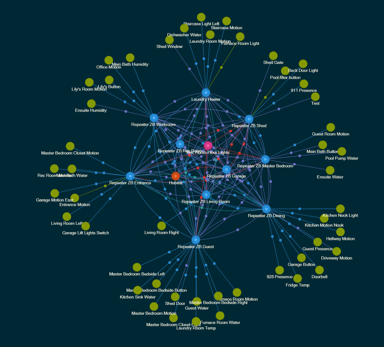

Can you please post a picture of the map?
I only have one and I did try that a while ago. It interviews but doesn't change the map.
The only thing I find that works is to delete the device and add it back.
Too much work to reassociate 10-12 items just for the sake of the map, sadly.
I like my map.
That is one impressive map you have there. How did you get certain devices to connect to specific repeaters?
Here is mine. Lol
The Tuya repeaters are very strong so they are ZB magnets. :wink:
I lowered my hub power to 8 so nothing connects to the hub.
I also join any device at the location so it will always see a repeater first.
There are still 12 that won't show up so it's not that impressive :rofl:
