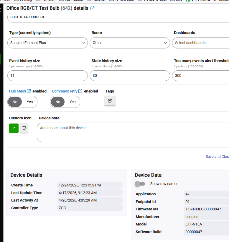

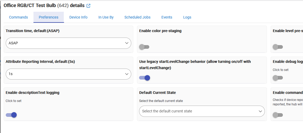

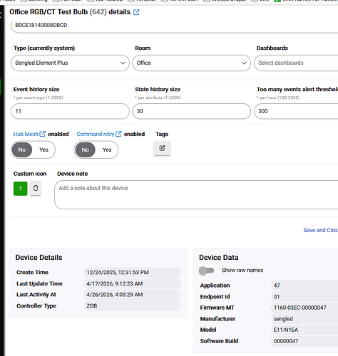

Mine (just checked, I have 3) work best with these settings:
Are you sure your using the Sengled driver?
