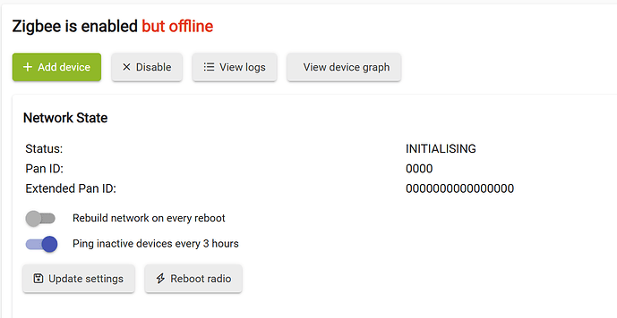

Got my brand spanking new C8Pro to replace my C8, but restore of a cloud backup failed with an unknown error.
Zigbee radio remained: "INITIALISING".
I next factory reset the hub, got the "welcome to your Hubitat" screen, withour registering went to the zigbee page, and agan: INITIALISING
Tried zigbee disabled > remove power for 60 seconds > power it again > INITIALISING
No matter what I do it remains in INITIALISING status.

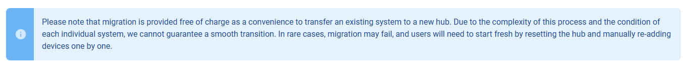

We are aware that migration may not be successful in all cases, as mentioned in our documentation:
