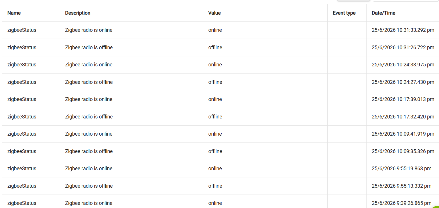

i have stopped using the remote admin for few days and discovered that the zigbee didn’t go offline. yet another observation, is that when checking hub events in the logs i see the zigbee going offline and online frequently without causing the zigbee goes permanentely offline like before.
