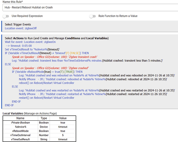

If you want to monitor your Zigbee radio behavior, you might try this Rule, which logs brief crashes (less than 5 minutes) and either reboots or restarts (your choice by setting the vRebootMode boolean variable) the hub.
