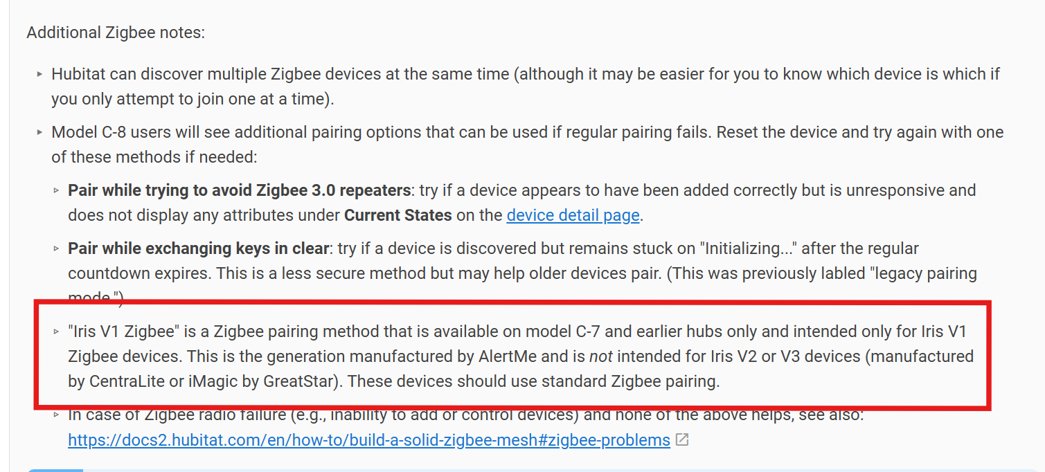

What is "pair while exchanging keys in clear"? how do i try that?
AFAIK that pairing approach doesn't apply/and won't be displayed when you're trying to join Iris V1 Zigbee devices.

You can't pair V1 Zigbee devices to a C8, but you can migrate them to a C8 from another hub. That would be how you have them on the C8. :slight_smile:

Theyโ€™re not. They Iris v2 sensors, OEMed by Centralite. V1 cannot be paired with a zigbee 3.0 coordinator.
Nope...V1 sensors just won't pair w/a C8 or C8-Pro. Last supported hub for Iris V1 was C7.
