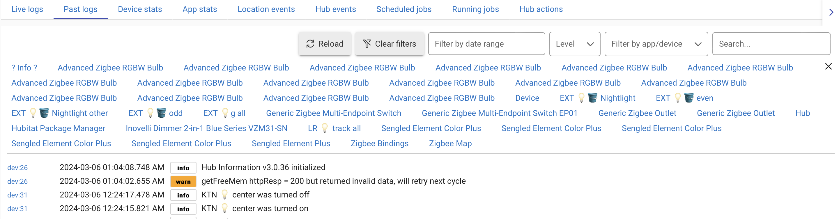

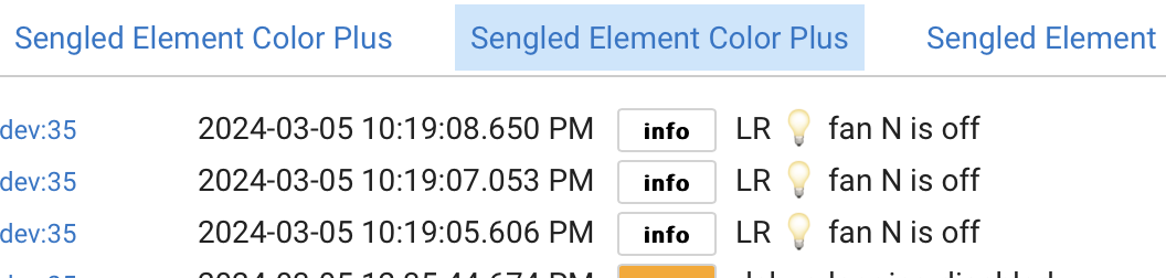

Then I looked at the log files and everything is showing in the filters as the device driver name rather than the device name.

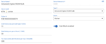

For example, the bound bulb mentioned above is dev31. It is named "KTN :bulb: center" but in the filter section is it "Advanced Zigbee RGBW Bulb". You can see that all the bulbs are listed the same. The only things showing up correctly are non-Zigbee entries. For example, all the ones with a :bucket: are groups.

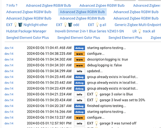

I assume you are referring to the log anomalies. I did both on one of the devices and it didn't change anything.
You can see that it is still listed under the driver name. I'm not sure what the group messages are. If it is related to Zigbee binding then that light has never been bound to a switch.

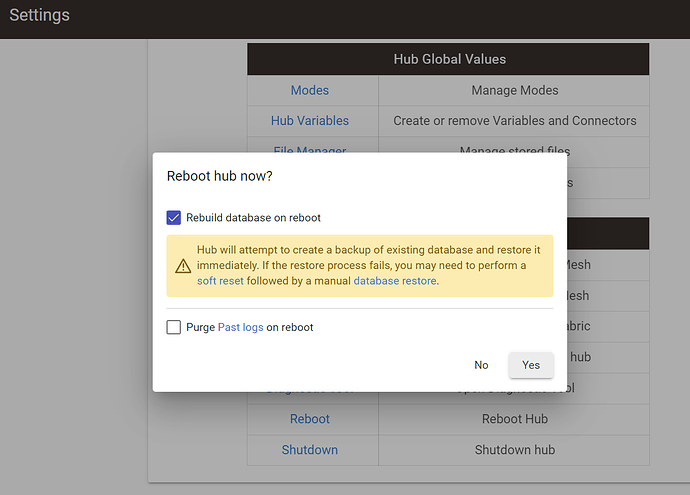

EDIT: Perhaps that could happen if you just added several of the same devices, or deleted and rejoined devices without naming them. You could try doing a reboot with the log purge option checked and see if that fixes things.
I was thinking of purging the logs on one of the hubs. I wanted preserve at least one full log history in case we need to look back. I just haven’t tried it yet.
I definitely named them when I joined the devices. I’m rebuilding everything on the new hubs after years of learning, experimenting, and a failed radio. The naming convention is something I settled on after a lot of trial and error.
if you removed and readded the devices you can get log entries for the same name multiple times.. usually a reboot with clear logs will fix it.
Reboot, reboot with DB rebuild, and firmware update all didn't help.
As noted above I didn't want to do that in case we needed to refer back to something. That was before I noticed that the C8 pro was also having the same issue. I just purged the logs on the pro and it is working again. I should have tried sooner. :smiley:
