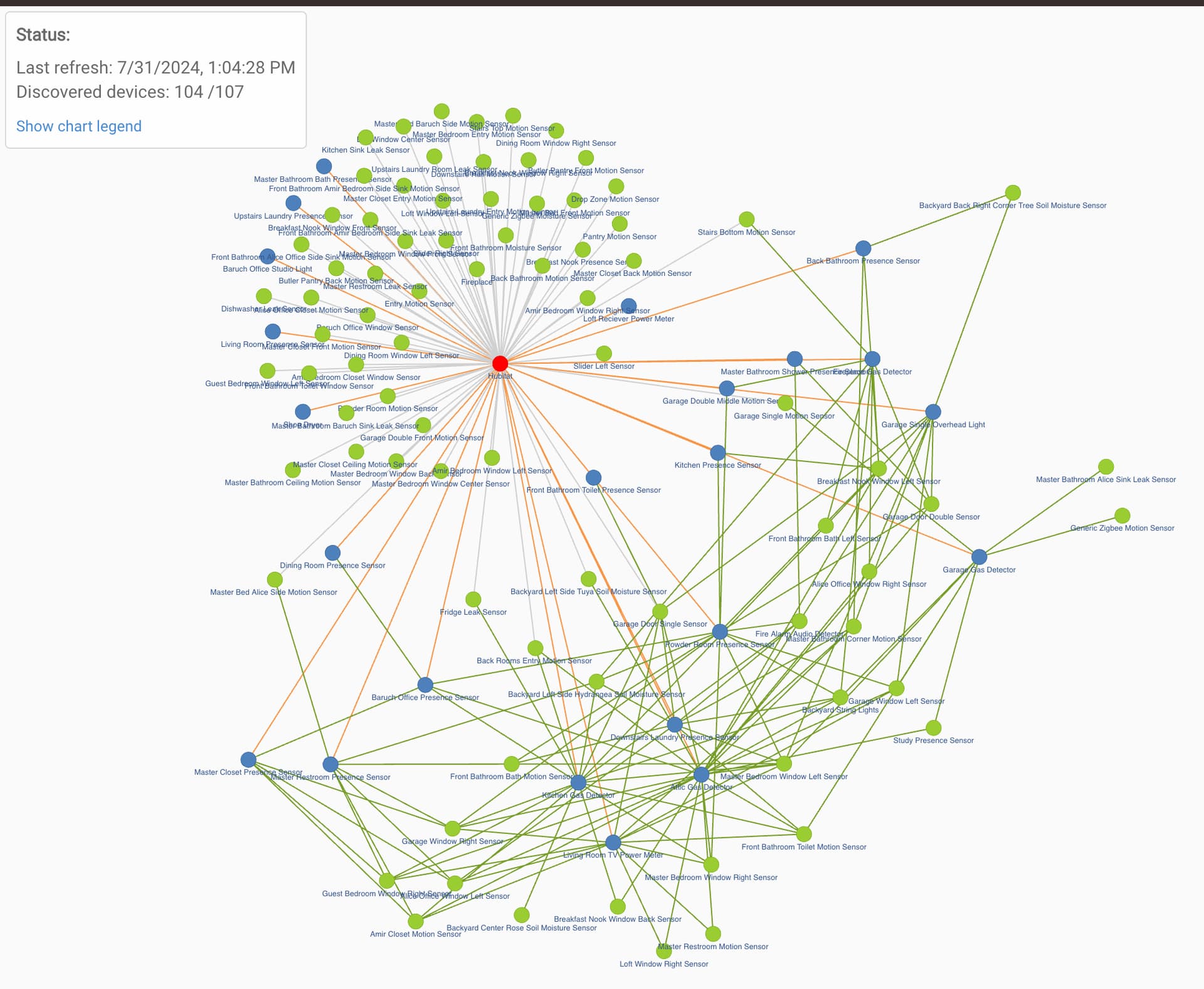

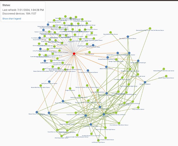

I highly doubt that. I fired up the network graph and will let it run for a couple of hours and will post it here, but I have A LOT of repeters.

Here's the latest graph after switching to 25. No new "reconnected" messages. The 3 devices it can't see I'll probably need to reset and reconnect manually. So far so good, thank y'all for help!
