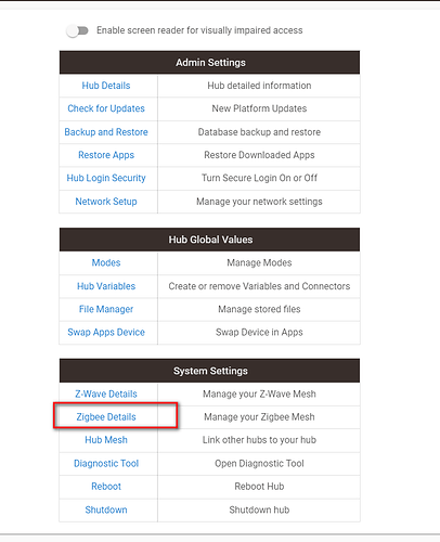

under settings, check zigbee and be sure it is enabled
Yup, enabled. I even tried Disabled/Update option followed by Enabled/Update. Didnt help.

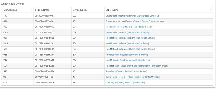

Also provide a list of all your zigbee devices.
I did that for about half the sensors and that brought evrything back to life for about 2 hours. Now everything is back to chaos :rage: Some work, some sort of work while other dont work at all.
