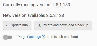

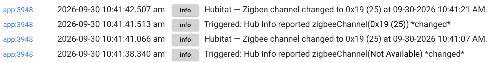

Updated my C8P to 2.5.2.128 this morning and when it rebooted I got a "zigbee channel changed" message from an alert that I set up years ago that's never before triggered. But the channel hasn't actually changed. I've never seen this before. Looking at the logs I'm wondering if the zigbee radio went down while rebooting?
Has anyone else seen this? Makes me leery of rebooting now.

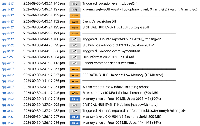

Everything was cruising along like normal with good memory levels, etc. And suddenly the memory dropped from 904 MB to 10 MB, the hub rebooted, the zigbee radio went off (but came back on again). This started after I updated to Zwave-JS, but not sure if that's the cause. I will try shutting down and pulling power. I haven't had it reboot for low memory for ages and other than pulling power I'm not sure exactly how to diagnose this or what my next steps should be. Help?
ETA: I shut down and pulled power, and rebooting did not cause a zigbee shut off. [fingers crossed] Still would like to have some idea of what's happening here.

The channel "changed" from "not available" to your original channel, that was the change in the logs, because something didn't update channel in time, or something.
As for the hub memory crash, there are no logs surrounding that posted so you would need to look into it more to find the cause. Main thing is to see if the memory crash happens again or if it was a one off related to the update.

There's an "Error parsing eventstream data" error from my Hue Bridge about 5 minutes before the memory crashed. But that's never really been an issue and I don't see anything else in the logs other than business as usual.
