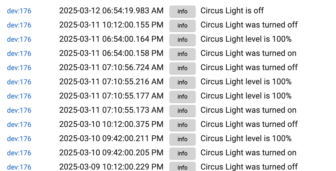

As you can see from the logs, the bulb has a mind of its own:
The 1012 off command is understood via a rule and the turn on around 650 in the log is around the time of sunset over the last few days.

I was trying to analyze your logs, but I can't see any that appear to be random.
Could you point out (by timestamp), which entry in this log you consider as "random"?
Also what do you mean when you preceded the "Events Log" by "No entries today for the bulb here", since there are obviously several entries.
The issue is that there are no entries in the log but the light is on. It shows off at 1012 in the evening per the rule and I can confirm that it is .
However when we get up in the morning the light is on and there are no log entries that show that it was turned on by the hub and when I go to devices in the app to turn it off the light shows as off. Only way I am able to turn it off in the app is to click the icon to turn it on and then click it again to turn it off.

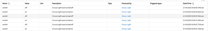

Tested Bulb via devices tab
Results
Bulb flashes
Bulb turns off from flashing via off command
Bulb DOES NOT Turn on via on command
Logs
Events
Device info

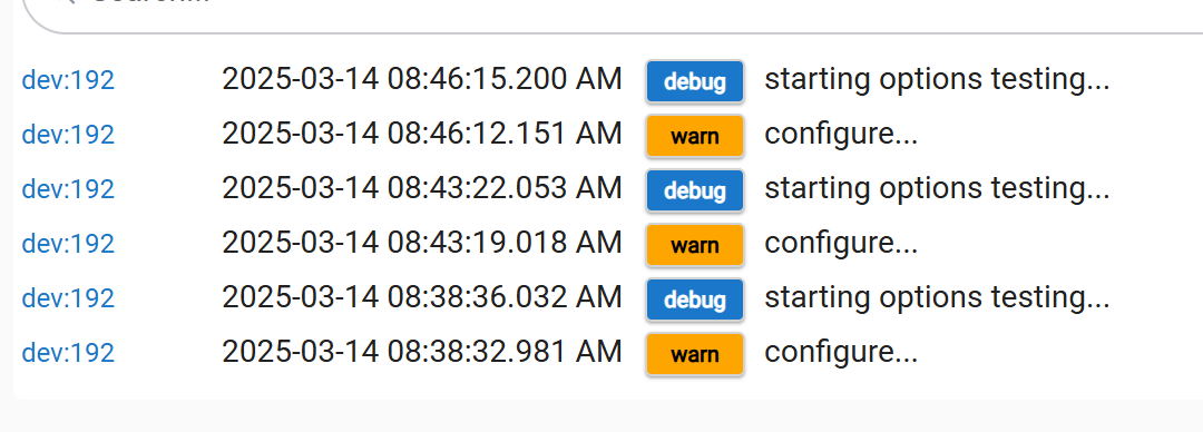

Turned on debugging and tested functionality again
Is this one a gonnnner?

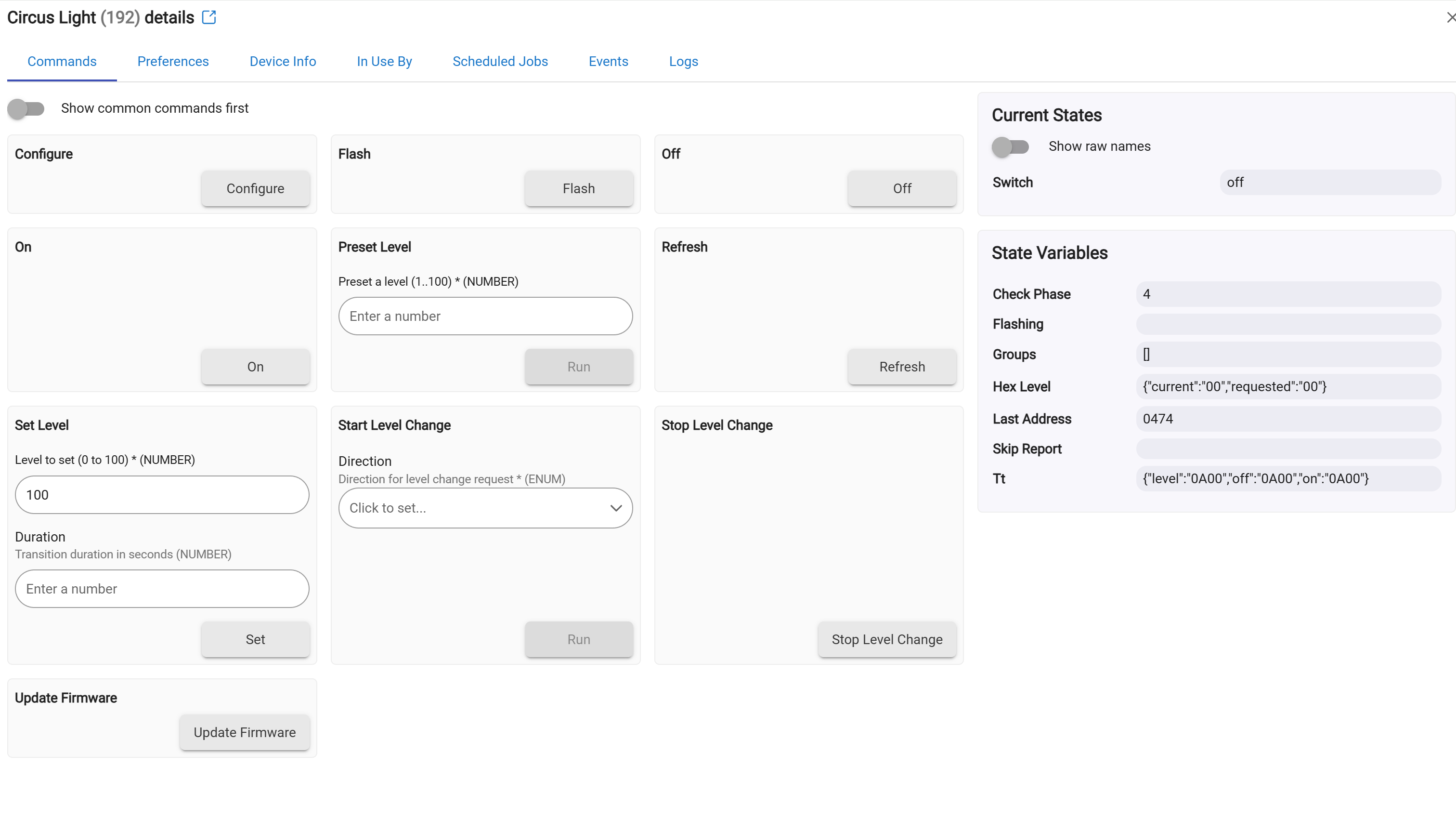

Go to the commands tab of the device page.
Under "set level" change the value to 100 and see if that helps.
It was already set to 100 when I went to that page
