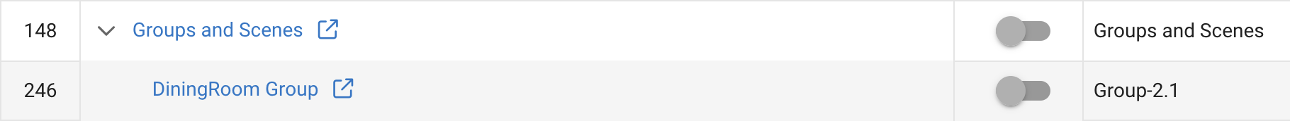

I also eventually tried a Group Binding
But the Inovelli shows unbind

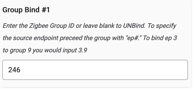

I never did get individual bindings to work, but to get group bindings to work, I just had to add the Group # to the Inovelli switch Preference - Group Bind #1
