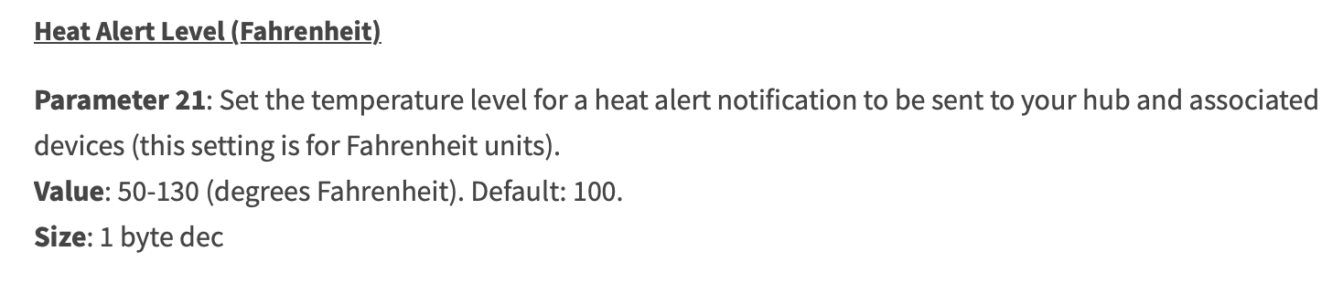

Seems to be a discrepancy in heat alert level between what the device driver picked up and the Zooz doc. Not that alerts will likely be a factor:

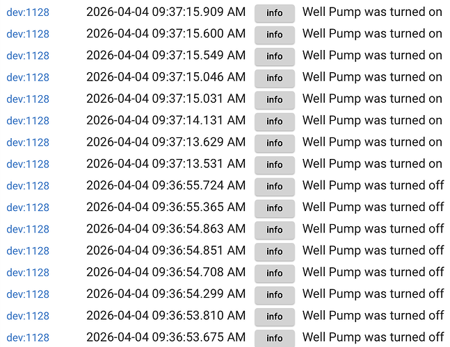

Device reports multiple "Ons" and "Offs".
Doing a load right now, but I'm pretty sure I've seen the multiple "Offs" as well.
edit: I wonder what could cause this? 8 reports in less than 3 seconds.
Is this on Zwave JS or ZIP?
It is probably just the device sending multiple reports for whatever reason. The driver is possibly issuing a "Get" command to be sure it gets the current state, which may add an extra one (or more depending on how the device reports it).
This is why on my drivers I suppress duplicate logs like this to debug logging, although usually it is just 2, not 8.
Debug logs might shed a little more light on what is going on, if the actual reports are slightly different.
ZWJS
I recall mention of similar issues in the past.
Events are fine.
It doesn't seem to affect any rules, far as I can tell, but I guess that'd be a possibility.
edit: Not a debug log, but an nice picture. :slight_smile:
debug log:
This one is different than the others:
Probably just bugs in Zwave JS
