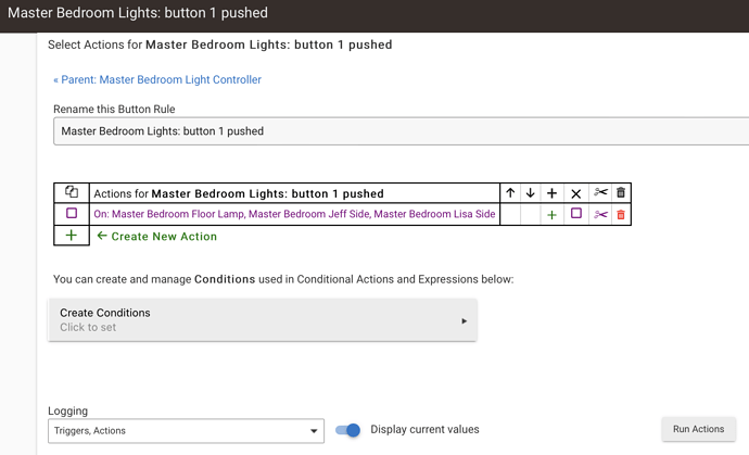

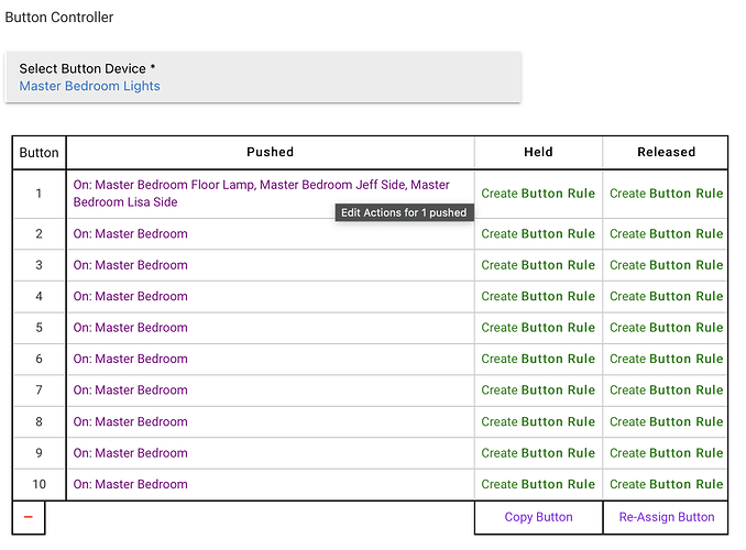

I've installed the built in Button Controller app, but not sure which buttons correspond to the on/off paddles on the zen77. I tried setting up Button 1-10 (the zen77 says it has 10 buttons) pushed to turn on my Hue group, and turned on both of the logging options on each of the rules, but am not seeing any response from pushing the buttons on the zen77. I do see the zen77 state changes in the hubitat logs, but doesn't appear to be triggering the Button Controller.
Also, I tried running the Button Controller action from the child app page, and it sure does turn on my Hue group right when requested.
What driver are you using? The built-in driver probably only has two buttons and maxes out at double taps. I'm assuming the community driver I'm aware of (and there may be more) exposes all taps with different numbers. But the easiest way to tell would probably be to keep descriptionText logging (some times called info or event) logging enabled on the device, then try the various taps and holds and whatnot and see what gets logged. "Current States" on the device detail page will also show you the last button number for each event, though unless you keep an eye on what changes when, it's probably a bit harder to use for this purpose.
I was using the Zooz Dimmer Advanced driver, but tried switching to the default zooz zen 77, which presented 2 buttons, but still didn't seem to have much luck.
