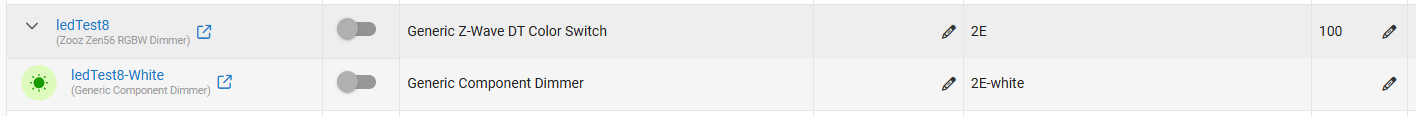

@jtp10181 There has been a development...
So at one point it partially worked but I failed to notice the expand icon in the first column until I wondered why the icon wasn't showing anymore. :face_with_diagonal_mouth:
It looks like at least one endpoint is showing.
I'm about to start my testing from scratch.
Yeah I think the old ZEN31 driver did something similar, possibly had a White and Color child, but not one for every channel.
If you were not paying attention to which driver made that child then its hard to know which one it came from.
You can switch to the driver named "Device" and use the command button to remove child devices. Then switch back to your desired driver and run the configure command. If the driver uses child devices it should create new ones when you run configure.
It is the system driver "Zooz Zen56 RGBW Dimmer" that created the child. It doesn't do it immediately, which is odd, but at one point I set a color and lost control of the white channel and that's when the child appears.

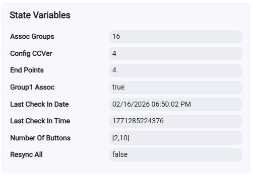

@jtp10181 Jeff, I'm circling back to this ZEN56 with additional information and a question.
I've gained a bit more experience with Hubitat and Z-Wave and decided to play around more with the ZEN56 and it's Parameter 16. Here's what I found...
Setting Parameter 16 to 0 (to show endpoints) and then excluding the ZEN56 and then including it back changes the set of Command Classes the device reports. With Param.16 set to 0 the ZEN56 reports a Command Class 0x60 version:4 [Multi Channel] and when it's set to 1 (the default) it reports Command Class 0x33 version:3 [Color Switch]. All other Command Classes are the same.
Armed with this info I searched for a driver that supports Multi Channel and came across your 2021 post regarding Multi Channel as it was implement for the ZEN30 driver you were porting over from SmartThings. In that post someone chimed in with his experience and mentioned that he was working on a Universal Dimmer driver that supported Multi Channel. His GitHub link was dead but I thought maybe you had taken over the project so I tried your Z-Wave Universal Dimmer driver.
Your driver DOES report that the ZEN56 has 4 endpoints but I haven't figured out how to display/create the child devices. Do you have any tips to give me?
UniversalDimmer4Endpoints
Thanks.
