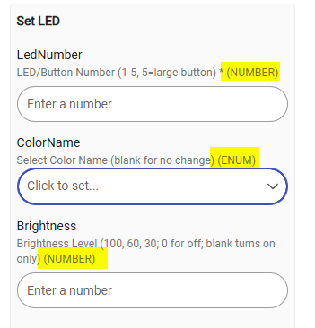

setLED is a custom command, it is not directly related to the parameter settings.
When you use custom actions in rule machine you send the parameters EXACTLY as shown on the device page, in the same order. This works the same for any command available on the device page.

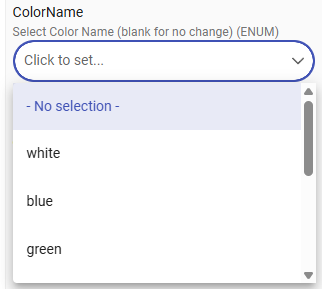

For Enum you send the exact text option you want from the dropdown.

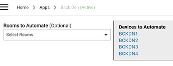

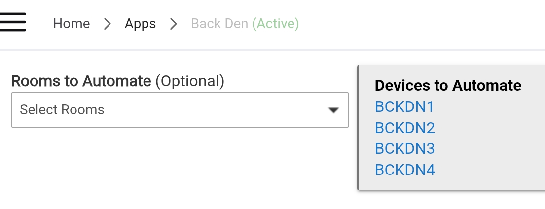

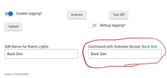

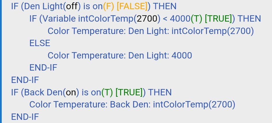

I group multiple lights into a room lighting group and then just apply the settings to all of them by using the activator device that it creates. My rule is controlling the color temperature of lights in groups. But, it should work for dimming and set level as well. (Mine is a little more complicated than sending a single command.... but you should be able to get the idea)
Create a room light group from the individual devices. Make sure the activator device is named (creates a virtual device of the group you just made), and then reference the activator device when you want to control them all together.
This approach is nice but won't work for custom commands, only the "standard" ones that are part of the activator device ("setLED()" is a command specific to the ZEN32 that changes the LED indicators on the device according to a few parameters this Z-Wave device offers, not the light/dimmer output itself).

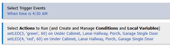

Yes it turns out this isn't much of an issue. If you are setting LEDs identically to more than one (of the same device i.e. ZEN32) then this is pretty easy. Here is a rule just to set two of the button keys the same across four different locations:

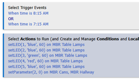

I did wonder if I could change multiple LEDs (on the same device) with one action command in a rule by concatenating the parameters. For instance (change LEDs 1-5 all to blue @ 60%):
setLED(1, 'blue', 60, 2, 'blue', 60, 3, 'blue', 60, 4, 'blue', 60, 5, 'blue', 60) on MBR Table Lamps

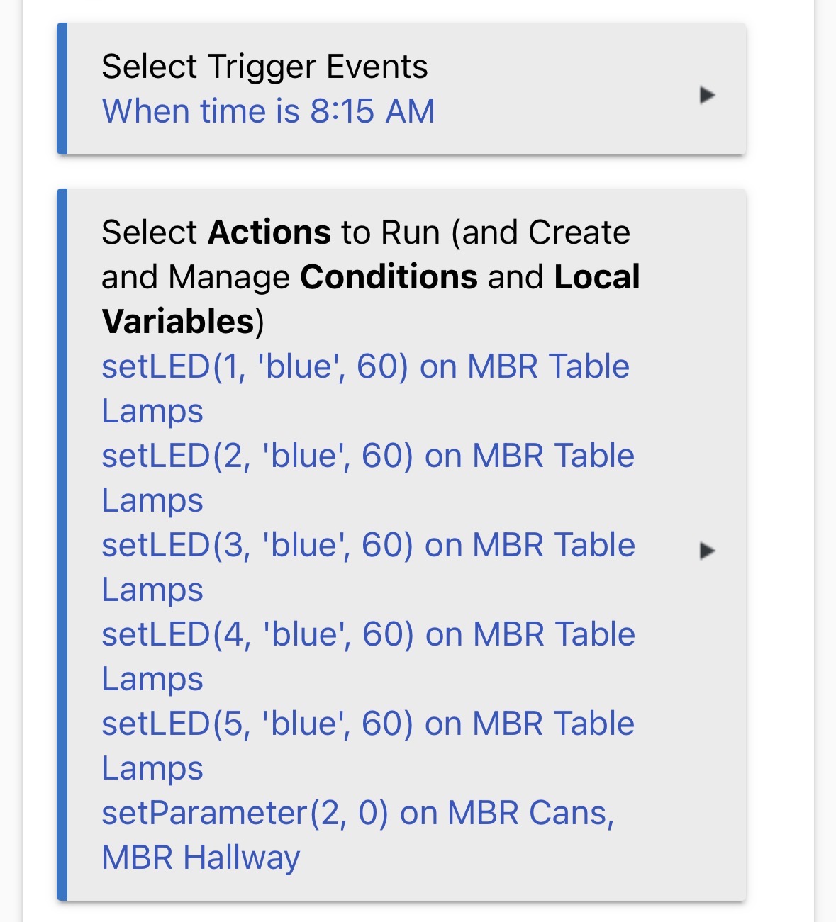

But this didn't work presumably because setLED is just a command for a single instance at a time. So I had to do it as shown below. The editing of the setLED commands is a little clunky which is why I was hoping for shortcut but it's not like you do it that often. So I am fine with the result below
