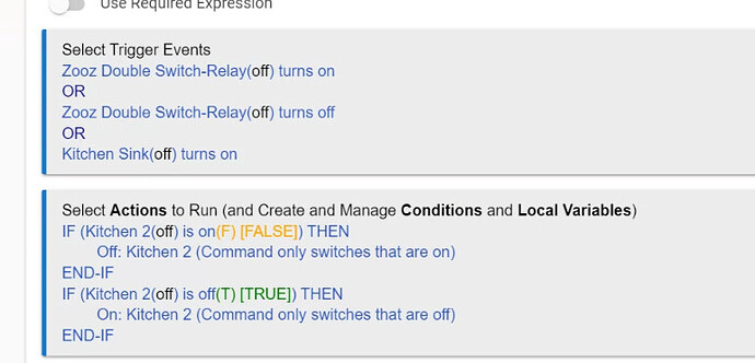

Here is an example of a rule I created
Now the problem I have is that the rule doesn't change the state of the button if a remote light is manually turned on.
I know there is a better way to build the rule. I would really appreciate any help building a better rule including if I need to change configuration of the switch.

I am wonder the best rule to accomplish this task.
My current rule is like this
I am not familiar with the Zen30 so maybe I am missing something, but one problem I see, is if your rule is triggered and if Kitchen 2 is on you turn it off with the first IF.
Then, since you now tuned it off, your rule will turn it back on. Since the second IF is ran after the first IF kitchen 2 will always stay on if it is on when the rule is triggered. You need to have the second IF as an ELSE. You could also just toggle Kitchen 2.
