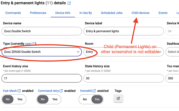

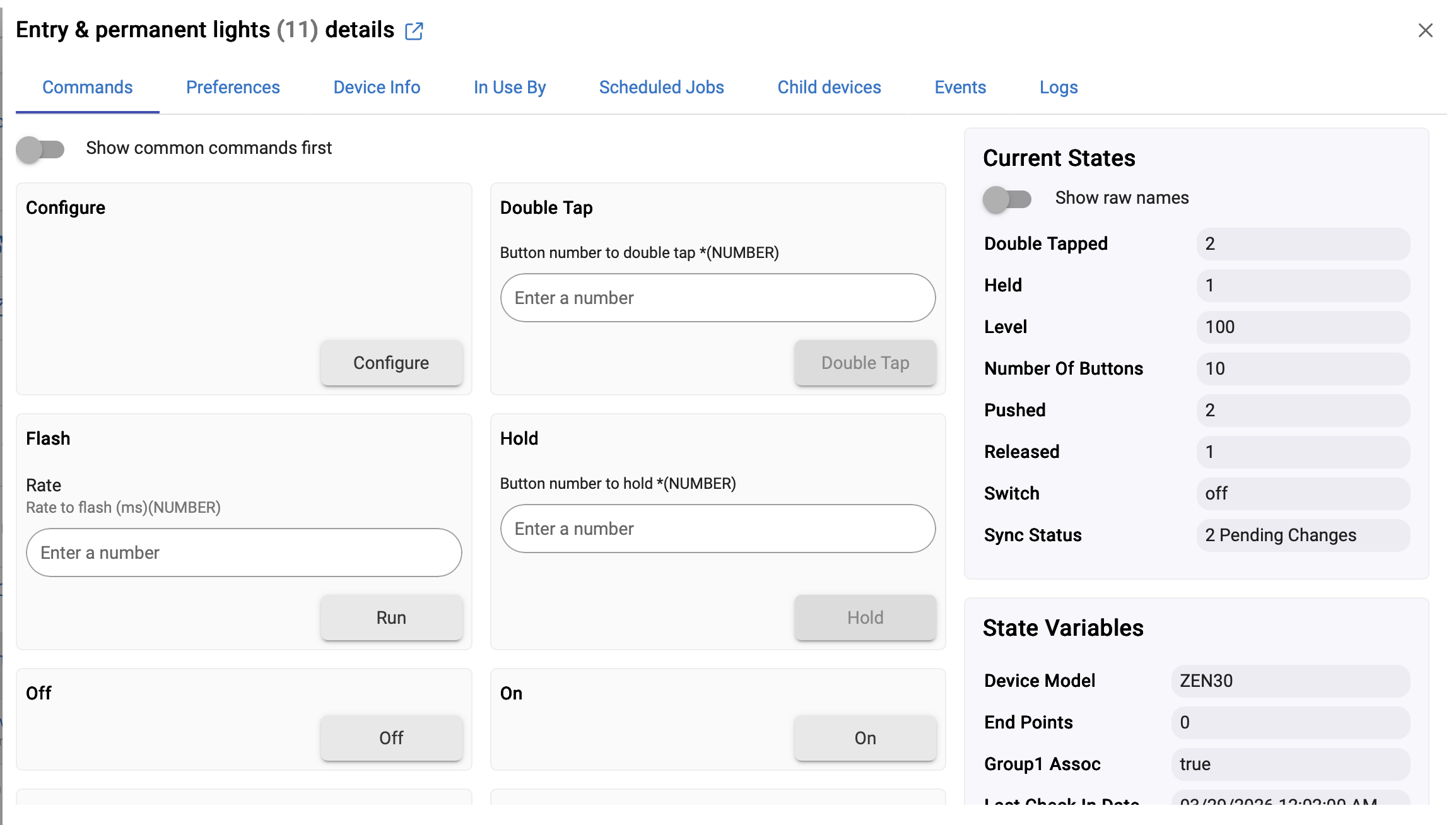

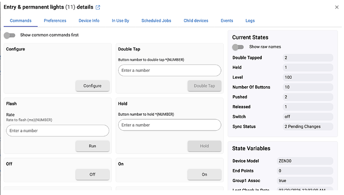

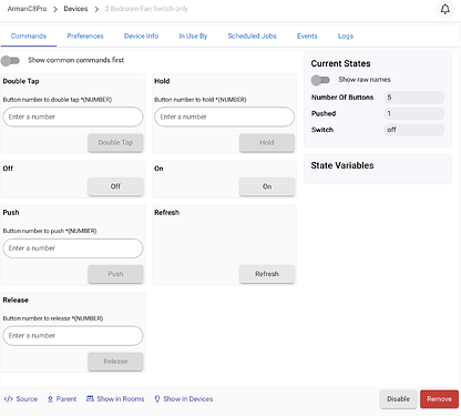

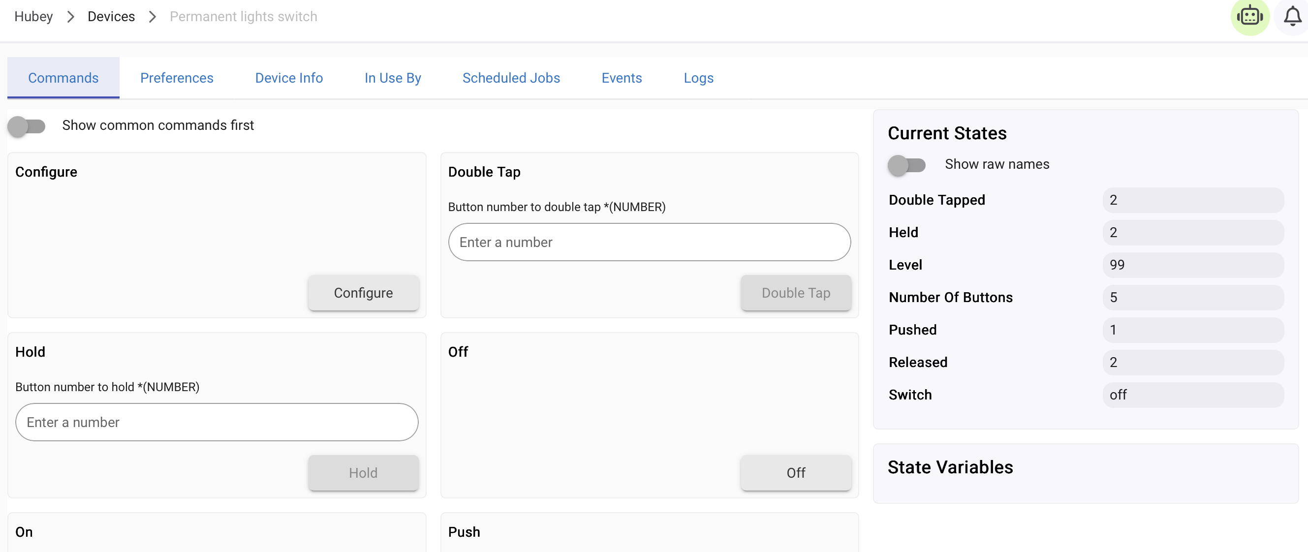

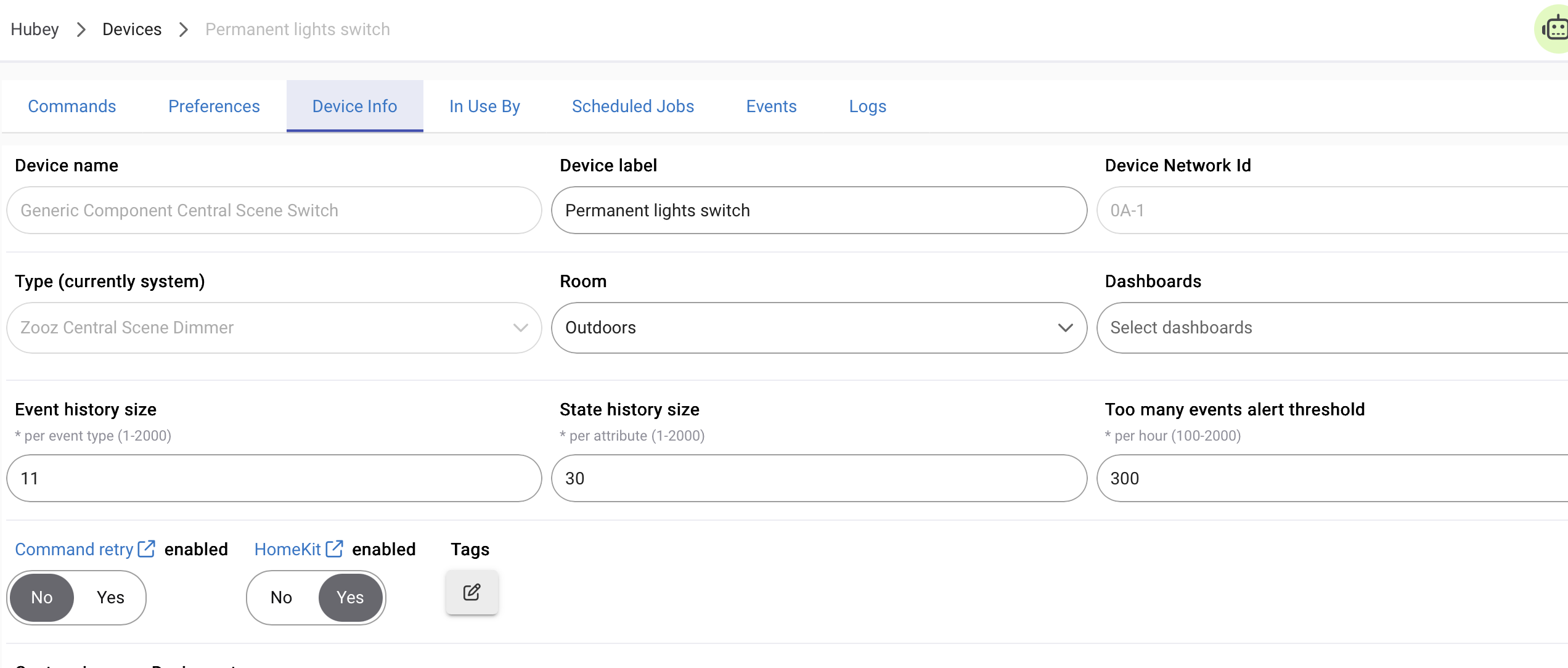

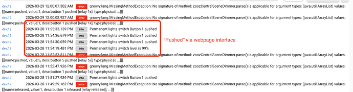

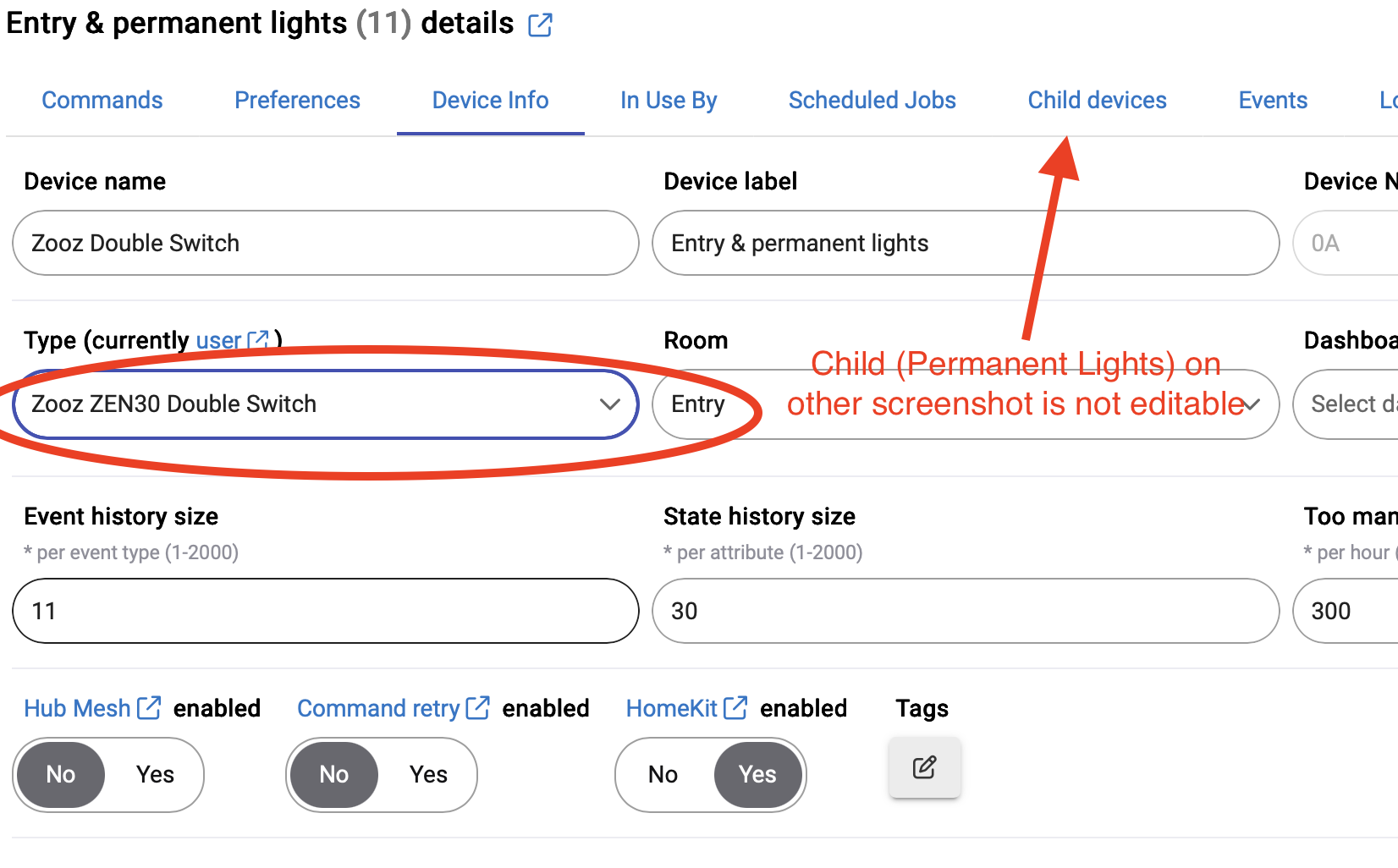

Ok back to the ZEN30... I am losing my mind over this switch. I updated to 2.4.4.155, and now the "relay switch" thinks it's a 5 button scene controller, and I am at a complete loss. I cannot change the type now. I do have error logs but I have no idea what they mean.
It was working as desired before from the physical button, but it is now not. The software "buttons" from webpage and HomeKit work fine. (but not the physical button)
Sorry everyone I am growing very frustrated on what in my mind should be very simple stuff.

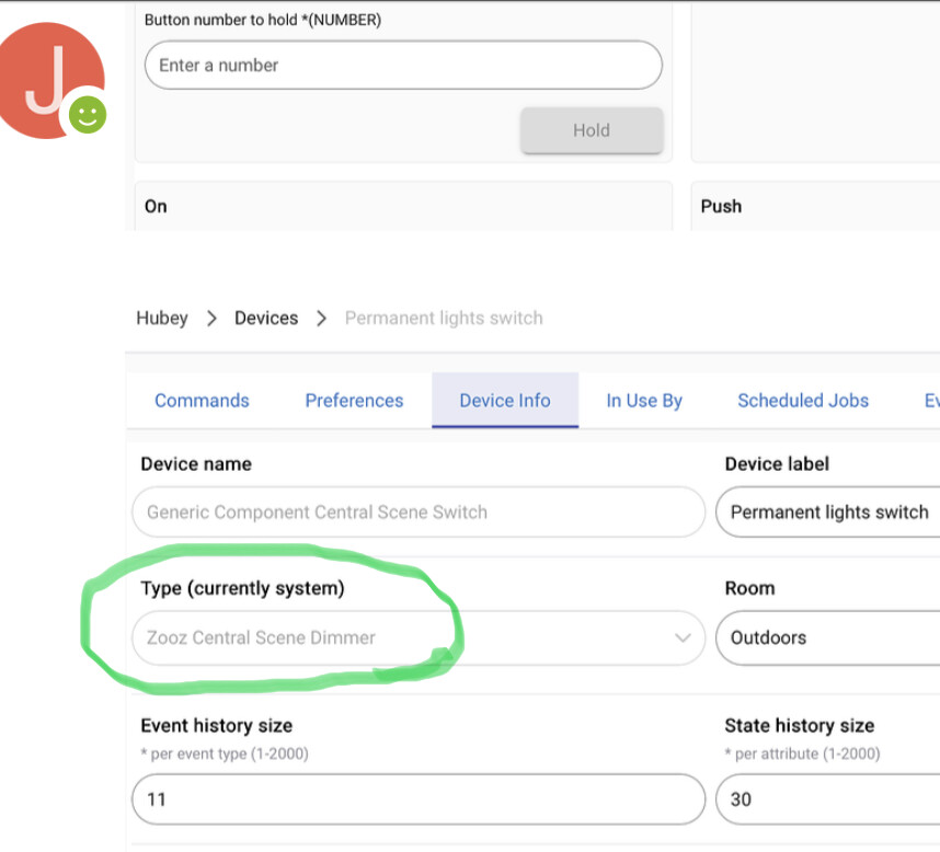

I’ll jump in since I am a big fan of Zooz. Here is what I found about current firmware. Make sure it’s up to date and you are using the correct driver. There are Zooz 5-button devices, Zen32/35 that maybe you accidentally selected as the driver under device info/type. I see you have it as a central scene controller. That is your issue I think. Maybe that should be Zooz double switch.

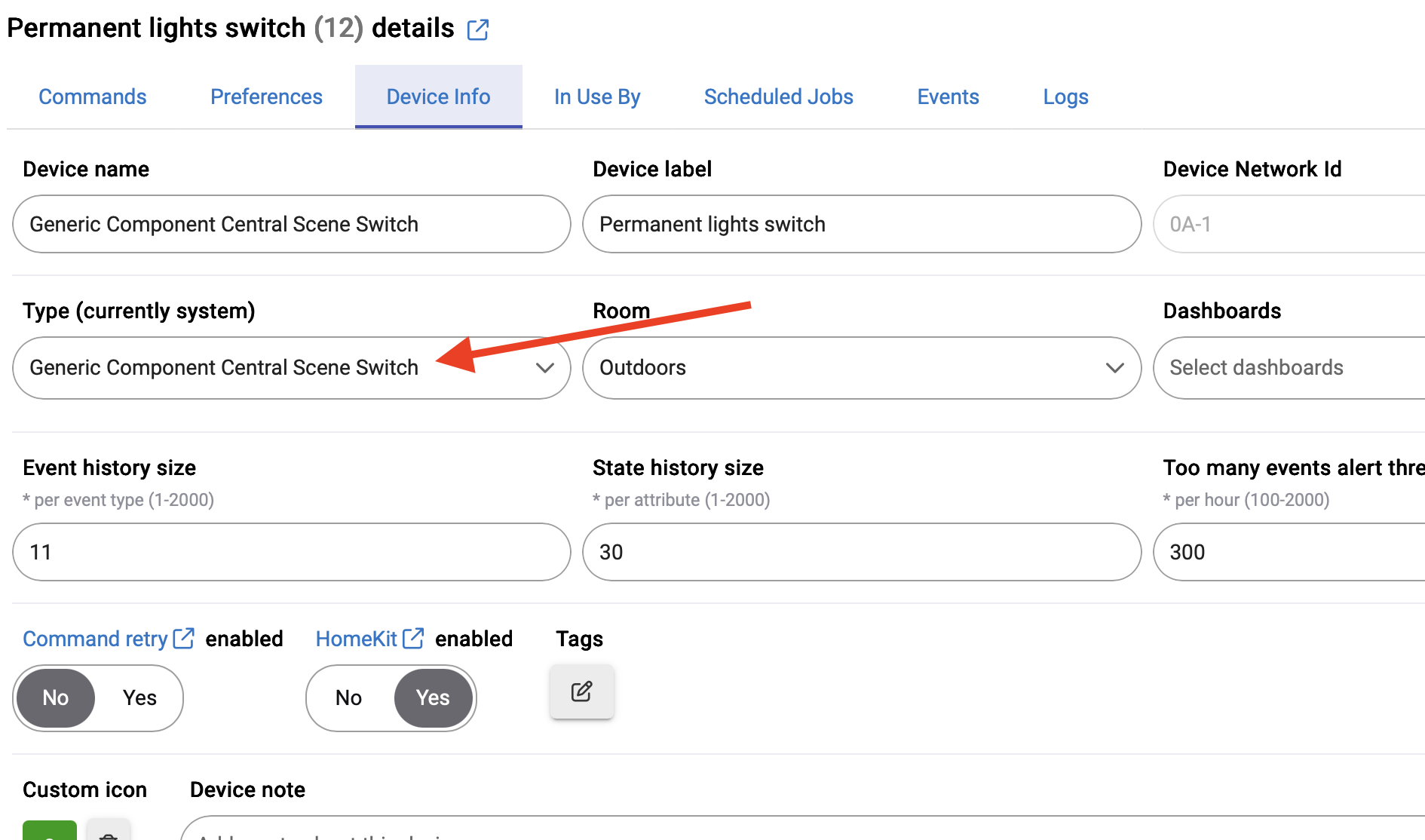

You’re using the wrong device driver:
You need:
Thank you; Current firmware is 4.30. 4.40 is available but I am not excited to remove the switch

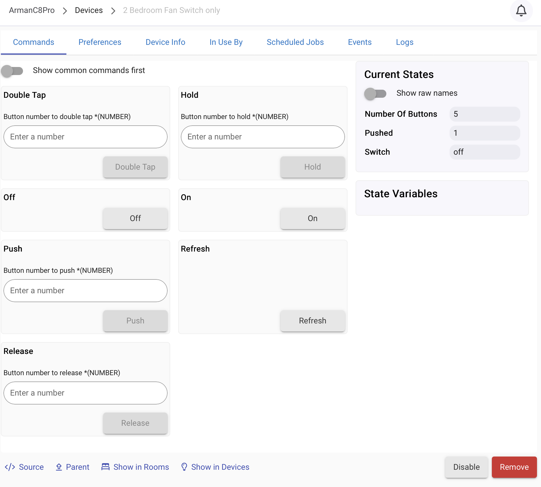

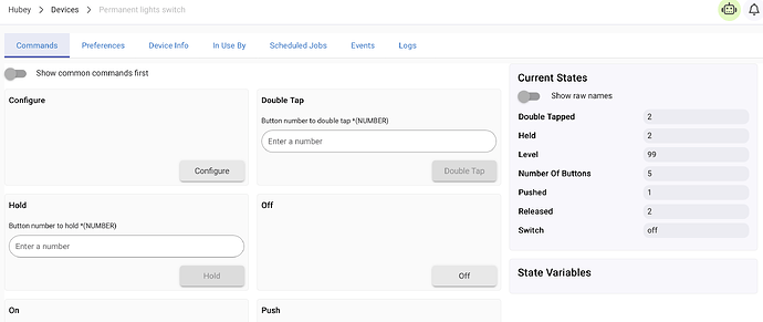

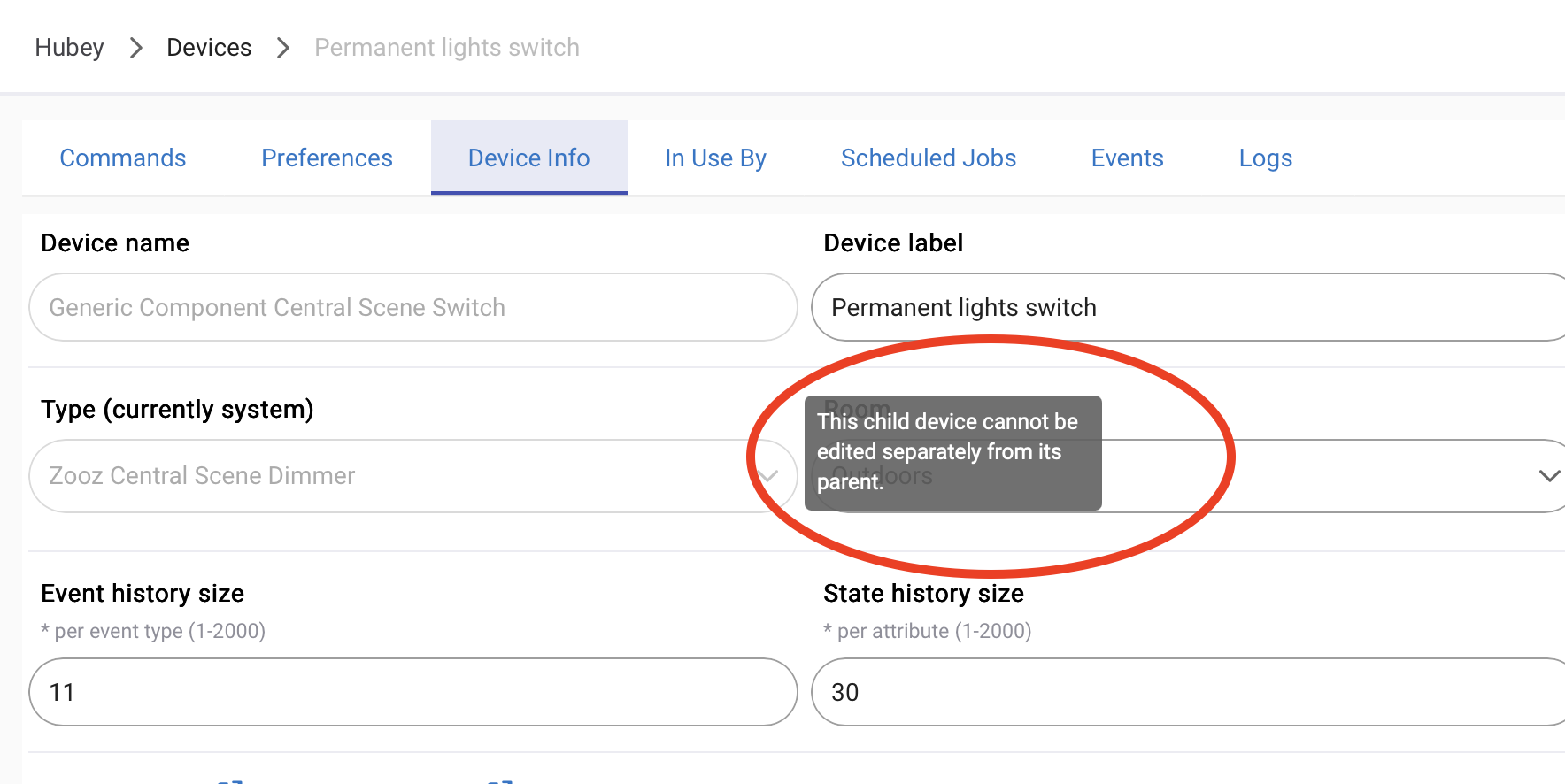

I have that device driver in the parent, but the child (the relay switch) is automatically(?) populated (greyed out) and I cannot figure out how to change it.
I am not sure if it is was set to a central scene dimmer when working, or if this somehow changed with the firmware update or some other event.

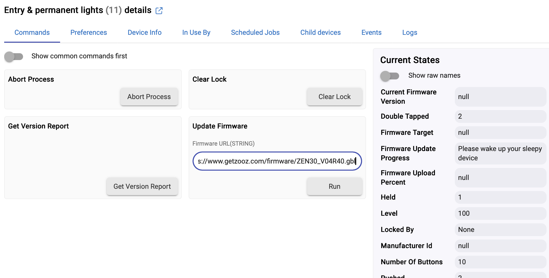

Another update, I tried to update the firmware (4.40...gbl) with the tool, it gives me the "please wake up your sleepy device." I push buttons, etc, I cannot locate the device instructions to ''wake it." This is odd to me since it is not a battery powered device...
Note I have begun a support ticket with Zooz.
Sorry for the updates & my confusion... I found the built in updater and it is in progress...

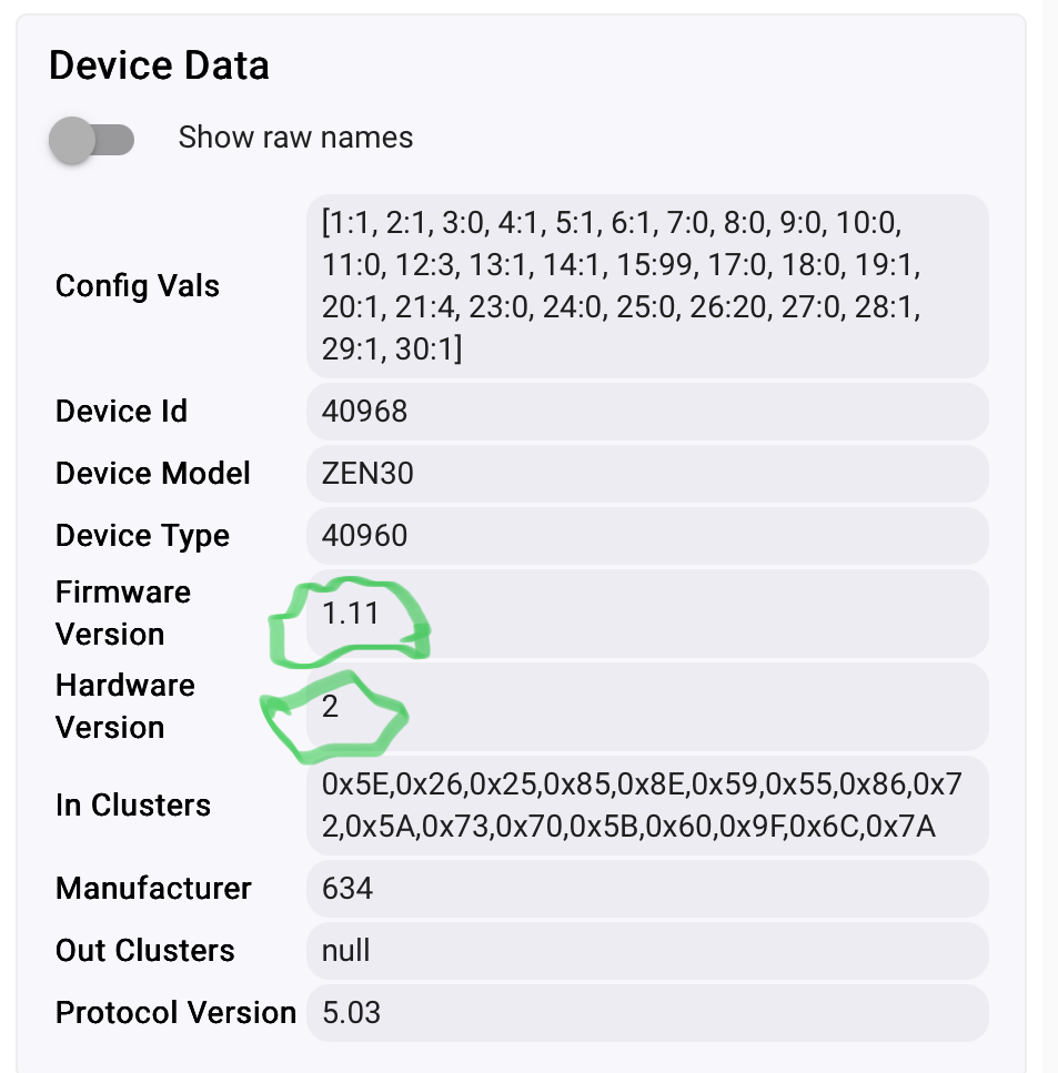

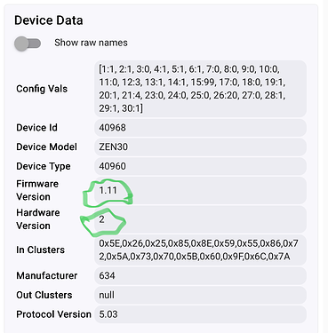

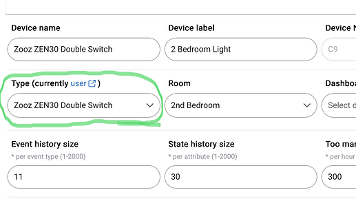

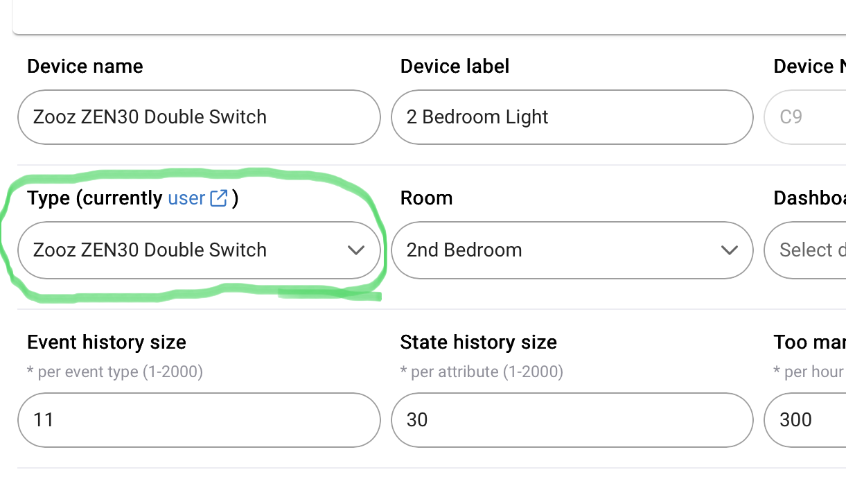

Ok, my mistake. My ZEN30 (dimmer) and child (switch) uses same driver as yours.
Here’s the hardware/firmware version info for mine.
You all are making this way too complicated.
Switch the driver on the parent to “Device” then use the command button to delete the child devices.
Switch back to my customer driver (recommended) and then run the configure command. Should be all set from there.
Thank you, this resolved it!
I wonder if/why the firmware update changed/broke it; I was using that driver 'before' it changed, but thank you again!
