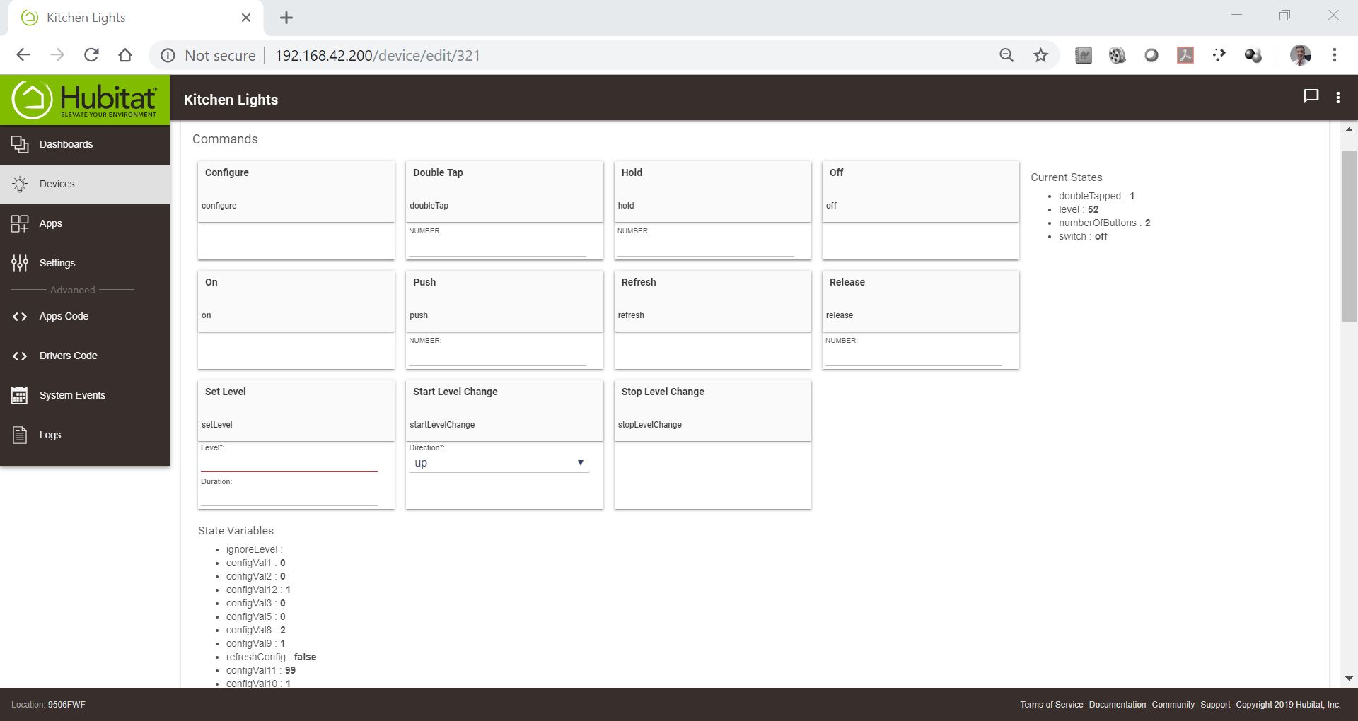

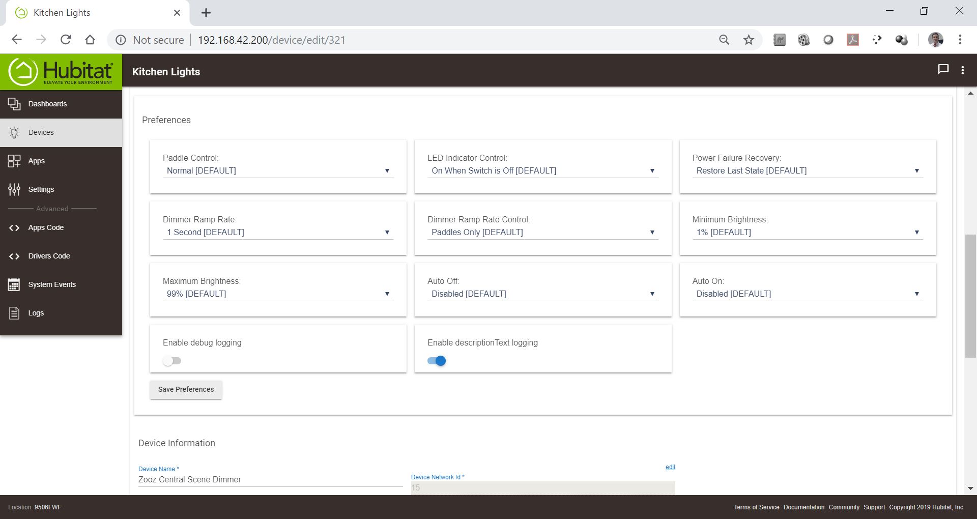

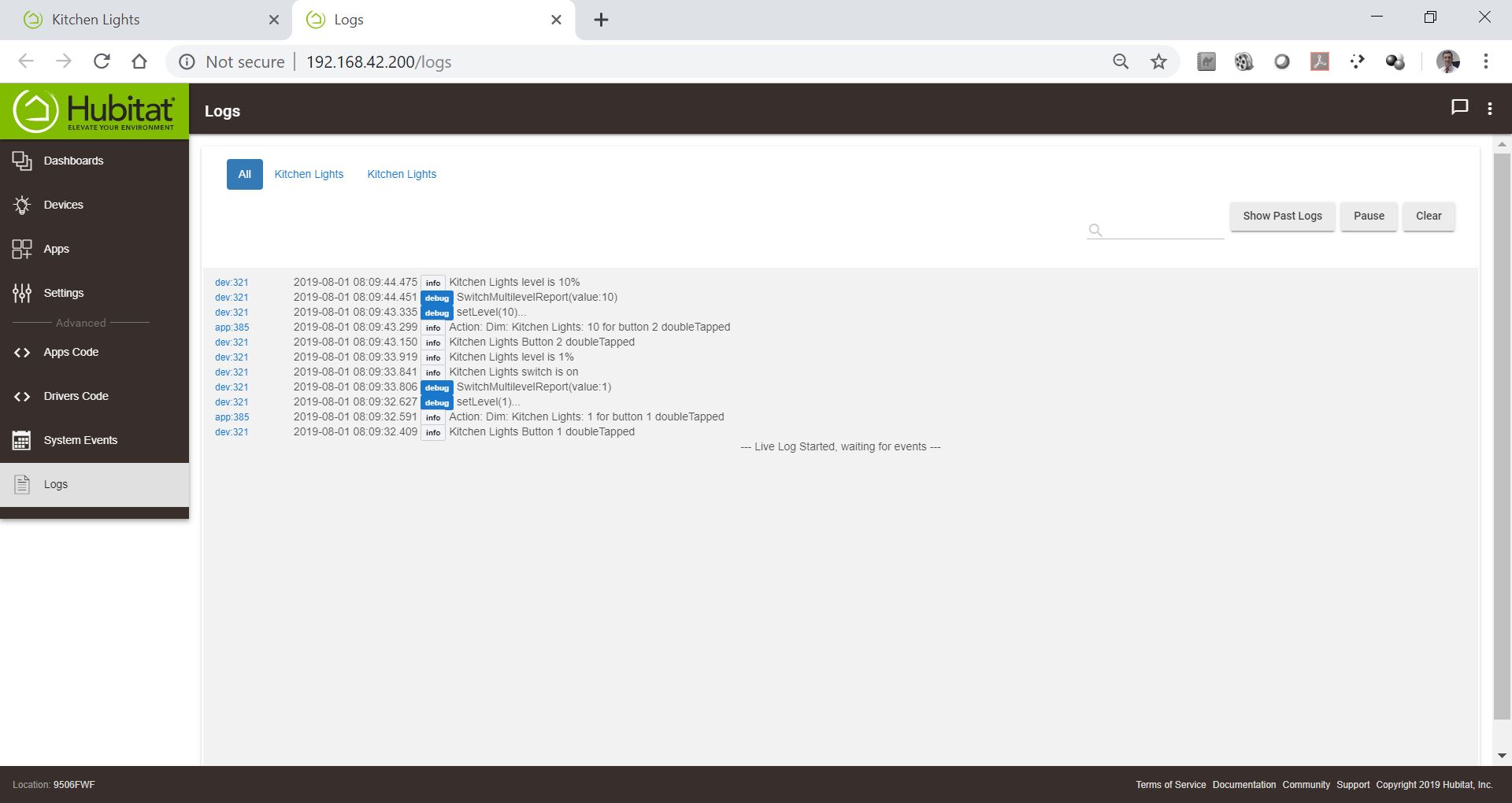

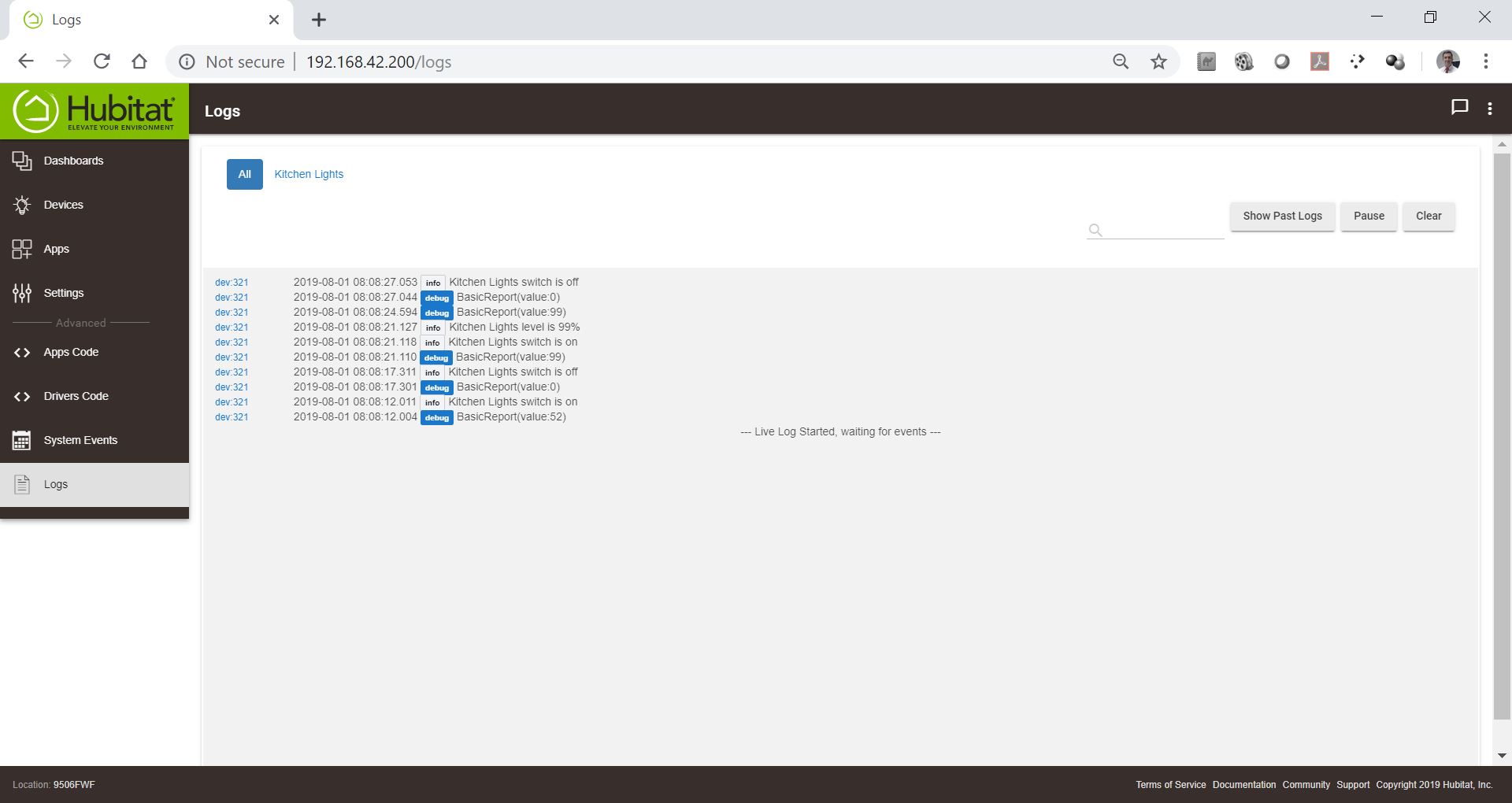

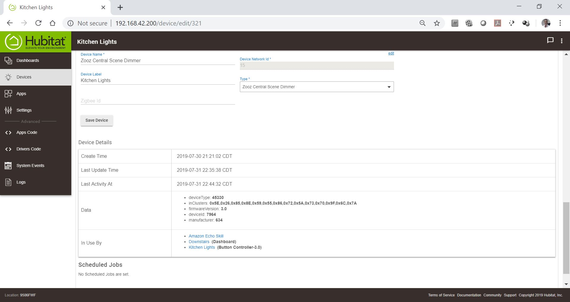

In any case. I'm running into a problem. Although the switch is setup as a "Zooz Central Scene Dimmer" on the device page, watching the logs does not show single or double presses. I only see "switch is on" or "switch is off". Currently a double press, either up or down, will set the lights to 99% and report again that "switch is on".
My sense is that I need to change a parameter on the switch to send the button presses to Hubitat instead of just reporting changes in state. My hope is that I can arrange this while still preserving the switches ability to take action on single-presses without the hub. One thing I like about hardwired switches instead of smart bulbs is that they continue to work even if the hub goes haywire or becomes unresponsive.

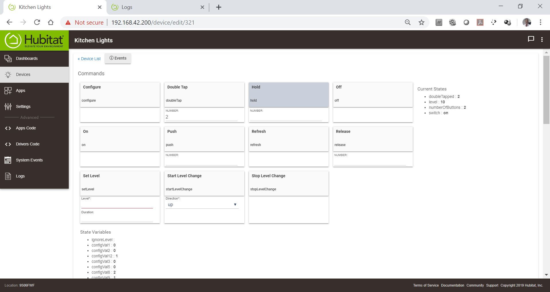

Screenshots attached showing configuration and logs. Also a screenshot showing what happens in the logs if I send a "double tap" from the device page (I have placeholder button controllers setup for double tap events so I can see that they are taking actions).

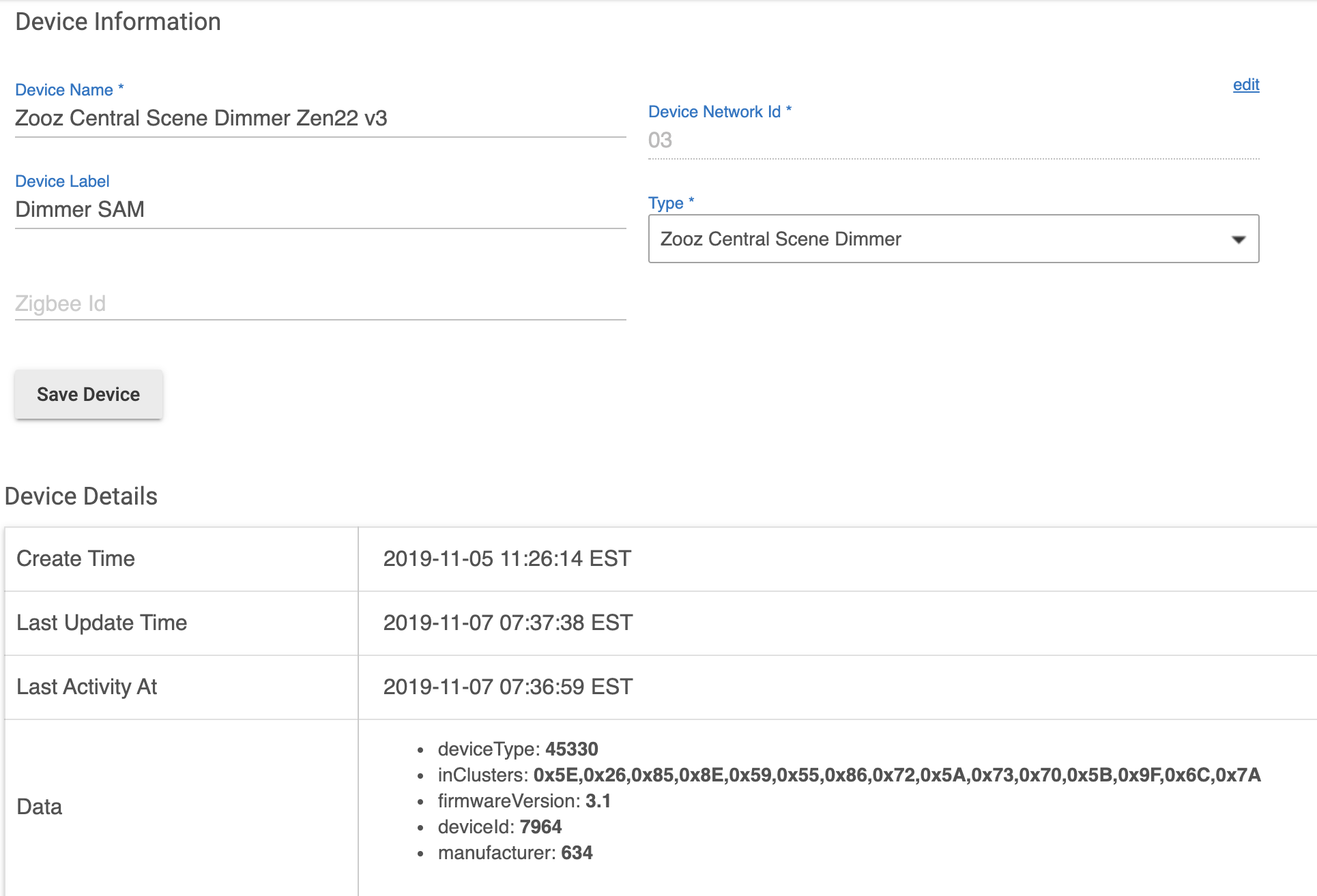

You need to have Firmware release 3.01 for the Zen22 to support Scenes.
http://www.support.getzooz.com/kb/article/297-zen22-dimmer-change-log/
You may need to flash the firmware.

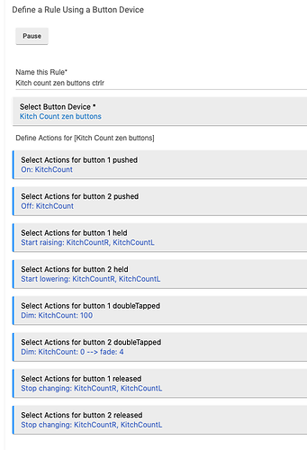

How do you assign scene to multiple taps? What would be a typical rule?

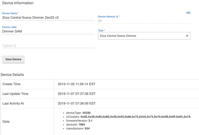

I have the most recent Zen22 v3:
Here is how I use it in RM.
