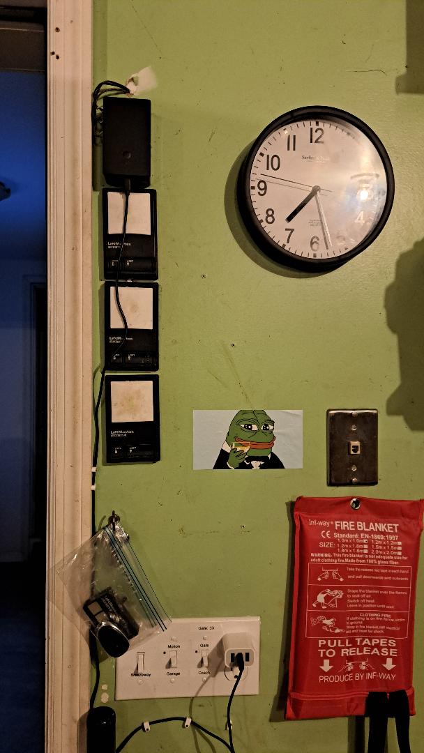

What's nice is that the 3 relays of the ZEN16 work well with my three garage doors.
Older door opener, so easier to hook up.
There's also a wireless keypad on the outside of the garage.
Everything works as it did before if Hubitat goes down.
