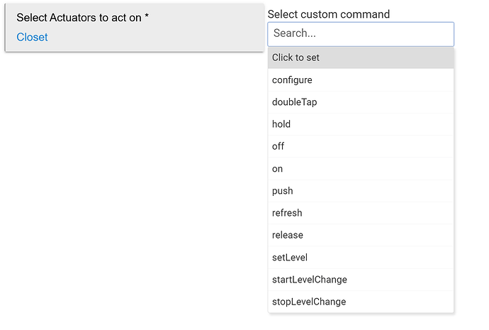

I'm replacing a separate switch and motion sensor with a single ZEN12. There is configurable parameters in the driver I don't seem to see when using RM.
I need to disable the motion activation at night for the light (don't want it coming on at night) ...so I can trigger turning off something else from that motion when the mode is "sleeping." The device and driver do this...IE After I turn off the "motion activate" the motion sensor still reports motion...but I don't see that option in the pull down for it when I try to run a custom action?

Have you tried looking under custom attribute?
I'm selecting run custom action if that's what you mean. I may not be following. There may be something I can send with the configure command...but I'm finding nothing so far on what that could be.Also, on the driver itself...there are no configure command blanks for parameters. It doesn't matter what device type I pick as long as it's close...It's usually easy to find zwave commands...though Google has not been my friend yet on this one....but even that really isn't going to do what I want...since you need to load the basic zwave tool for that...not the zen12 driver. I need something I can change in a rule. I don't think I've ever had field that was tweekable on the driver...not available in those pulldowns...but maybe I just never needed one that wasn't...When I search for community drivers...I also don't see the zen12 supported yet...and there is no previous model driver to use. BTWw...I "could" just not have the motion sensor control the light and do that in a rule...but one of the main reasons I went to this was the reaction time of having a motion sensor directly part of the switch...vs the second or two delay of triggering, sending tho the hub, triggering the rule and responding with an action.
If it is a setting on the driver preferences, that might not be available to RM. If it is on the main commands page, then it should be available.
Ah...well that explains it...but it's a shame that functionality isn't there...maybe someone will write a custom driver.
