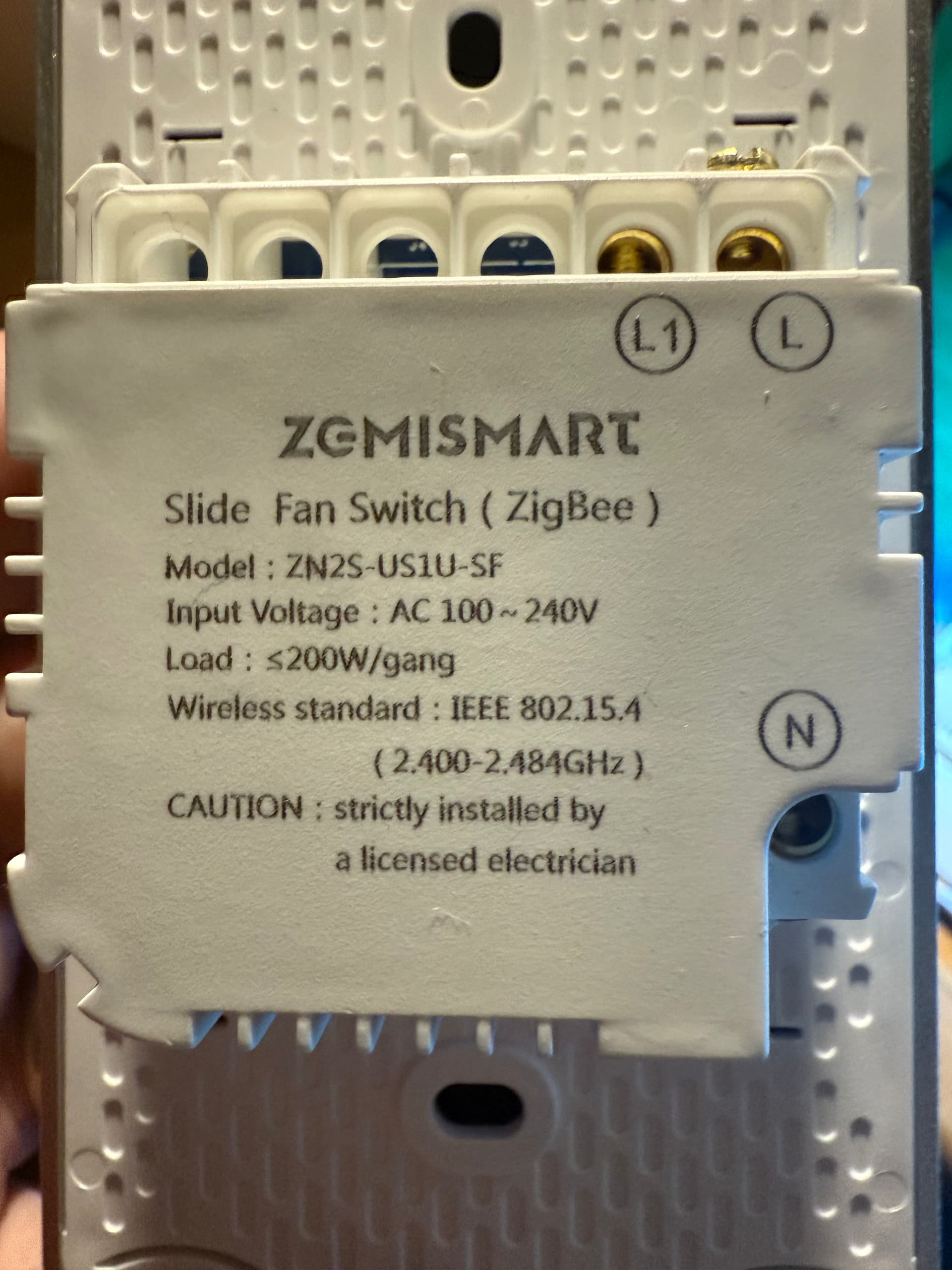

Bought one these Zemismart Touch Fan controllers from Aliexpress. It pairs almost immediately with Hubitat but shows only as a "Device". I've tried all the Zemismart custom drivers I can find, and also Moes and Tuya dimmer drivers. Best I can get is the controller to turn on and off. no control or speed indications.
I even tried pairing it with Home Assistant. It shows up as a device with no entities. Are there any slide dimmers/fan controllers that may be similar to this one or should I dig out my old Tuya Zigbee hub?

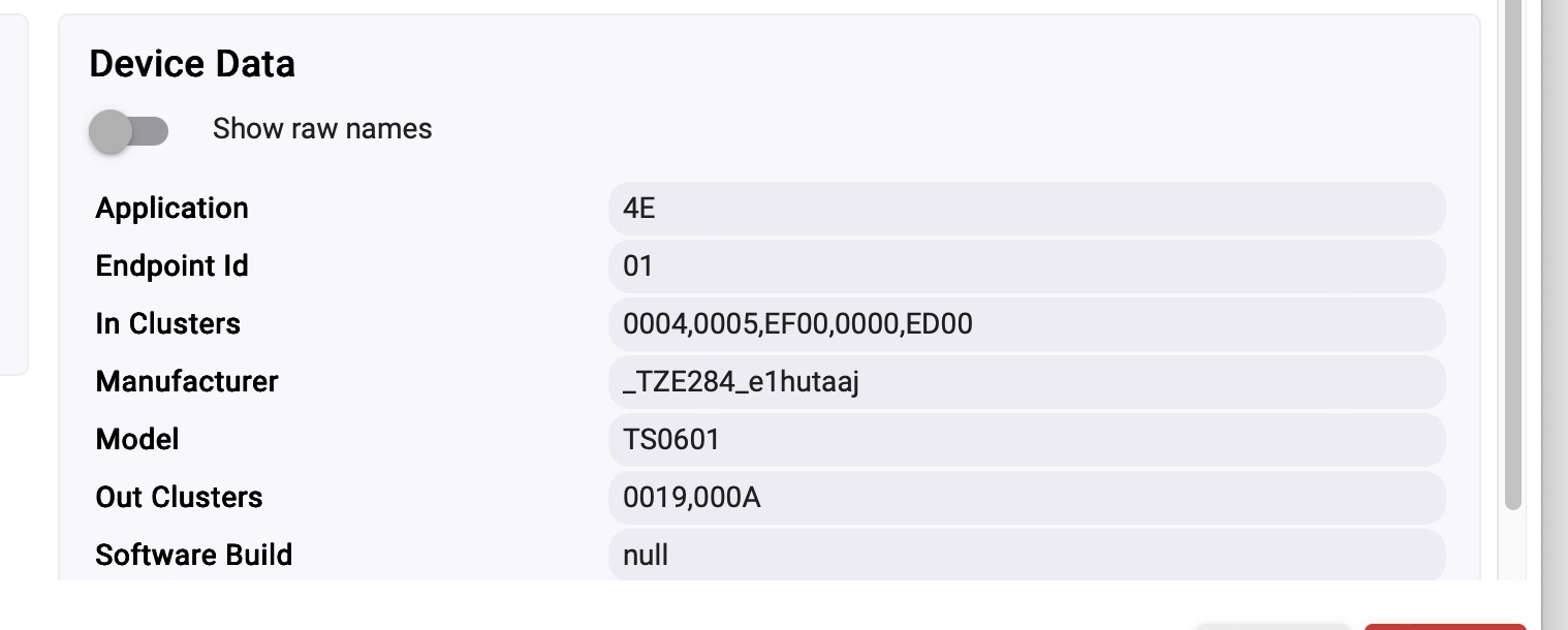

Yep, this is a new device and it is not supported even in HA, but I have found some info for a convertor of a very similar device here.
It partially matches one of the existing device profiles in this driver :
Enable the 'Advanced Options' in the Preferences tab and select the Device Profile to be ''TS0601 Fan Switch'
Then, pair the device again to your hub (withour deleting it).

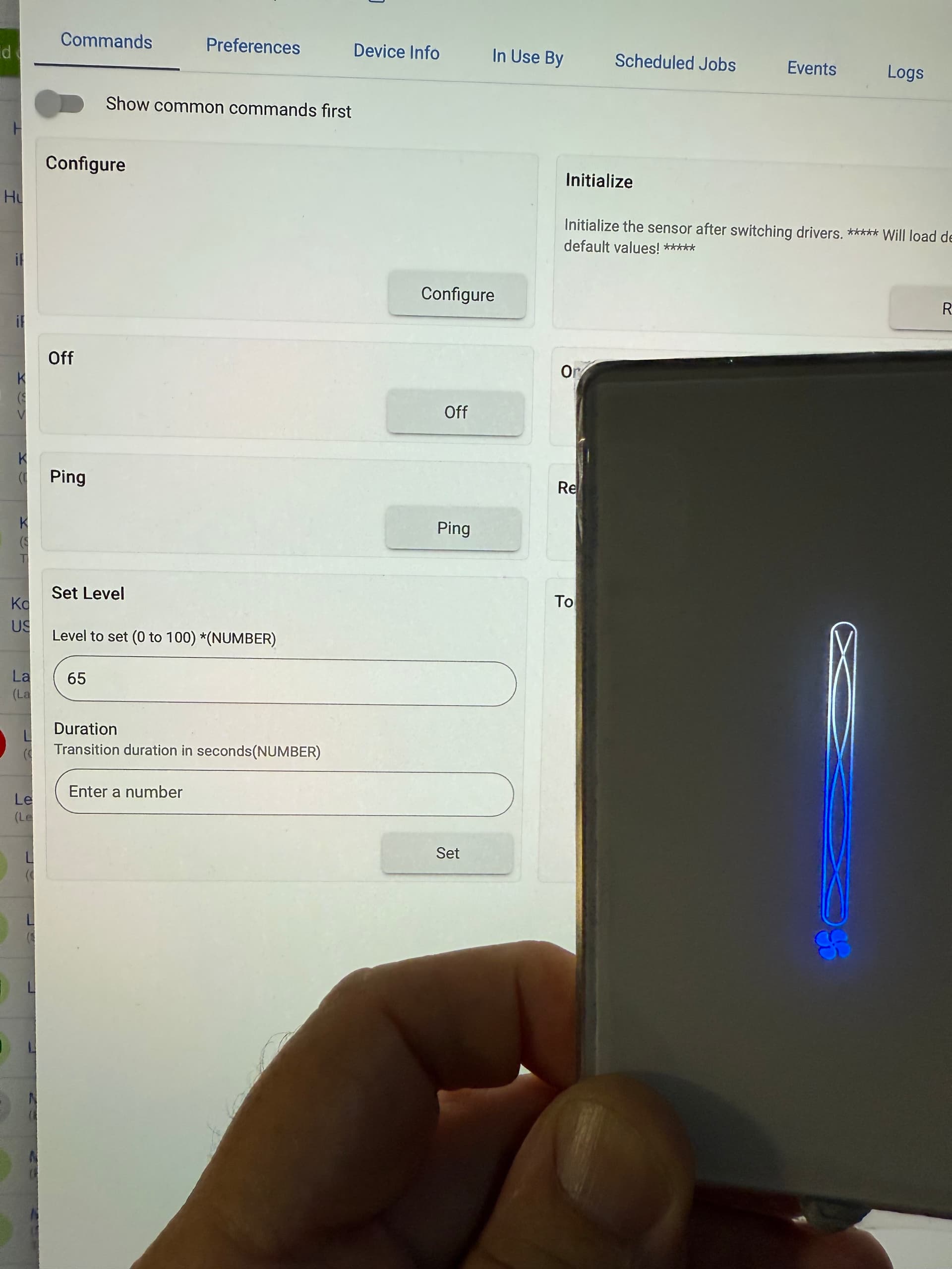

Thank you! By using the driver and method you suggested the device works perfectly.The on/off switching works. I can set any level from 0 to 100 and the switch responds accordingly. When I use the physical switch slider the driver level state follows. I had tried this driver before but didn't see the advanced options preference. Thanks again.
