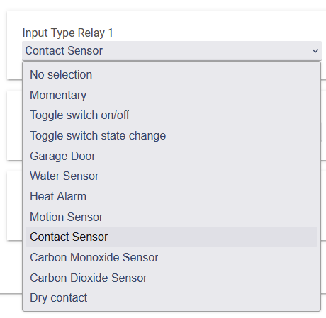

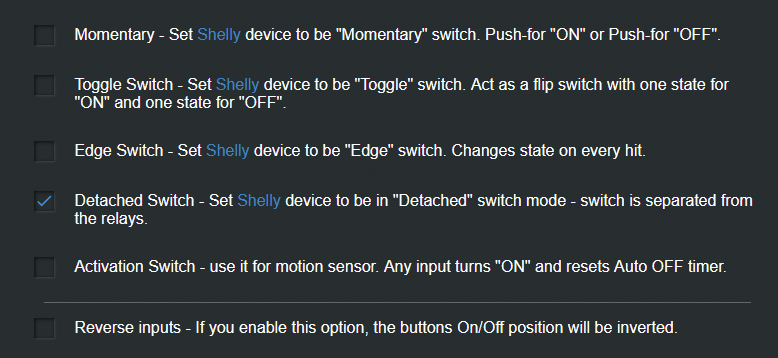

Shelly Relays and Zen16/17 are sophisticated enough to do what I think you are asking and report the status of the relay and switch inputs separately, and in fact are configurable in how those switch inputs function.
Here's a shelly I have setup for garage door use:
"Edge" is basically how the ZBMINI functions (unless it misses one because you are fast).
And Zen17 input choices:
