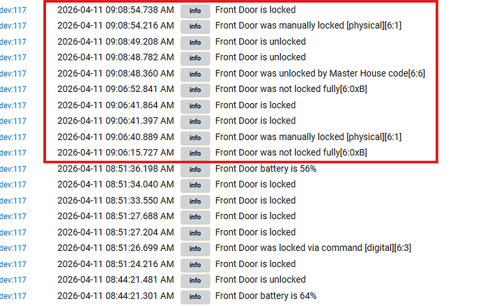

Z wave Yale Assure Lock 2 touch - not fully locked status incorrect
Platform version 2.4.4.146 with C-8 Pro- zwave JS. Might be a lock issue and non hubitat problem. Using generic zwave lock driver
I have 2 rules that work great for me...When I leave my set up geofence and the front door contact sensor is closed, initiates lock, message sent to my phone. Works great. Opposite for when I enter geofence, door unlocks if its locked and the door is shut. Also works great.
Problem is if the lock rule runs, then my wife leaves the house later. She manually unlocks the door, then hits the lock button on the keypad outside. The yale lock shows red (error), she has to key in the code to unlock it, then push the lock button again. Logs below show the history. Seems like a manual unlock post the rule running makes the lock think its not in a fully locked state, but also not unlocked. Commands from the hub, along with status on manual lock/unlock all register correctly with Hubitat.
Anyone have thoughts? Or had similar experience? Was thinking as an option to just add her phone as a device then update the rules to fire when both of us are out of the geofence.
Disregard. When locked via the hub, there was a 1/16 of the deadbolt still exposed when manually unlocking after. Just fixed it and works perfectly.
