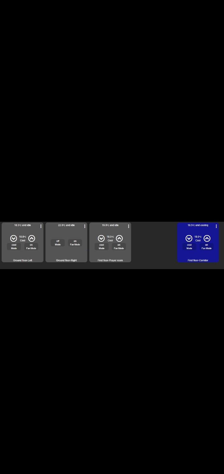

I have 4 z wave thermostat connected with hubitat. But in hubitat dashboard only two thermostat showing set temperature display, other two not showing set temperature display its only mode and fan speed.

  • Screen shots of the four dashboard tiles of the thermostats

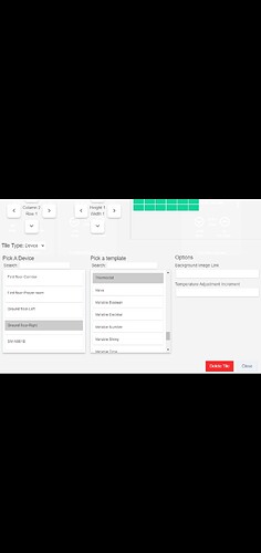

Are you using the same driver ("Type" on the device page) all the thermostats?
Have you made sure you've selected thermostat as the device type on all the tiles?
Now only one have problem.
What do these look like in your PC browser?

What change did you make that fixed two of the three thermostat tiles?
You can try deleting the thermostat tile that isn't working from the dashboard, and then add it again.
I tried but it's not working.
No idea, then. If it's the same device, and you're using the same driver, then it should behave the same way on the Dashboard app. Very odd...
