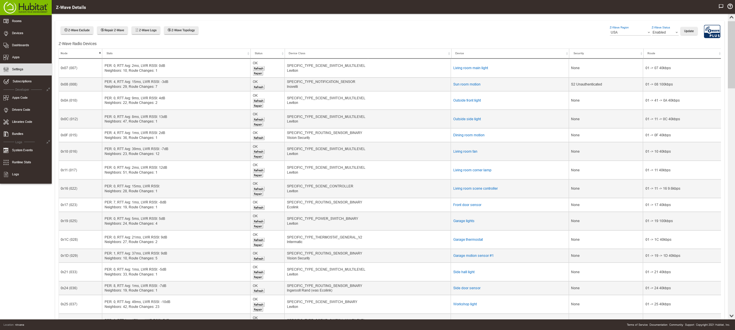

@gta Start with the basics. Do you have any ghosts? Do you have any zen15 outlets or zooz 4-in-1 sensors? How much of your stuff is paired using s0? If the answer is any of the above, address those first. Next. download your latest backup (use the "Create backup and download locally" button) Save backup to someplace on your computer. Next do a soft reset and use the database you downloaded to you pc to restore. This will ensure your database is not corrupt. Go from there. Also post a copy of you z-wave settings page for us

No ghosts that I can see - I have a UZB3 and have gone through that process in the past - also used to force several devices to pair with no security rather than S0.
On the same front, no S0 devices - everything has security "none", apart from a couple of multisensors (inovelli and aeon), and the UZB3, which are S2 unauthenticated.
I have also restarted the hub several times, including one where the power was removed (to allow complete restart of the zwave radio).
I don't see any way to create a screenshot of the entire zwave page when it extends over multiple screens... the best I can think to do here is set the font size ridiculously small so that as much as possible is visible (this is still less than half of it).
