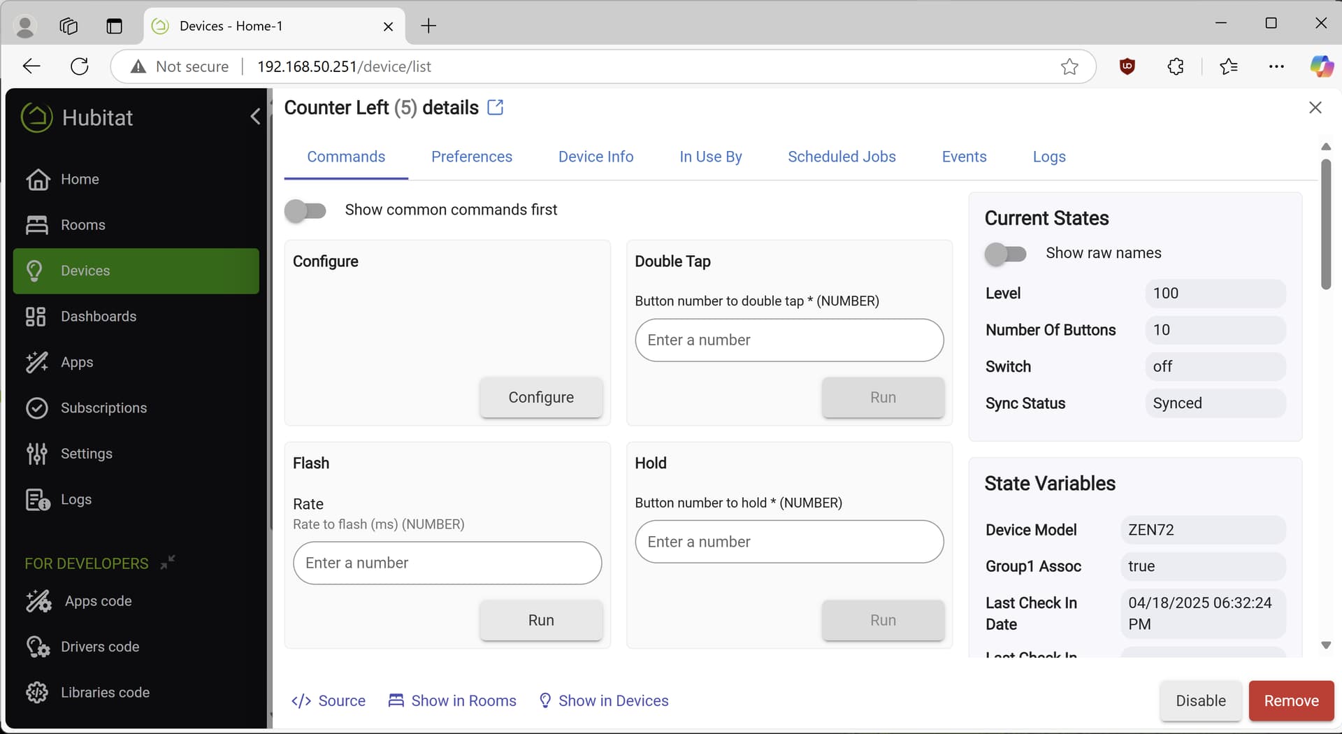

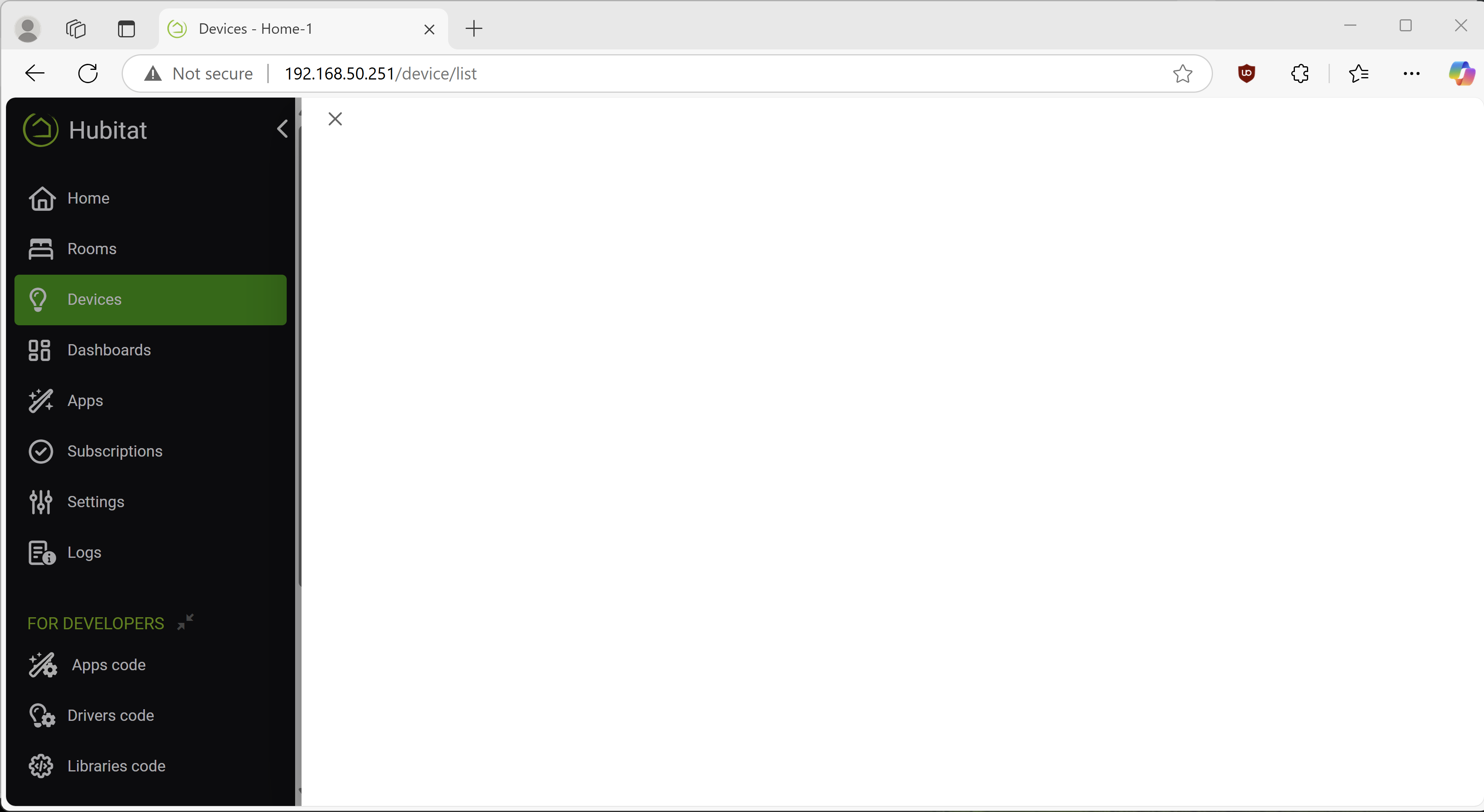

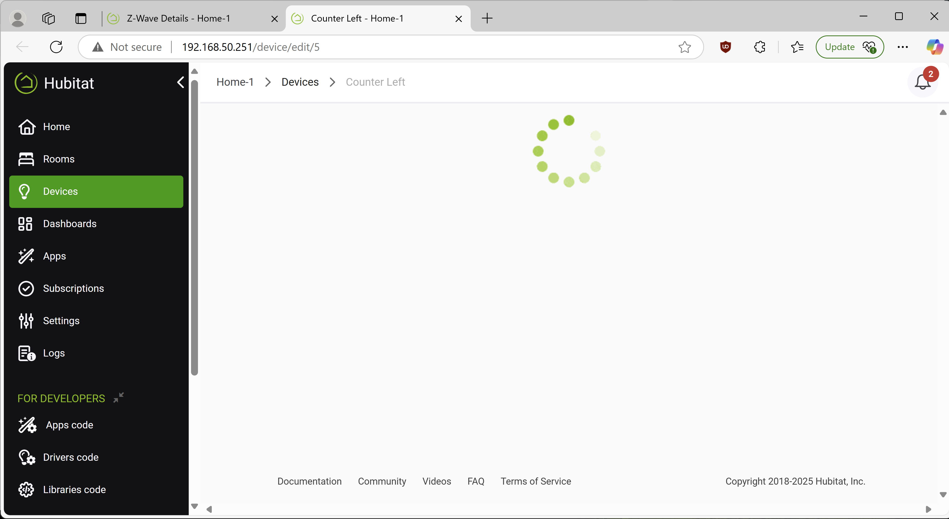

When your hub is up, after a reboot, please take a screenshot of an example of the page that later will not populate, and post it here.
When this happens, the page not populating, are you able to navigate to other hub UI pages?
Thanks for the response late in the day. Yes, I can navigate to any other pages on the hub.
Here is one of the Device details pages after a reboot:
Here is the same page after it won't populate coming from the Devices page:
Same page coming by clicking on the Device name from the Z-Wave details page when it won't populate:
