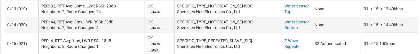

I need to place two water sensors on the rooftop water tank. The total distance between the Hub and the sensor was 40 feet approx. As many walls and beams are along the way, the water sensor is not getting signals properly.
So I added a Z-Wave repeater on the 1st floor, so the distance between the water sensor and the hub was reduced. So now the sensor is able to work till 30 feet.
Now I need to increase the range, and so I can place the sensor inside the tank which is at 40 feet. As I read, Z-Wave range can be increased when we place other Z-Wave devices near by. I have added two more Z-Wave PIR sensor along the way
Hub -> Repeater -> PIR Sensor -> PIR Sensor -> Water Sensor
But in the route, I see the route to the water sensor only from the repeater and not from the PIR sensors.
All the product brands are Neo CoolCam. Any idea how to change their route?
All the routes of the devices I have mentioned
A Z-Wave device needs to be mains powered in order to function as a repeater; battery operated sensors won't repeat for other devices in the mesh.
You'd need to add another mains powered device in the path in order to increase the range.
