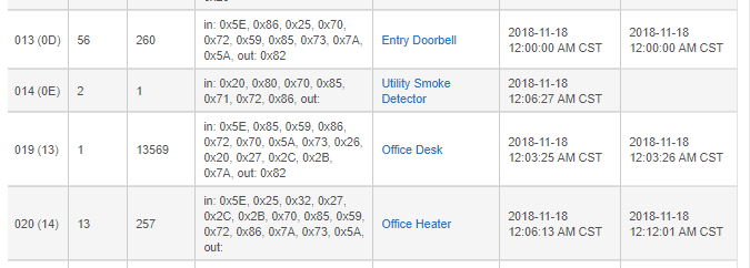

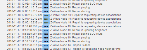

I have a device that reports several "requesting device associations" however, it does not report "repair is done." this after reboot of the hub and the 2nd repair attempt.
What device is Office Desk? Did you tried to make it active before the repair? I notice the same behavior on some of my devices, then I make them active and the repair did correctly.
It is a Leviton dimmer module model DZPD3-2BW. It is the closest AC powered z-wave device to my hub. It originally joined in secure mode and I excluded it and re-included it after updating to 1.1.7.
