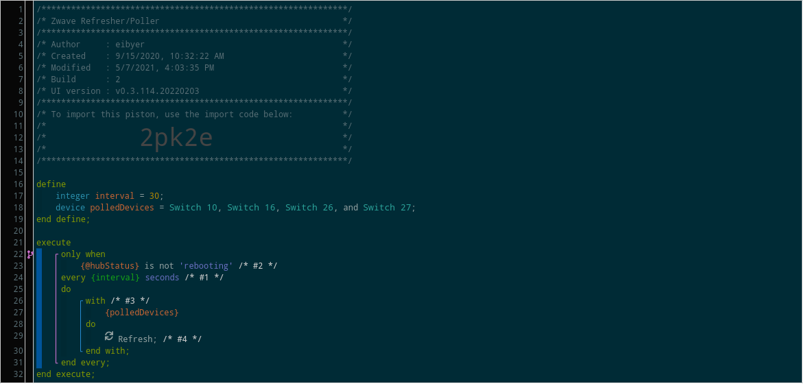

I am using webcore to poll 4 devices at 30 sec interval with no issues.

What did you use in webcore as trigger and how did you set the frequency. I have all my devices set to poll and it works fine. I know webcore fairly well from smartthings. Thanks
I just have it set on a timer...
This webcore piston is very good. Works perfectly.
