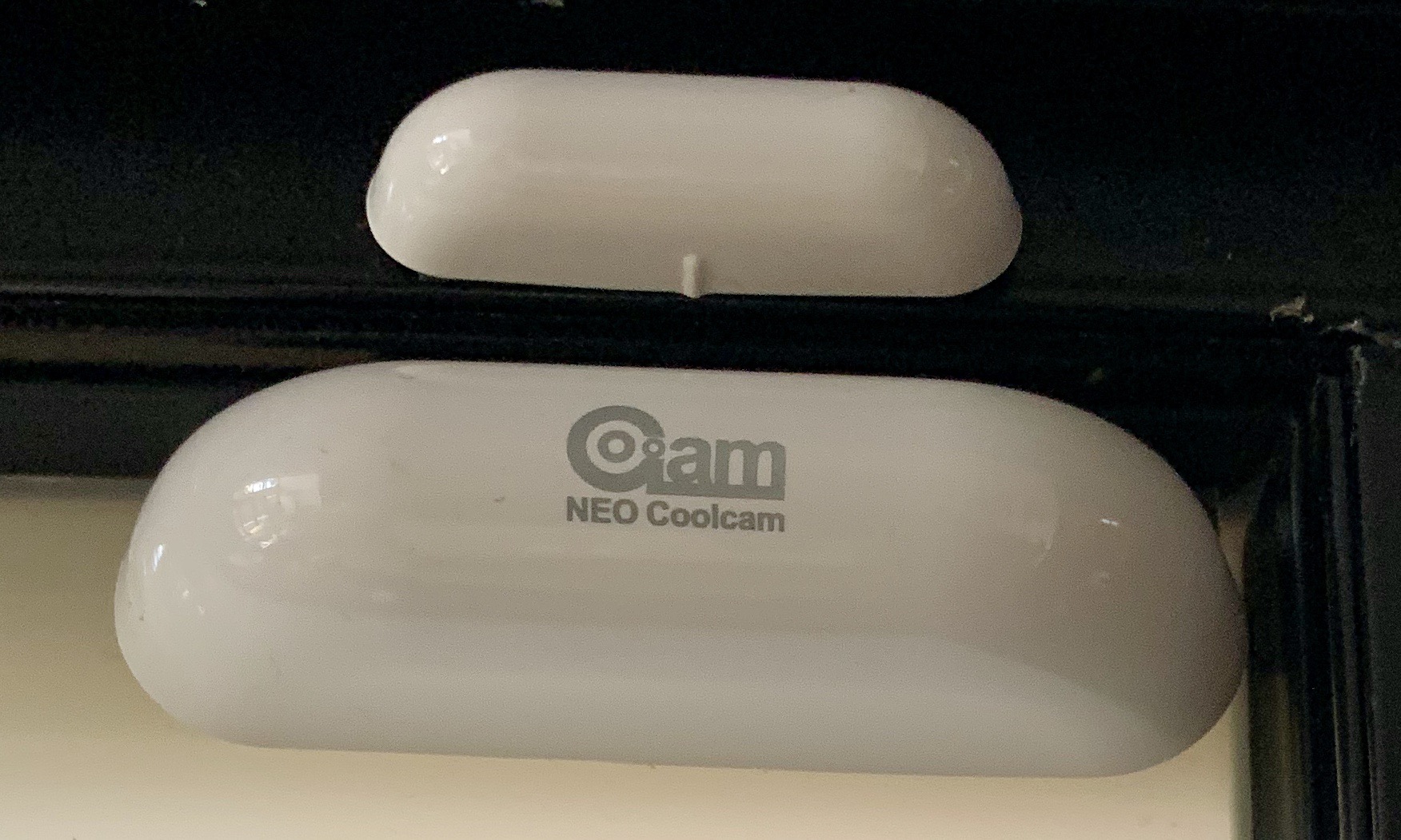

Would it happen to be a sensor like this ....
This sensor of mine started doing VERY similar weird things and after much ado it turned out that it was battery related but I also had to do an exclude and then rediscover / rebuild all the Rules associated with it.
Bit of a pain but sounds worse than it actually was.
