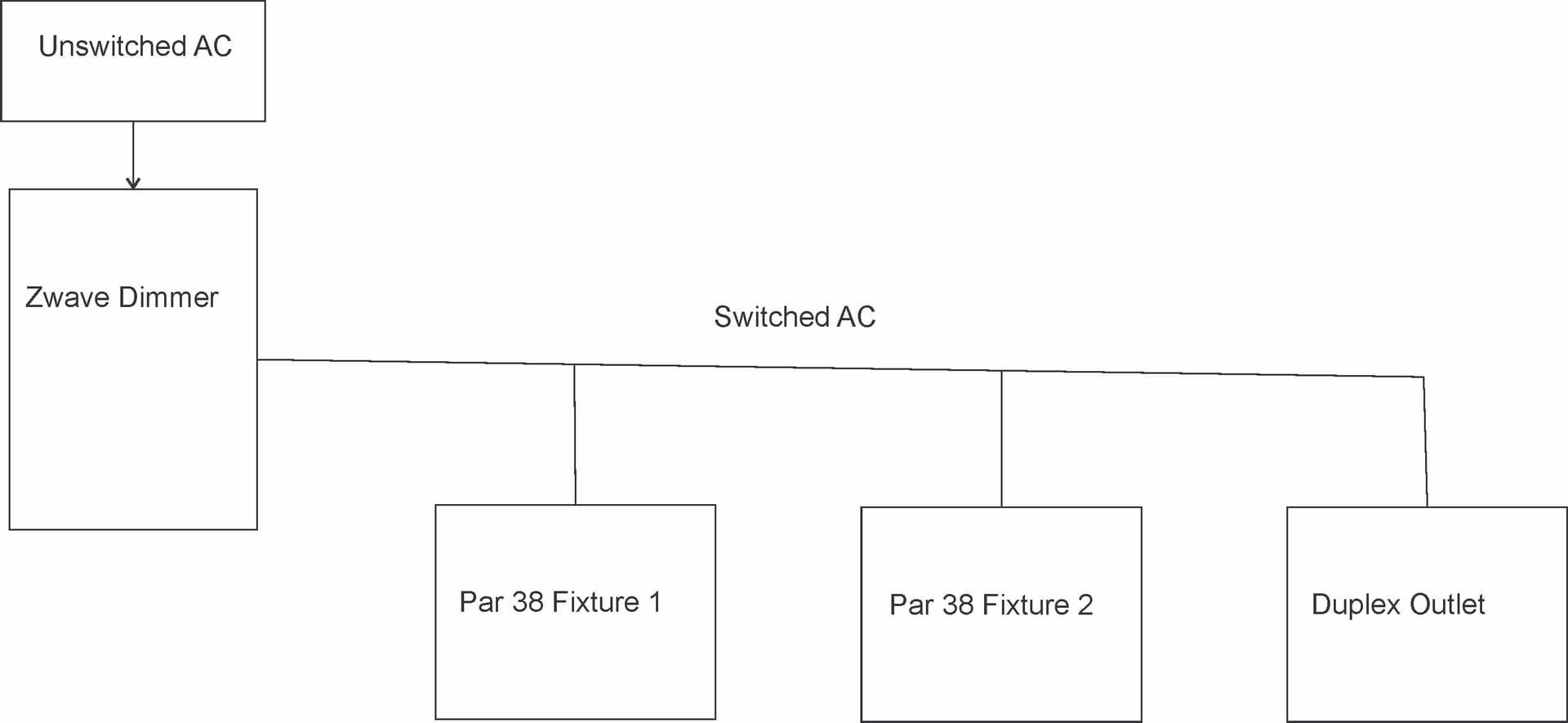

A diagram should help explain my original question.
  1. Dimming isn't required
  2. The duplex outlet will only be used for Christmas lighting
  3. Lumens from Fixture number 2 must be bright enough to illuminate xmas scene during daylight hours. It's in full shade.
  4. It's Ok for the duplex outlet to be "cold" unless Fixture 1 and Fixture 2 are on.
  5. Wife wants to make sure that nothing is "hacked", in the sense that zwave isn't required for things to work "like a normal house".
So, my original thought was to simply change the Duplex outlet to be zwave, but that might have issues as I noted and discussed in the posts.
But, I think I have a better idea. I think the existing zwave switch can be configured for "Physical Control disabled". That will make the switched AC always on. That should eliminate the issues with the duplex outlet being a zwave device.
If that the existing Zwave switch is replaced by a dumb switch, things will work as they do now, satisfying #5.
I found Par 38 zwave devices that I can use for Fixture 1 and Fixture 2. That would be the easiest, but they are only rated for 600 lumens. That's probably not enough illumination to satisfy #3, but there's only one way to know. I have a couple on order to try.
If the zwave, Par 38 isn't bright enough (only #2 has to be really bright), a zigbee device might be an option. I do see very high illumination zigbee, par 38 bulbs, but that would be the only zigbee device in the whole house and there might be an issue with the distance from the hub to the device (it's a recessed light in a can on the front porch).
I would add a rule so that a tap on the existing zwave switch would turn on fixture #1 (AC from the dimmer stays unswitched, fixture #1 turns itself off. This rule would be active only during Christmas season. When the lights come down and the scene goes away, I could reconfigure the switch for physical control, or just make fixture #1 and fixture #2 part of a group that toggles when the dimmer switch is toggles.
Any other ideas welcome, or especially a zwave par 38 fixture or bulb that is very bright.

The first things that stands out to me is an outlet powered by a dimmer switch. The outlet needs to be a constant 120VAC. Regardless if its smart or not.
Yes, that's why physical control at the dimmer switch will be disabled during Christmas season. That will make the line labelled "switched AC" always on.
And the outlet will only be used during Xmas season. It's only accessible by removing some plastic panels in the porch ceiling.
That was my original idea, but having the switch bypassed in the box would be a bit "hacky", IMWHO (in my wife's humble opinion). But, I think I can accomplish the same thing by disabling physical control.
The main issue with dimmers (dumb and smart) in such a situation is that even when fully on/up, most (all?) do not actually pass full 100% load power downstream. Some better than others, but that missing bit can be enough to really mess with downstream loads that are expecting/need 100% load power.
I hear you--
I'm going to give a try though. Hopefully the devices are tolerant enough to AC mains "noise" that it will work.
If not I'll have to actually wire around the switch in the box and use a plate with one side blank--wife hates that idea.
