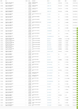

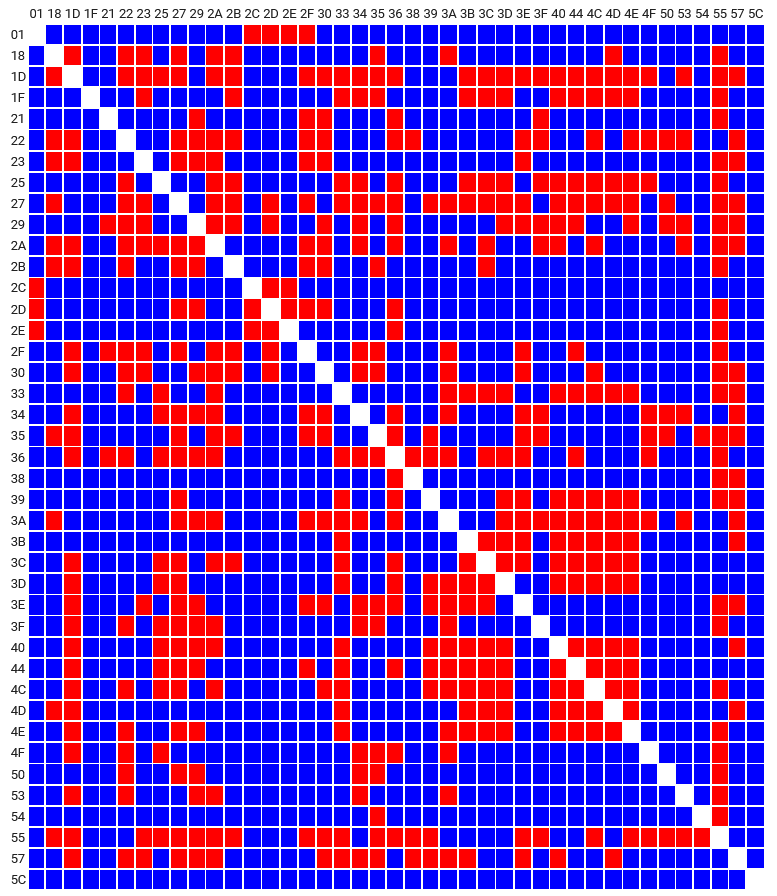

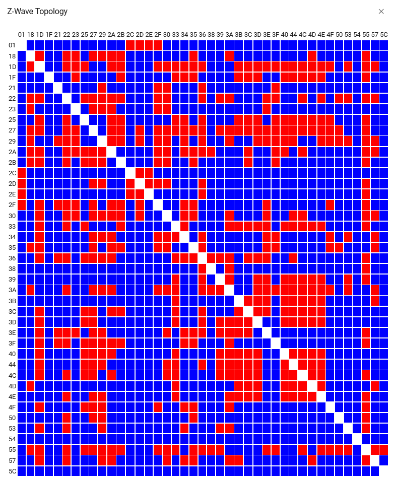

I started with a C7 and have migrated to a C8Pro. I have always had spotty Z-Wave. Sometimes things work fine and I get quick responses. Other times things are very slow (more than a min for a device to respond to a command from the device page on the hub). I feel like I have a great spread of wired devices (almost all Zooz) in plastic electrical boxes so my mesh should be good. I have replaced a chatty T-stat and stopped using thermostat controller because of the volume of traffic that was adding (see my other posts about that) to see if any of that would help.
@jtp10181
C8 Pro

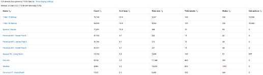

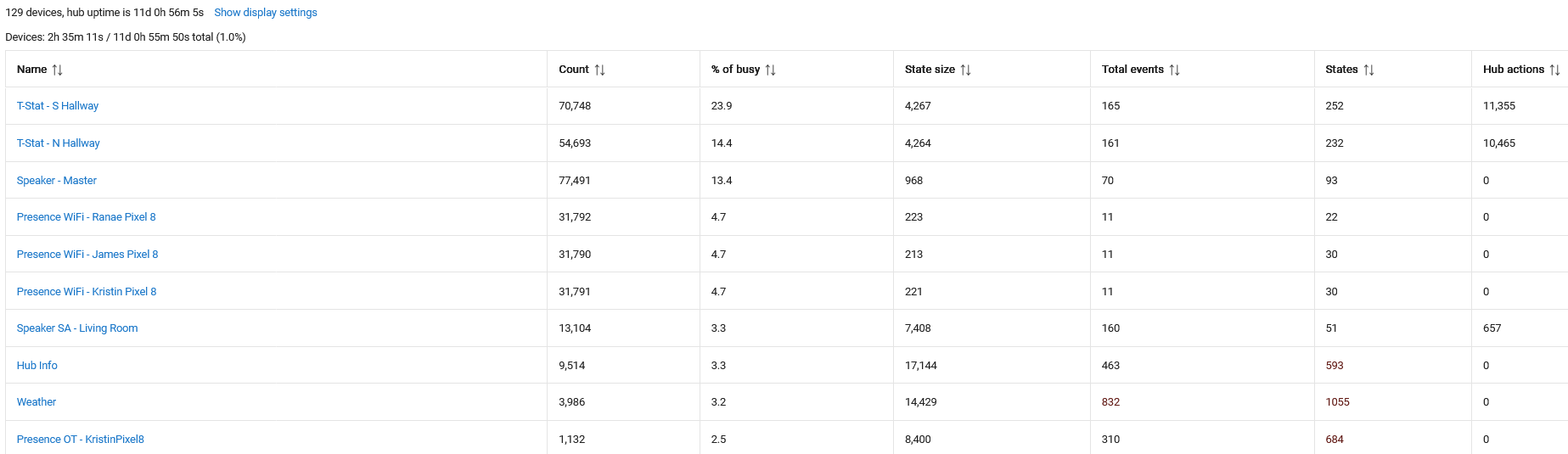

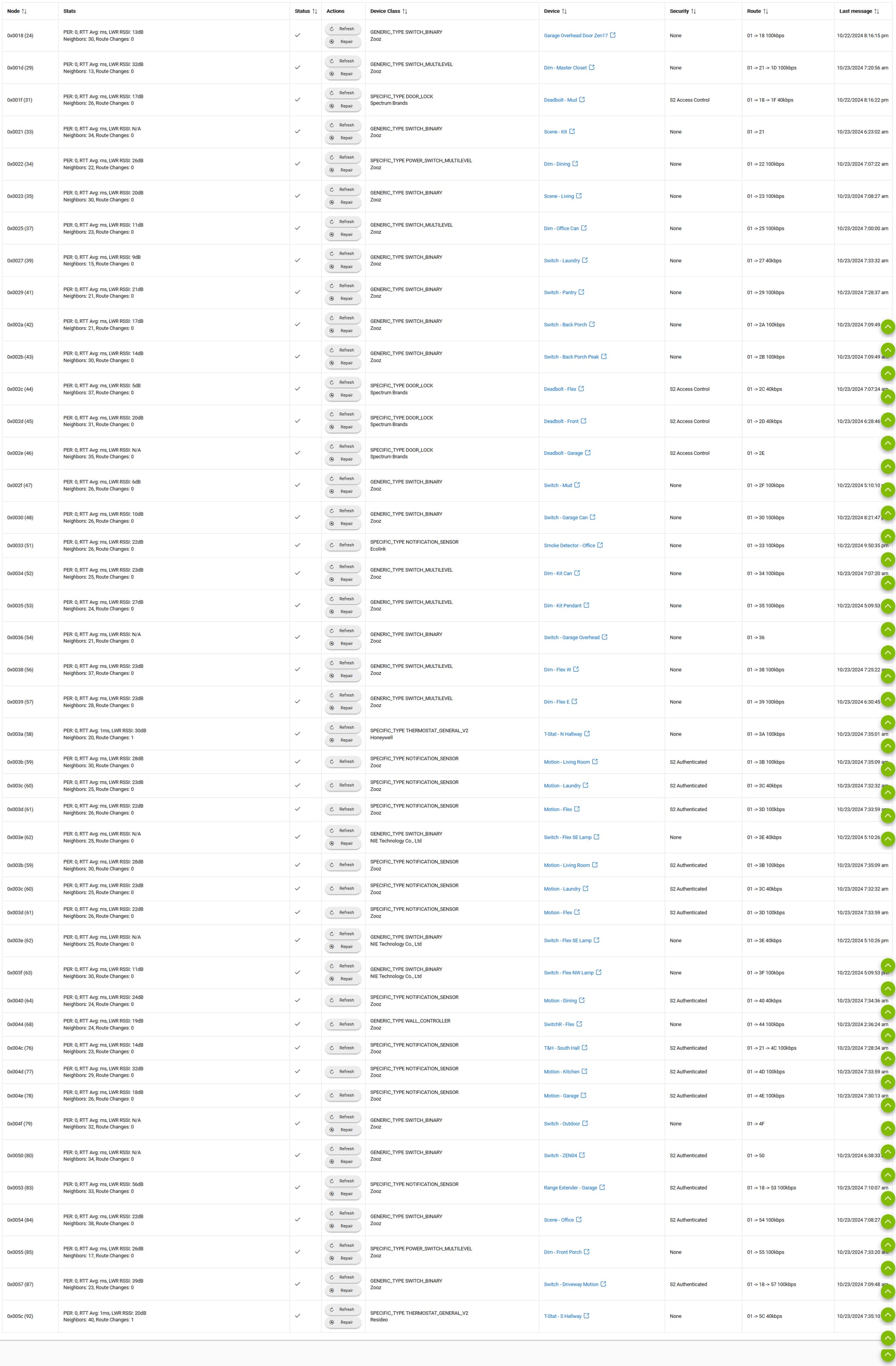

Just a quick glance and wow thats a lot of route changes.
How long was hub running since last reboot at this point? If you have Hub Info driver the uptime is on there.
Uptime shows on the device stats. 11 days

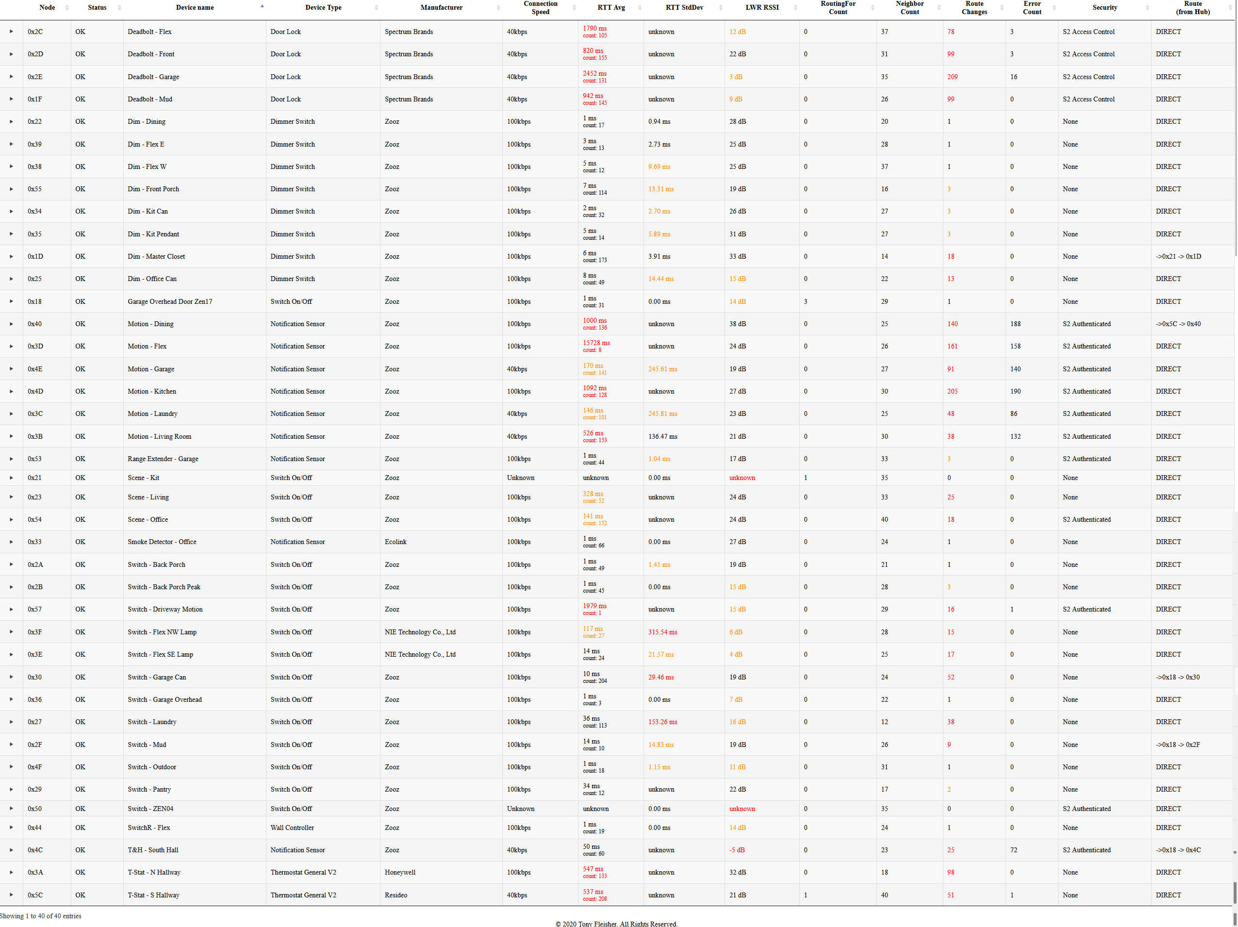

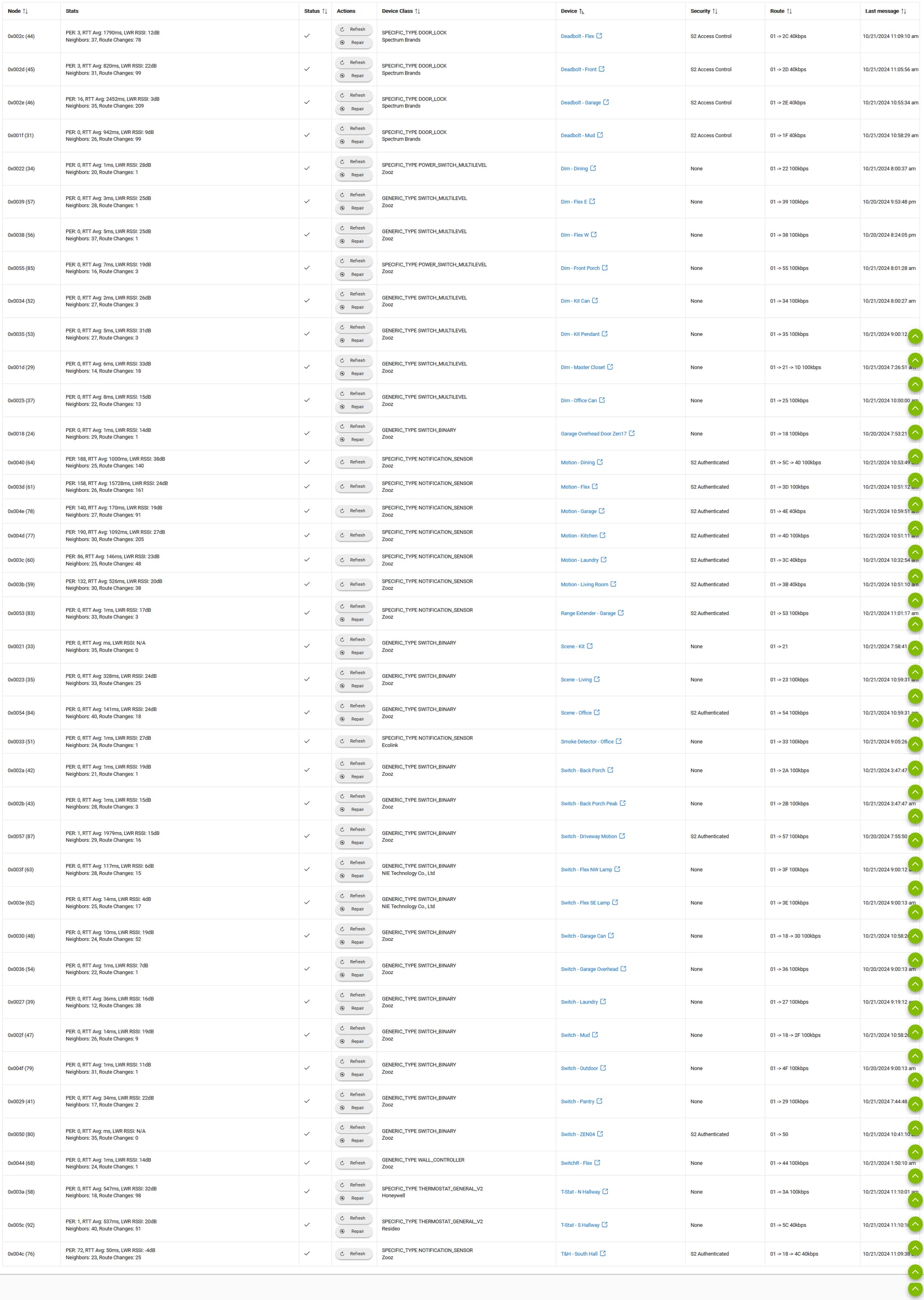

My musings:
  • There's an awful lot of route changes on some of those devices, but I guess that depends on how long the hub has been up to accumulate that number.
  • Also some low RSSI readings, is the hub well placed centrally or are they just distant devices?
  • Is there a reason for using S2 Authenticated inclusion on the motion sensors as the usual advice is include without security except for locks, alarms and garage doors etc? I'm not sure how much impact that will cause but imagine there'll be a lot more traffic.

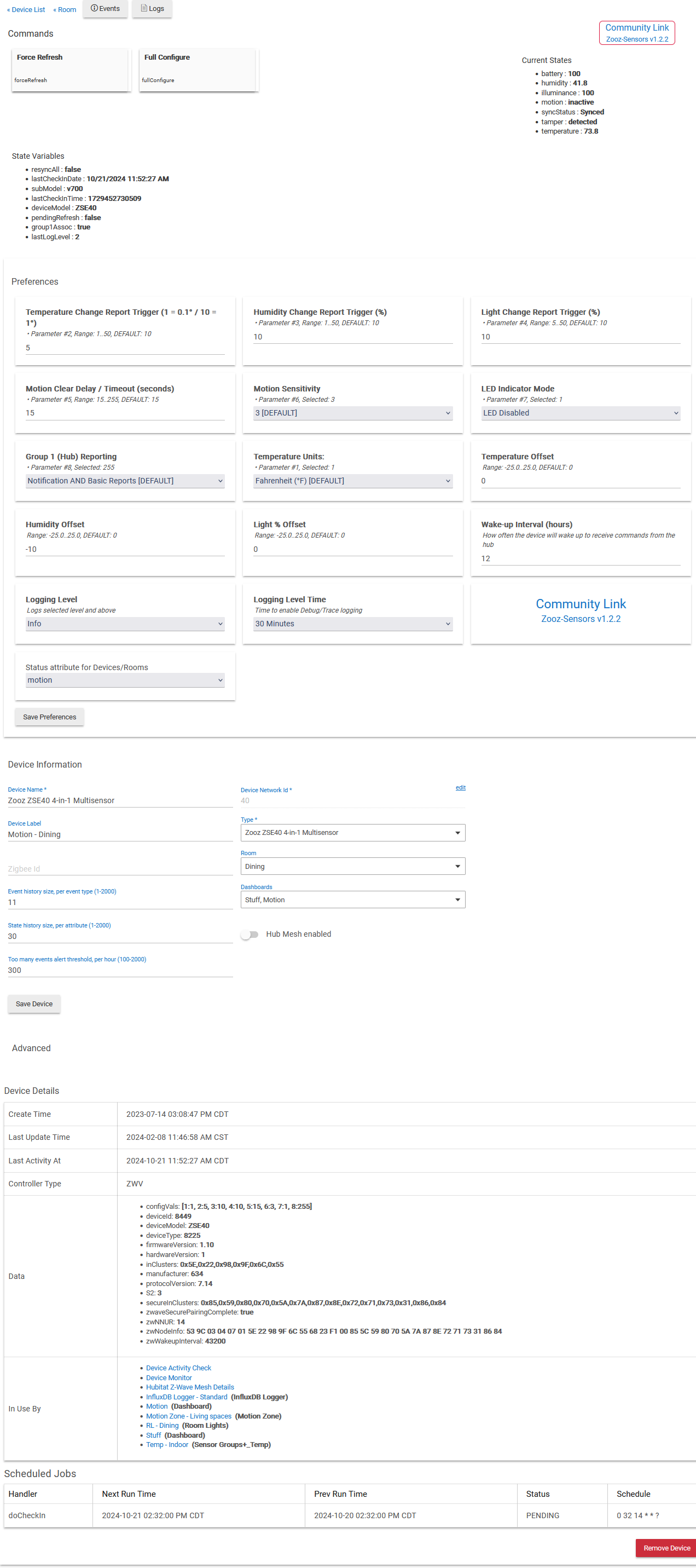

Can you post an example of your settings, and the firmware version.
@johnwill1 I have my ZSE40 paired with S2 in a high traffic area and have no issues with it.
The hub is on top of a bookshelf (9 ft up) towards the front of the house. Affected devices are both close and far away.
Motion sensors are S2 on a recommendation here (I think from Jeff maybe??) because of sometimes reporting crazy temps when not on S2.
Yes they are the ZSE40 using your driver:
If you dont need the temp to within 0.5 deg I would bump that to 10, If you are not using the lux to a fine degree, I would bump that to at least 25. Motion clear delay could be bumped to 30 unless you find it impacts your automations. Set the Group 1 reporting to Notifications Only (this cuts messages in half).
Your locks seem to have a high message count. Do you have a lot of automations relating to the locks that you are sending them a lot of commands?
More reliable is better than more granular data so I will make those changes on the ZSE40s.

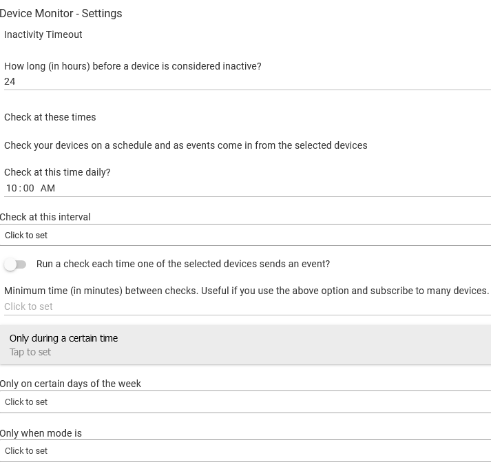

What is the Device Monitor app doing? Is it possibly sending a lot of refresh commands?
Maybe turn on debug logging for the Garage lock, then go to Logs > Scheduled Jobs and find the "LogsOff" schedule for that device and delete it. This way debug logging will stay on.
Lets see what turns on up there, we will see if the device is being very chatty for some reason.
ZSE40 settings are all updated and each one woken up and showing synced again.
Device Monitor is configured to check one time a day at 10AM

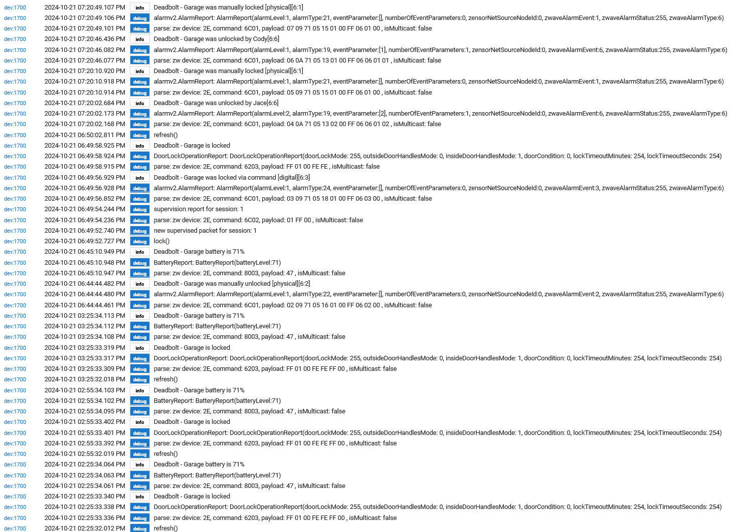

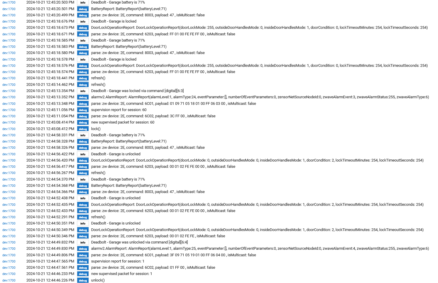

Deadbolt Garage is the least used deadbolt and the farthest lock from the hub. I have enabled debug logging and deleted the job to disable it. How long would you like me to wait before posting it? Here is just a simple unlock and lock using the device page:
I was just thinking to check it over a day and see if there is any unusual activity. Just doing some quick math based on about 3 messages per event, looks like around 4 activations per day which I guess is not unreasonable if the lock was used daily.
Every time the hub has to send a command to a lock it will send a first try, which usually fails, then it sends a FLIRS wake beam which will jam up the mesh for up to 60 seconds. The device will wake up then they can talk. This happens for each lock if you are commanding multiple at a time.

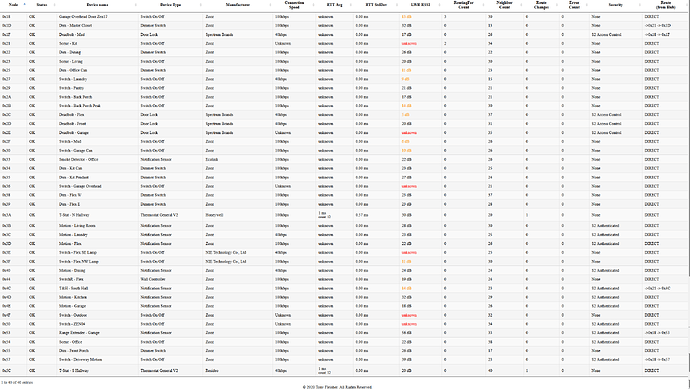

Sorry looking at the stats again, I am leaning more towards the ZSE40's causing the issues. Not only do they have a lot of route changes but also a lot of errors. The locks are normal to see route changes and yours do not have the errors like the motion sensors do.
The errors could be corrupted messages getting rejected do to the S2 error checking.

Lock does not look to crazy to me:

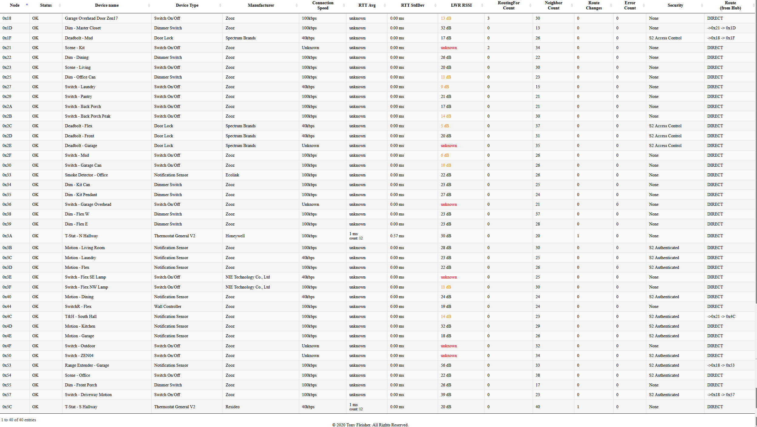

Should I power off and back on to reset the radio and logging so we can see if the error rates are changing?
Yeah not a bad idea. Can see if the changes to the ZSE40s has made a difference or not.
Lock does not look bad, nothing out of the ordinary based on your rules I assume. Just be aware with the locks every time you see a "refresh()" or "lock()" command in those logs the hub is probably sending the FLIRS beam which I explained above. But it should only have an impact for 30-90 seconds if the device responds.
16 hours of uptime here
The stats seem to be not very populated. Did you by chance use that endpoint recently that turns off the every 30 mins zwave stats job?
