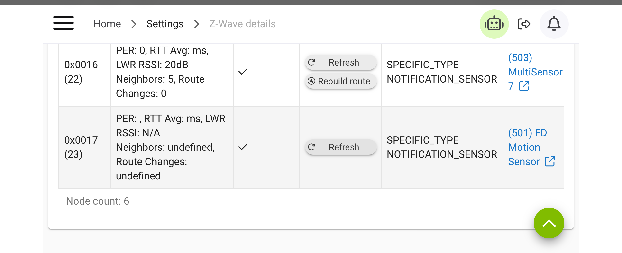

I recently added two new devices to my z-wave network. an Aeotec multisensor 7, and a Zooz ZSE70 indoor/outdoor motion sensor.
For the sake of this post, they’re both working fine (I have some frustrations with the multisensor 7s driver but that might be another post) and show up in my device list and poll and report everything I would expect them to. However, when I go to z-wave settings and view the graph, neither one of these are showing up. I’ve tried rebuilding the network. It just doesn’t do it. I haven’t been getting any error message or failure message. It just never really gets past the node mapping. I tried updating the firmware on my multisensor 7, using the firmware from Aeotec, in the Z wave settings firmware updater, that one too just never really went past one percent but never failed either.
Honestly, I don’t know what’s wrong or what I’ve done here. I’m assuming the next thing to do would be to exclude them both from the network and start over after a factory reset but I just don’t understand what went wrong in the first place. Anyway, if anybody has any helpful information or thoughts or advice, I would love it. Thanks.

On the Z-Wave Details page, does the node number for these two devices have a little "LR" beside it?
On the screenshot below, node 44 is a mesh device, node 100 is an LR device. Notice that node 100 doesn't have the "Rebuild route" option and has no neighbors - because it is an LR device that communicates directly with the hub.
Node 100 will not appear in either the device graph or the device topology, both of which are indicative of mesh health.
It is if you used SmartStart and the device supports it
ah ok, thank you. No none of mine have the LR there, but I had already removed the one that might be long range and did not have neighbors which was the zoo outdoor motion detector so that may explain it.

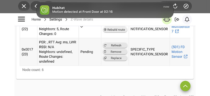

So I set it up again after excluding it and factory resetting it. I use Smart start scan the QR code and then add it and I enabled the s2 security.
What does this mean? It works perfectly but this doesn’t look like its set up properly.

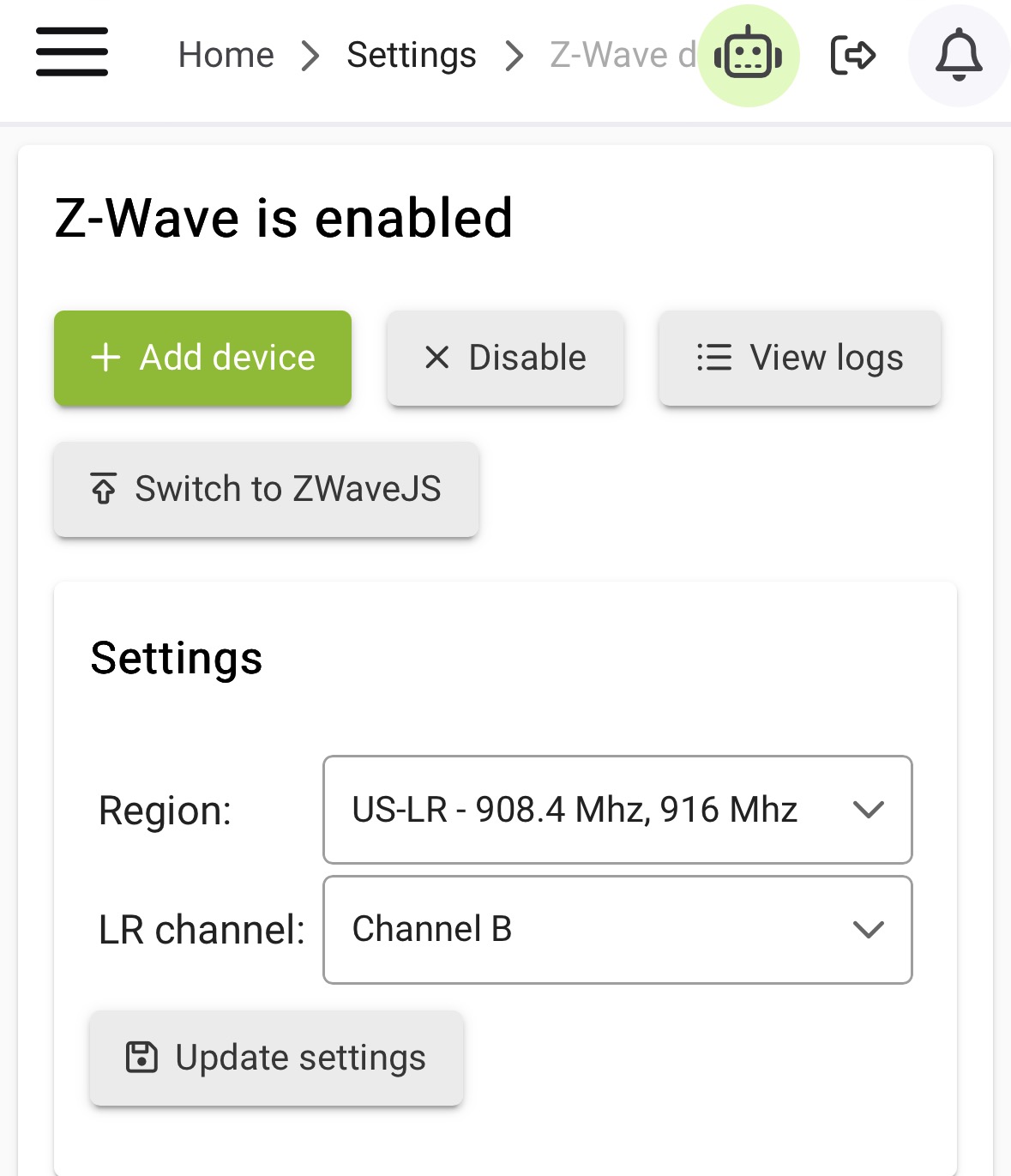

Is your hub using ZWaveJS or Z/IP?
Based on the below, I would assume the Z/IP.
Click "Refresh" and wake the sensor at the same time.
That’s the first thing I tried. No change.
Although after just leaving it alone for a while, it now appears this way. I can refresh it almost instantly, but it doesn’t offer rebuilding a route and it doesn’t say LR anywhere, although it is long range capable

Use the built-in z-wave firmware update tool. And I'd recommend using ZWaveJS over Z/IP.

This does make a difference… It’s completely different code as it uses the ZWave-JS native firmware tools when you are on ZWave-JS.
