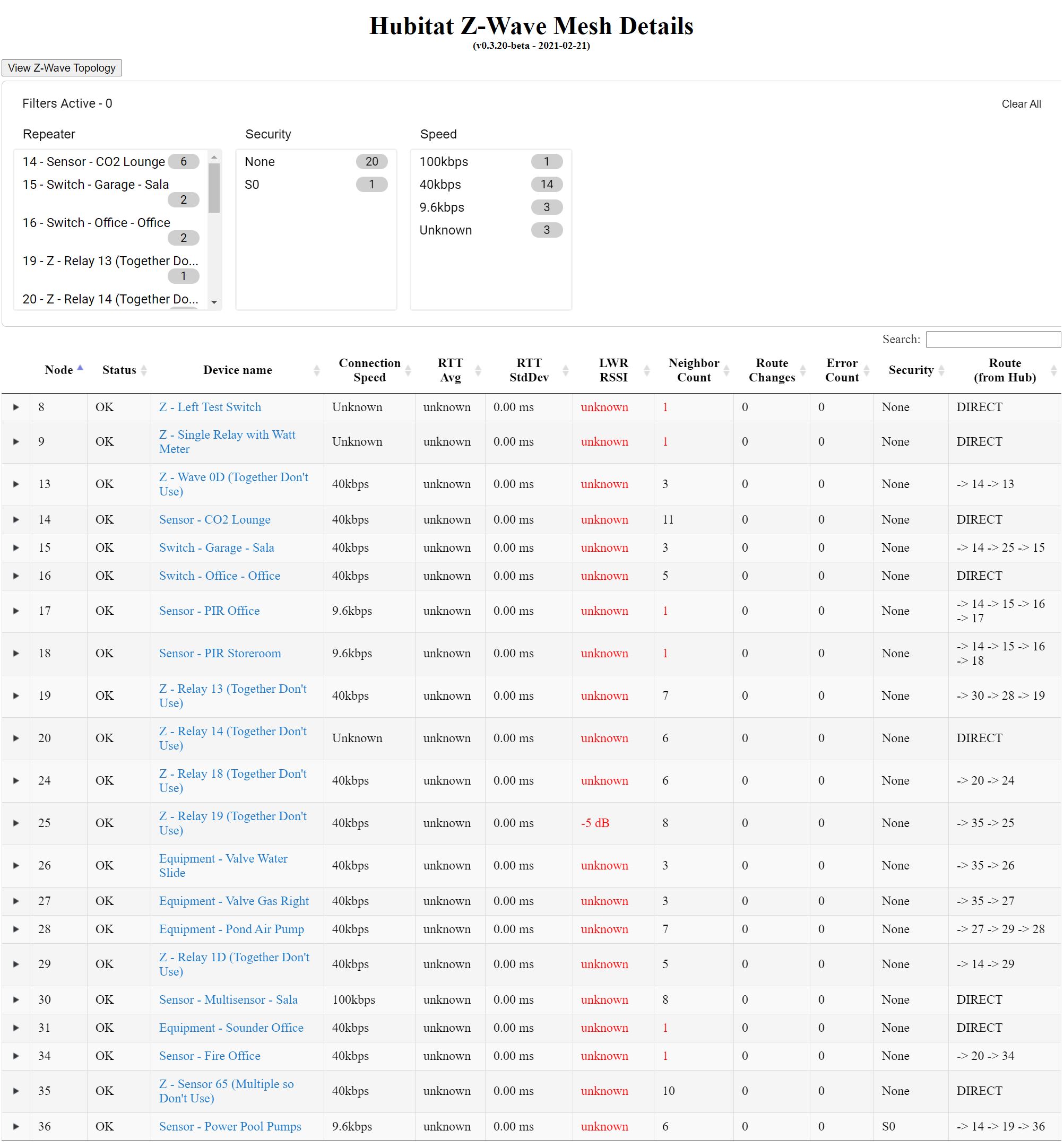

Mesh Details look like this tonight.

Your table looks pretty decent. I would start with shutting down the hub from the settings menu. Unplug power from it (at the wall NOT at the hub itself) Wait 5 or 10 mins and power it back up. After that run a z-wave repair. Even though you look like you have a good amount of mains powered device, you may or may not want to throw in a couple of beaming repeaters to strengthen the mesh. But first try the power thing and repair above and see if that helps.
Do you have any devices that might send frequent reports? Certain sensors or power metering devices can send info every couple of seconds by default. That seems to be a common issue people have that brings the zwave to a halt on the C7. Especially that Pool Pump sensor paired with S0 causes extra overhead due to the S0 security, but if it is not sending frequent reports it should not hurt anything.

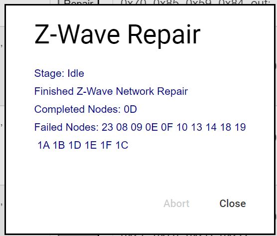

z wave repair
I have seen other people recommend NOT doing a full repair on the C7, it is supposed to self-heal over time. Do individual repairs on any single nodes that are causing troubles was the recommendation.
The constant repairs might be flooding the network with commands and causing even more trouble I am thinking.
