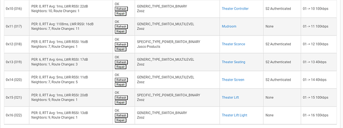

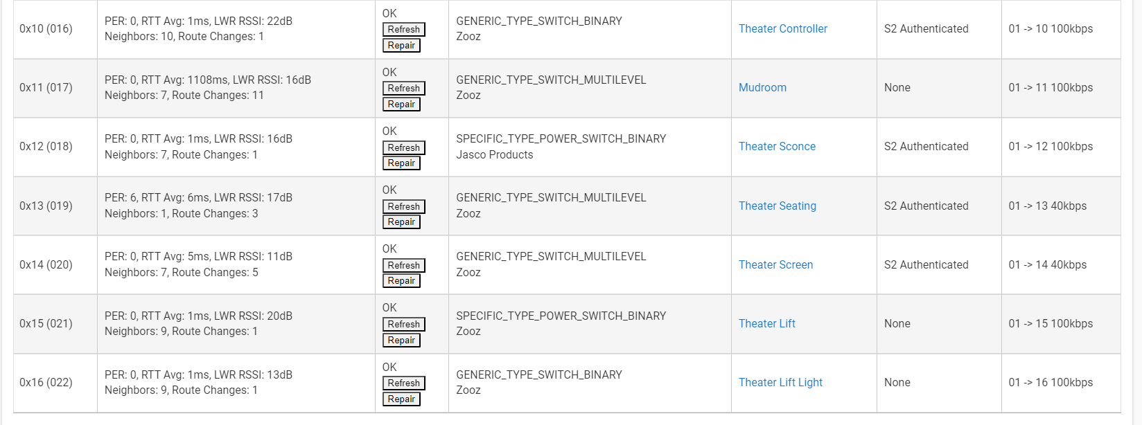

Here is the problematic Switch

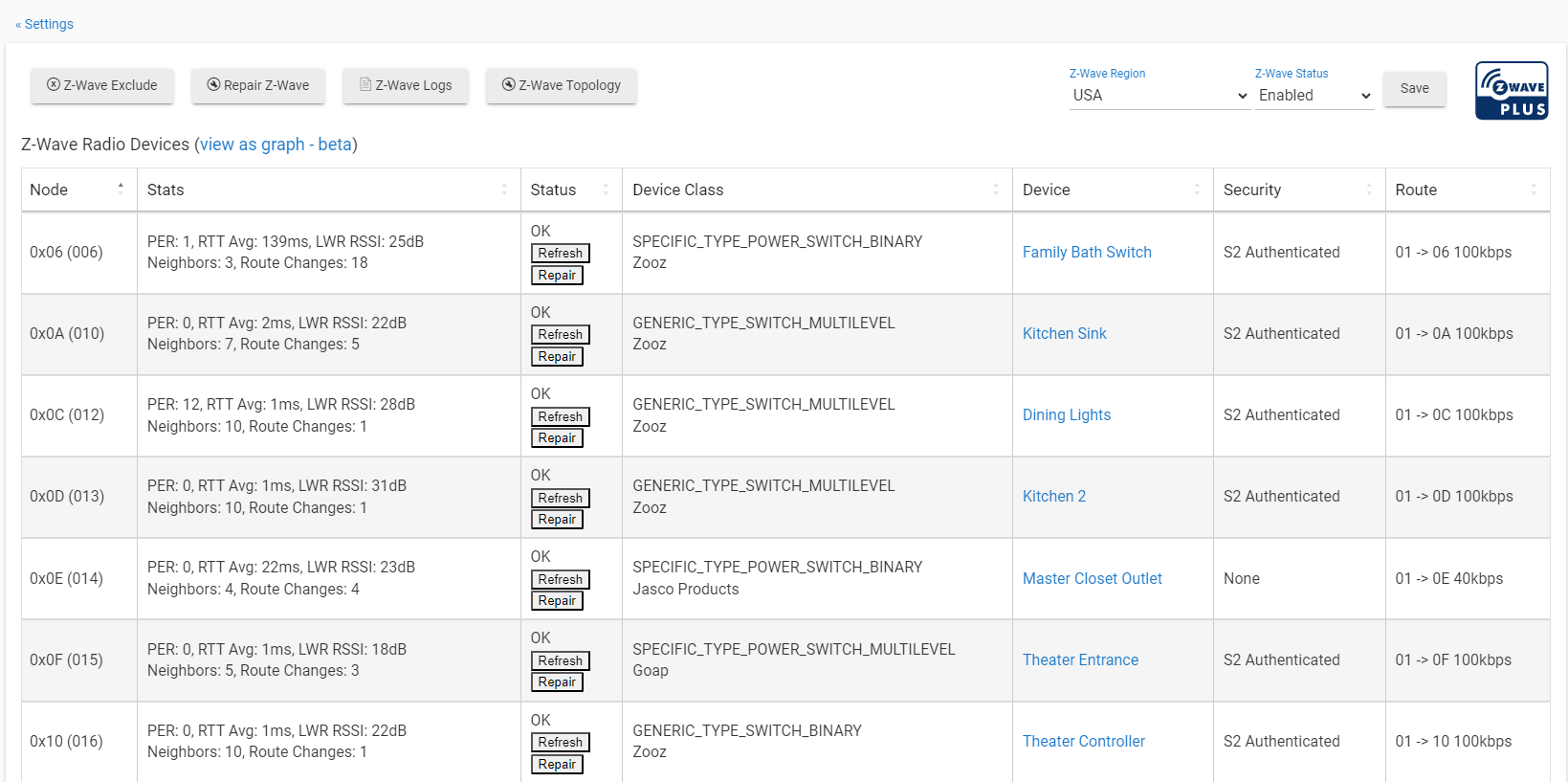

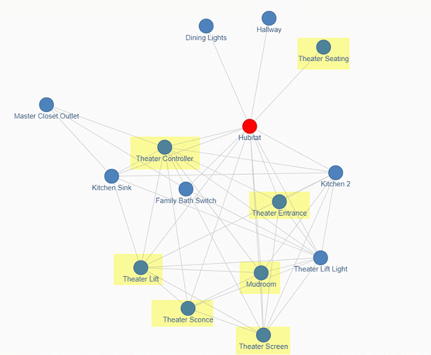

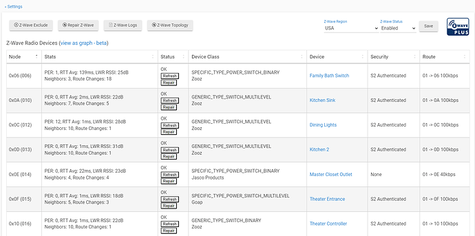

Here is my Zwave Graph
I have highlighted devices that are located in room.

Can you post a screenshot of your entire z-wave settings page? Just to make sure that this latency isn't caused by something else (like a ghost).

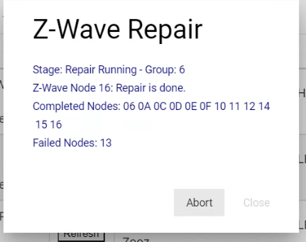

I did do a zwave repair and I saw an issue with Node13. Now I am not positive which device is Node13. I did have a HSM200 zwave device that I force removed because it was not longer functioning.

How do I figure out which device is Node 13?
Theater seating is node 13

How long was the hub running when you took those screenshots? The number of route changes on devices can be a sign of issues but depends on how many/hour.

How far is it from the hub and what other devices are between it and the hub?
It is picking a direct route, so possibly that is causing the latency, but possibly also the best option since you do not have a lot of devices.
The how is that the nodes are shown in both hex and decimal in the details. The repair pop up is giving you hex values so node 13 is actually 0x13 (hex), and you can find it on your zwave details page.
