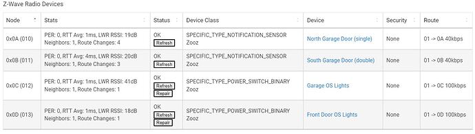

I have (2) Zooz ZSE43 tilt sensors (battery powered) in my garage that were installed prior to me adding a Zooz ZEN76 switch in the garage. Currently, all 3 devices route directly to the HE. The north ZSE43 works most of the time, but occasionally fails to indicate the door being closed. It may fail to indicate door open as well, but I rarely check the status with the door open. This sensor is further from the HE than the south sensor. I'd like to get the ZSE43 sensors to route through the ZEN76 switch. How can I make that happen?

What's interesting though is your signal strength and RTT all look strong though there are a bunch of route changes, which doesn't seem to jive with the signal strength. Those stats are all reset at reboot - I'm guessing you rebooted recently. Would be interesting to wait a few days and see what's going on.

I've just had somewhat of an epiphany in regard to the troublesome north tilt sensor (S1 on the drawing). It only reports closed correctly when my car is in that garage stall. My goal would be to get it to hop through the switch S3.
Question: Do my sleepy devices (tilt sensors) know whether or not their change of state message to the hub was successful or not? The mention of retries seems to indicate that sensor must be waiting for an acknowledgement from the hub that the message has been received. I guess if the hub doesn't know that the device can't talk to it, why would it even think about improving the route. Not sure how to proceed from here. Maybe do the exclude/include thing with the car out of the garage?
