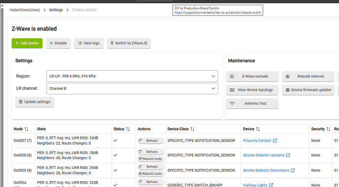

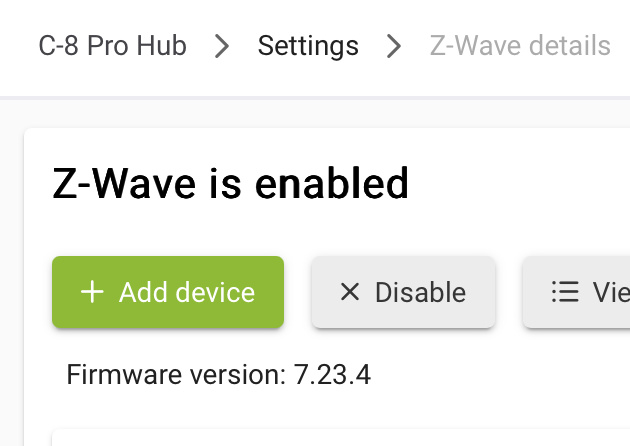

I'm trying to fiqure out what 7.23.4 is. Is it something with ZWJS?
That's the Z-Wave firmware version.

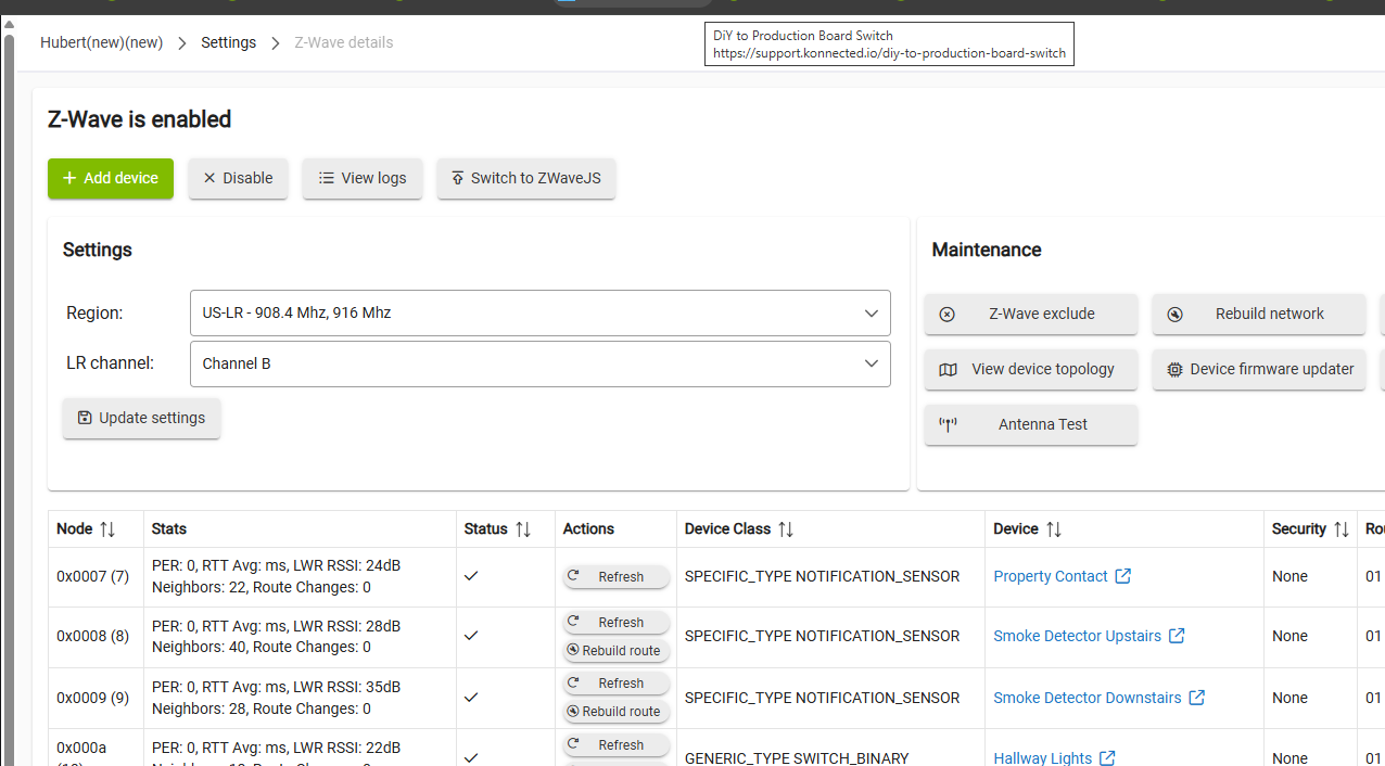

Visible on the Z-Wave Details page:
I don't have that, is it only there if you are on ZWJS?
Yes - JS only
