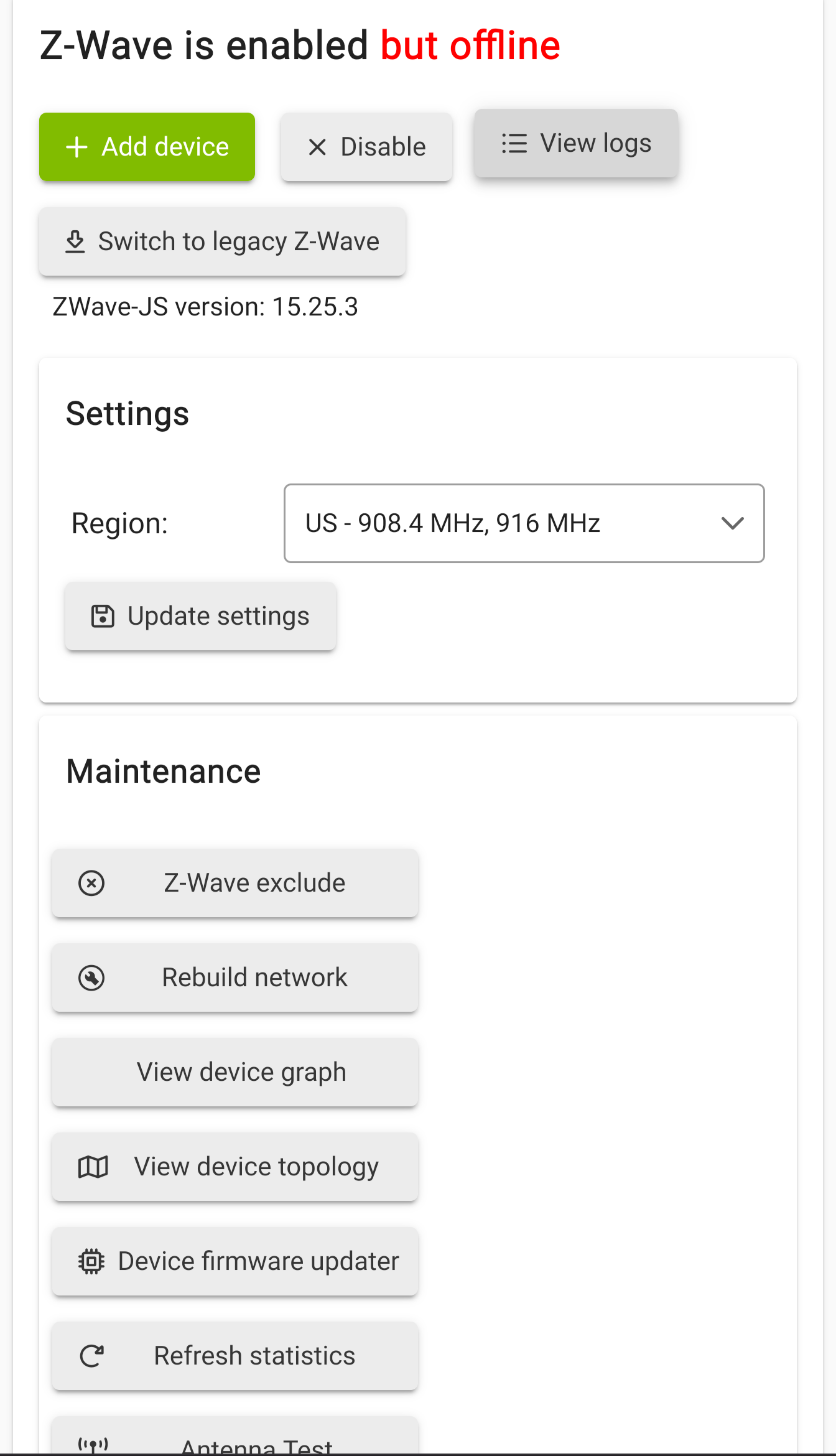

I just upgraded my C8-Pro from 2.5.0.159 to 2.5.1.139.
I did this using the “upgrade all devices" feature from other C-8 pro.
When it restarted, nothing (z-wave) was working. After a bit of digging, I saw this:
I did a full power cycle and it came back working.

It is supposed to start on it's own.. And it did in beta.. Would you mind PMing me your hub id?

I had the same issue. I attempted to disable the Z-Wave, thinking that restarting it would fix the issue. The Zwave settings screen stopped responding. I was able to reboot Hubitat (I have c8 Pro on Node zwave). It came up with Z-Wave disabled (my change). Re-enabling Z-Wave brought it back to the state it was before… enabled but offline.
I read this thread and tried another reboot. It came back fine.

Next build this will be fixed... If you already updated, a reboot will resolve it..
