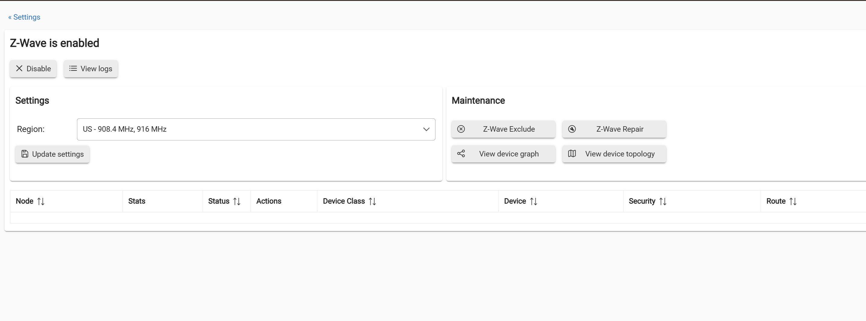

Happened again. Here is a screenshot of my Z-Wave Details:

  1. Did you check your Z-Wave Details page for ghosts before the most recent event?
  2. Did you check App Stats and Device Stats for over-active apps/devices, and did you check your logs for warnings or errors?
If you do have ghosts, they will just transfer over to the other hub when you restore the cloud backup. Also, remember that cloud/LAN integrations may need to be updated w/new HUB UID.

So, any device without a routing is or can be a ghost?
Here is a portion of my Z-Wave Details (from new box) showing devices with Names & No routing plus one with no name and no routing.
Corrrect. Since it just popped up with a known working hub.

Yeah, you have a mess, unfortunately. All of those that are mains powered and don't have routing are likely ghosts. Sometimes things can clean up somewhat if you do a shut down/pull power/wait 30s/restart, but if this screen cap is from after you did that, then you're going to have to work on removing all of those ghosts.
To clarify - the screen cap is from the original hub, or the hub you did the cloud restore on? If the Z-Wave Details screen looks like that you are going to have problems.
Not necessarily. A migration would have cleared all the routing to be rebuilt.
Also, I think sometimes when Z-wave crashes the routing will go blank for a short while. Battery devices can take 24hrs or more to populate.
Usually a ghost is a z-wave node with no "device" attached to it and often has no routing. Especially for failed pairings, there is no device. Looks like you have two of those. A ghost with a route, is possibly still a live device, or just has a cached route.
You can also have nodes with a device, no route and that do not respond to anything. These could be ghosts as well if the device was reset, broken, or dead batteries.
Yeah I wasn't clear, I was thinking that came from his original hub, but he was talking about both hubs. But if it came from his new hub then it could be just all the routes are filling in, as you note.
Sorry, I keep getting interrupted. I was going to ask the if that is from his first hub, that means he transferred those ghosts to his second hub, where they will still need to be dealt with.
Sorry for the delay. This las screen shot is from the "new" hub. I removed the one device that had no name and no routing. Then I tried to remove "d3" which only has a "Refresh" button and it said "No responding".
The others on the list without routing, but has a device name, are mostly not present. I will remove them. But serveral are and not showing routing "Front Deck: Double Outlet", "Back Deck: Cabinet Light", Guest Bedroom: Overhead Light" for example
