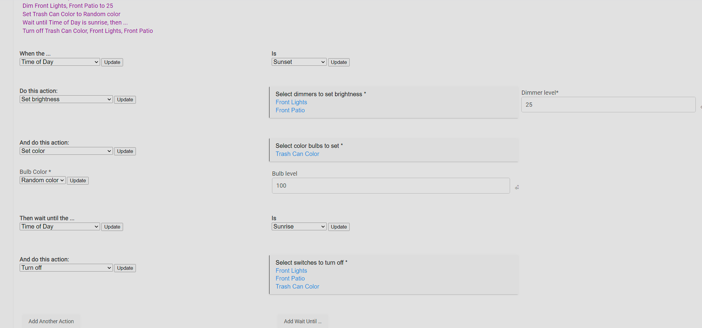

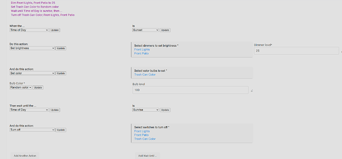

Here is the rule. Pretty basic. The rule call for 3 lights to turn..2 with smart bulbs and one with the dimmer... its just the dimmer that doesn't get the turn on command. If I turn it on with physical switch it works. Here is the Rule

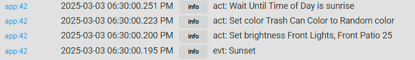

And here is the log for tonight when it turned on
I'll make note of an evening when it doesn't turn on and check the logs.

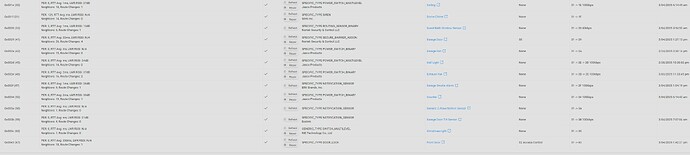

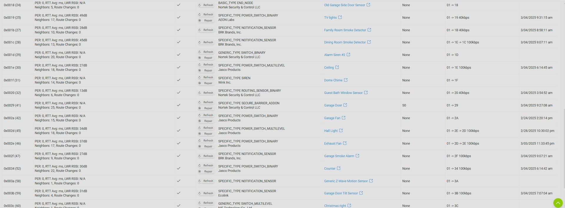

Would be good to see the entire z-wave details page (May take multiple screenshots).

Can you refresh the stats and get those again. Also please give all the info listed below:

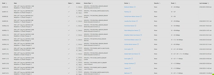

Need to see the full z-wave details again after you click Refresh Statistics button please. Sorry I forgot to mention that the first time.

Are you sure you clicked on Refresh Stats? All the RTT values are blank.
With an uptime of 10 days there should be more info in there.
May need to refresh the page after clicking refresh stats.

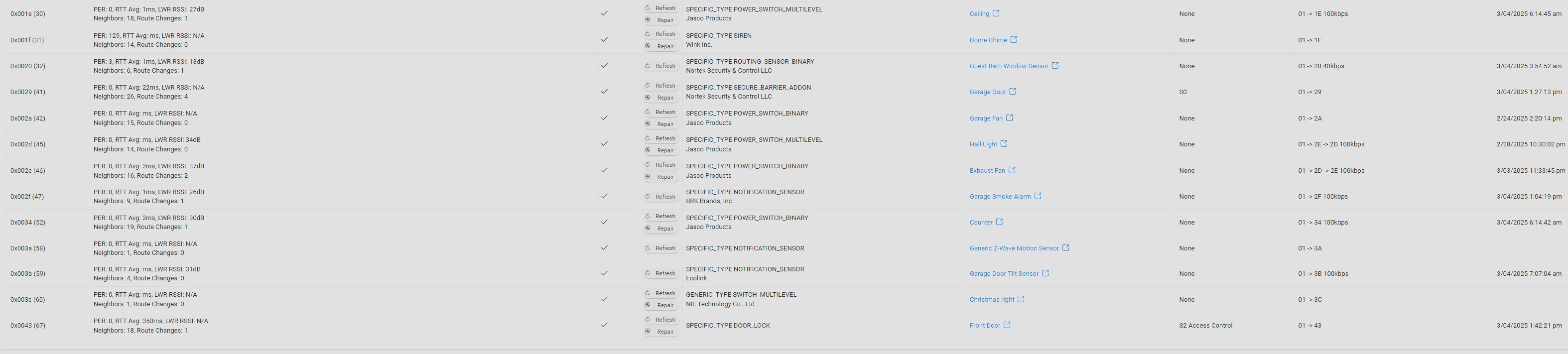

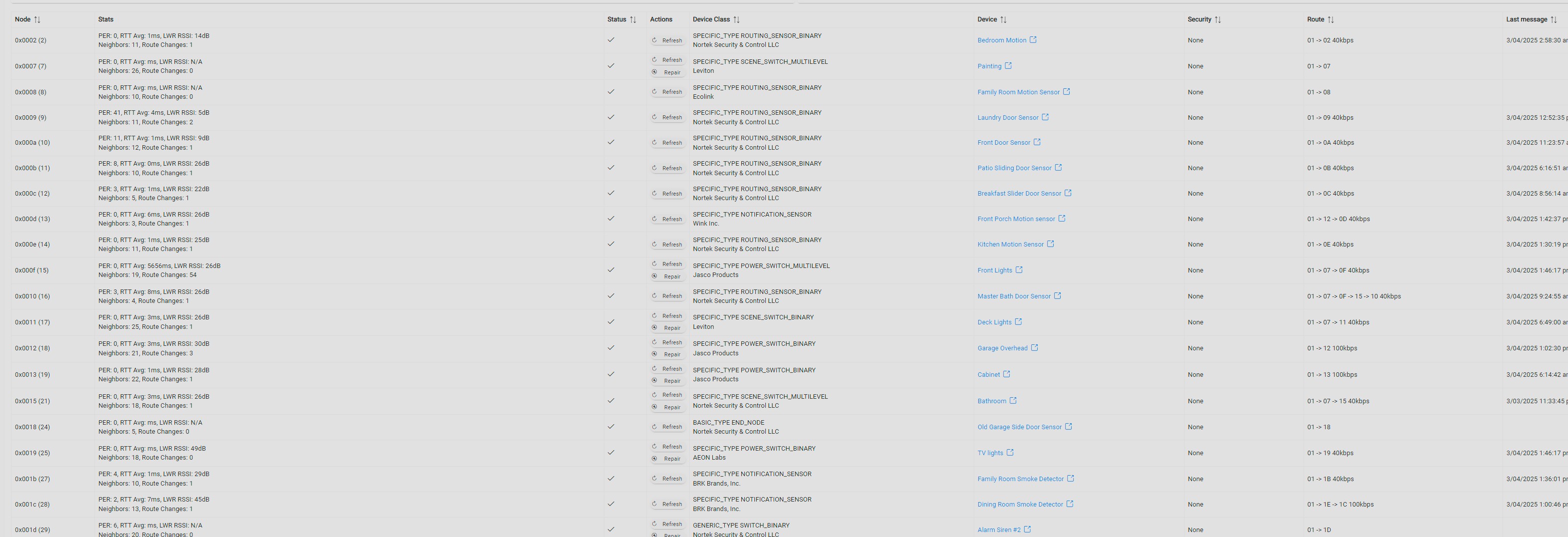

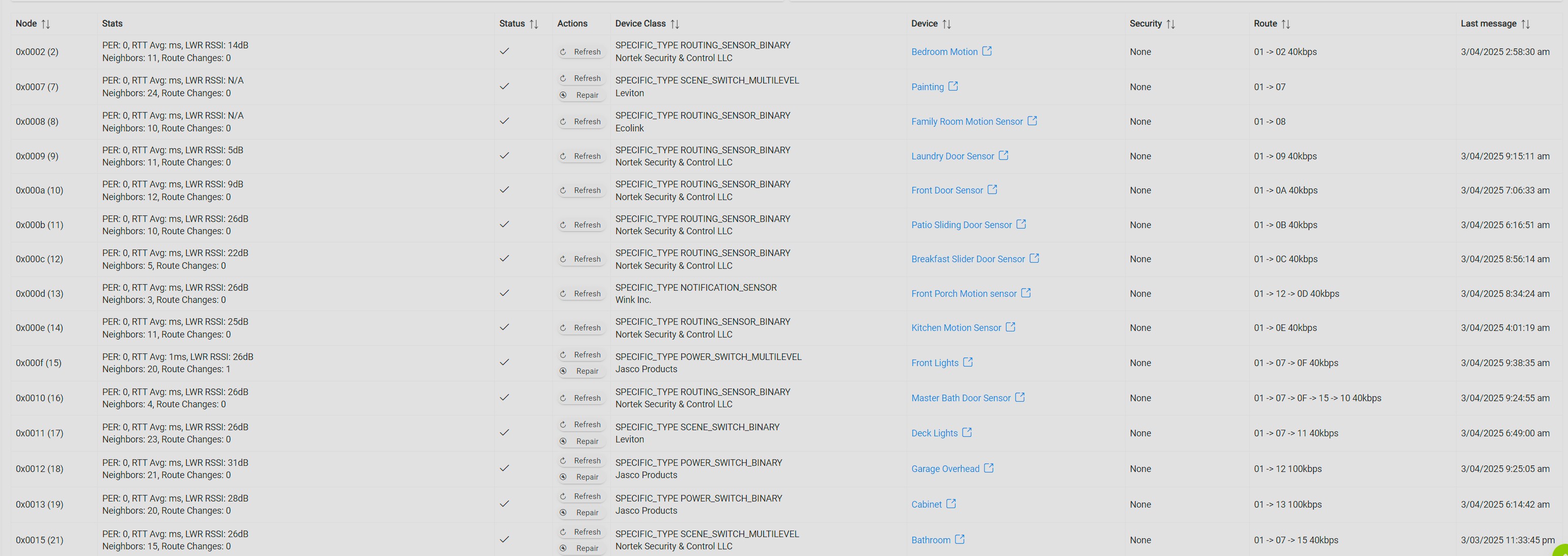

How's this?
Bingo now look at these numbers for the Front Light compared to all the other devices.
It seems to be struggling. Its having a hard time talking to the hub, and keeps switching routes. The RTT is the round trip communication time. You want less than 100ms, less than 10ms is optimal.
Any metal or other interference it may be getting? Does it have good options for other repeaters nearby that are always online?
Looks like a few devices are trying to route through 0x07 (Painting) but it kind of looks like that device is offline? Can you verify if that device is working?
