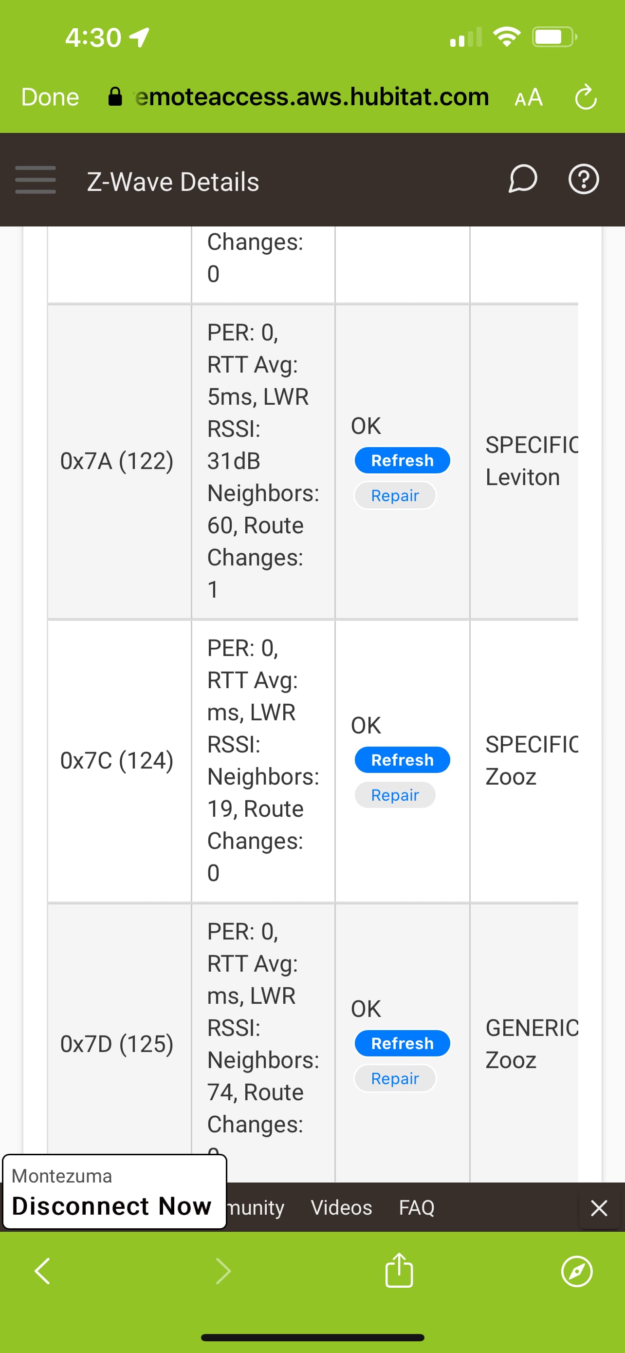

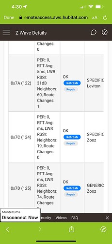

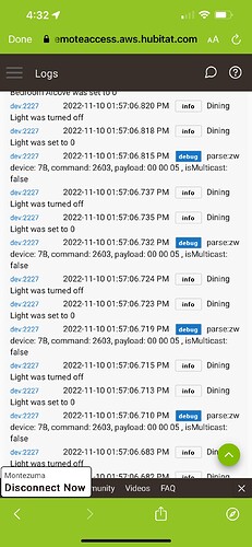

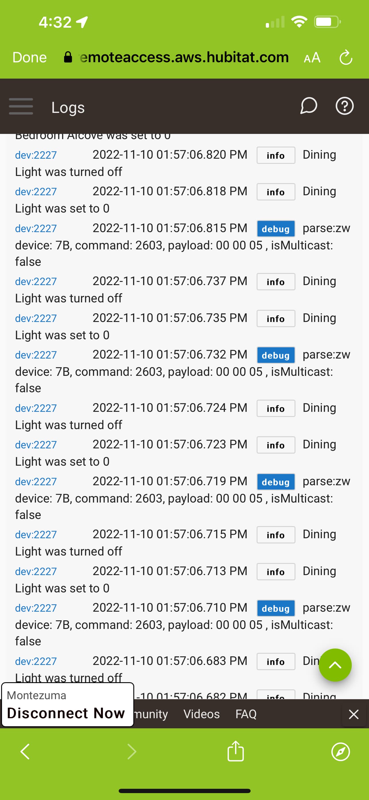

I may have a similar problem. When looking in the logs for the cause of a network storm I found this:

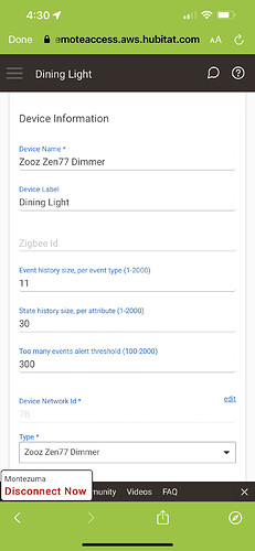

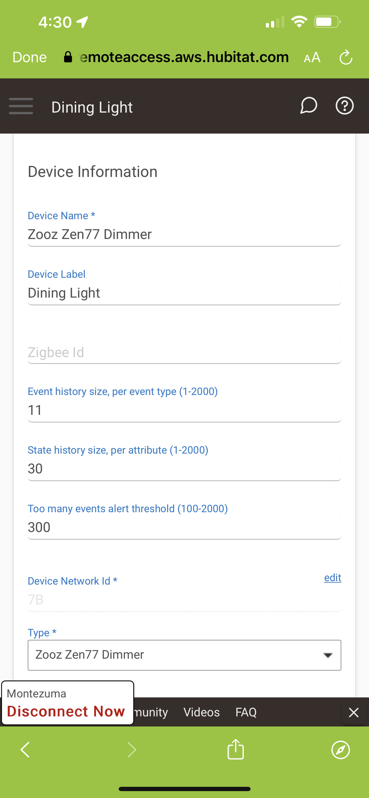

The interesting part is the device is in my list of devices with an ID of 7B
But the device is not in the z-wave details
The device does work sometimes. It is in a scene and turns on with the scene.
I have not knowingly done any changes to this device in over 6 months.
Do a full shut down, pull power for 10 seconds. Boot back up. See if it comes back in the zwave details. Thats the usual solution when the entire table goes blank but devices still work.
