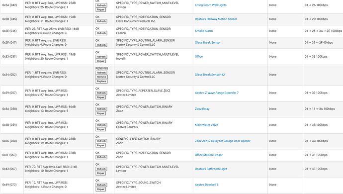

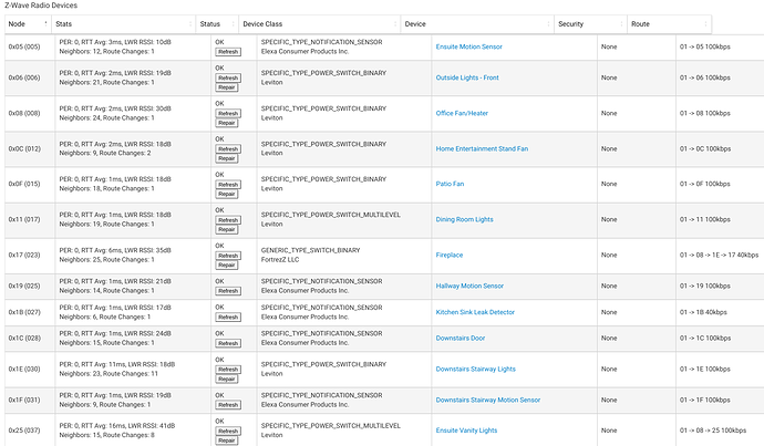

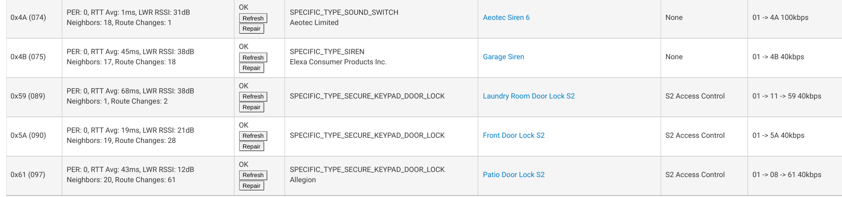

Here's my z-wave details I have one glass break sensor I need to repair from migrating from the c5 hub to the c7 and an aeotec siren that the driver also creates a doorbell device (neither this doorbell or the glassbreak sensor are ghost nodes):

What's up with 0x34 (glassbreak sensor) Is that actually working or is it a ghost at this point?
For some reason it didn't migrate over through hub protect from my C5 to my C7. Have to fix that node but was lower on my priority list of things to fix after migrating.
