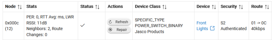

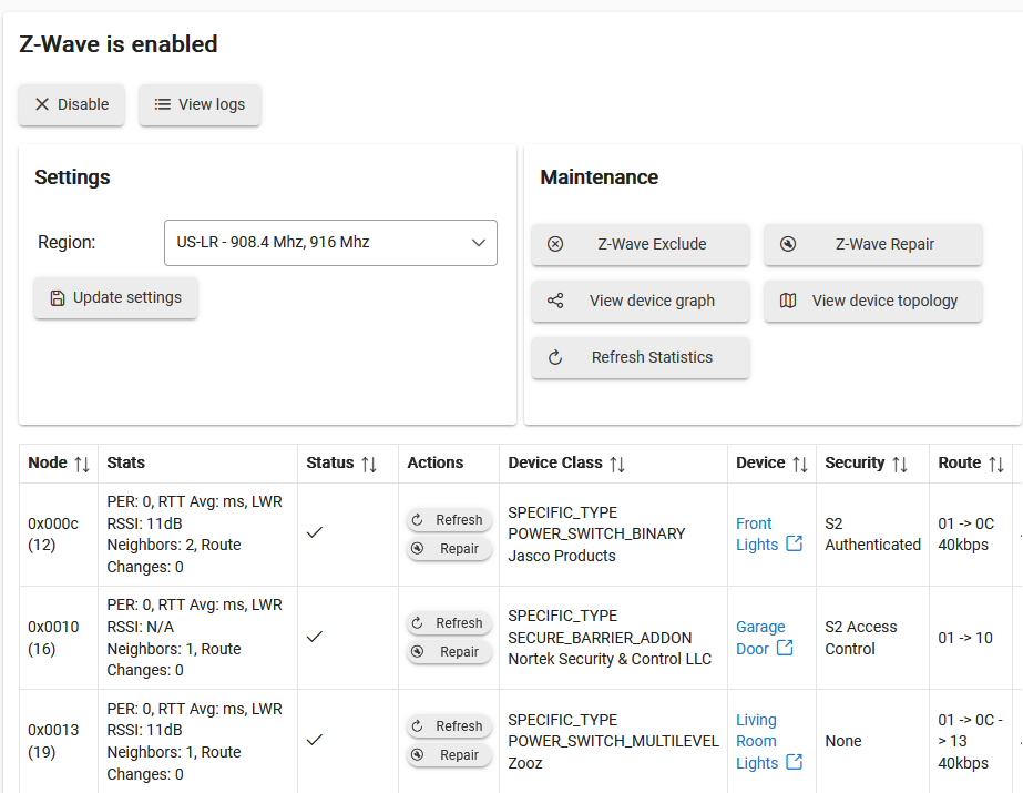

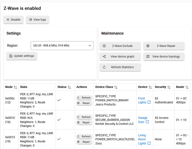

Can you post a screenshot of your ZW Details page (Settings -> Z-Wave details)... In particular, a full capture of the table on that page.
It appears you just have a few devices, so they should all fit in one screenshot.

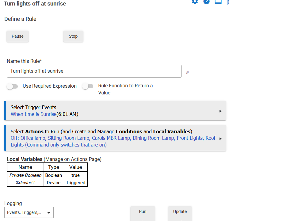

ETA - maybe post a screenshot of the corresponding sunrise lighting rule too... Might as well try to cover all bases here.
Here you go - appreciate the assistance....
Hopefully one of the smarter ZW folks will be able to weight in here with their overall thoughts, but how old is that Jasco switch?
Some older GE/Jasco models are prone to issues where they can wreak havoc on the mesh when they start failing prematurely. I think their newer models are better, but @danabw - would you be able to add some more color on all that?

Your Front Light is directly connected to your hub (see Route column). Not top speed connection (40 rather than 100) but should work fine.
Sounds like you can consistently control it from its Device page or Dashboard w/out issues, and it's only failing when called from your Rule. If the switch was failing I'd expect problems controlling it from Rules, Device page, & Dashboards.

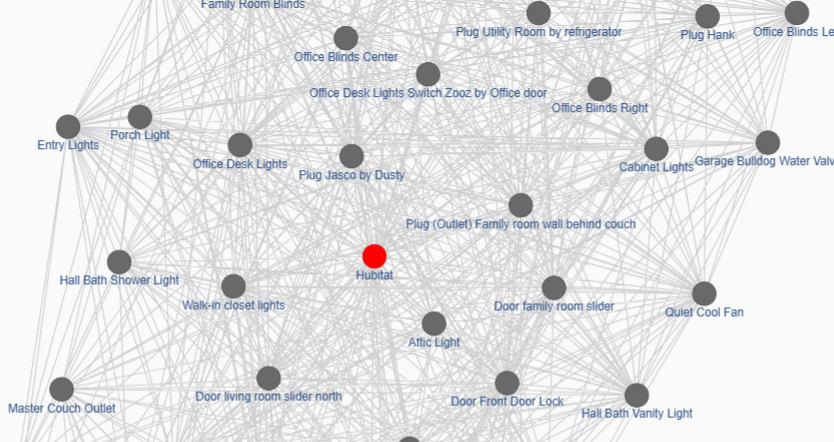

I don't think you need to worry too much about the loop being there or not. I don't spend any time looking at my Z-Wave graph as mine is just too hard to read.
Post your current Z-Wave topology. Here's a post w/a good explanation w/examples of how to read the Hub Z-Wave Topology:
And the usual "if it ain't broke" rule applies. If things are working, leave 'em be. :slight_smile:
Amen on the "if it ain't broke" rule!
Your graph looks like a Manhattan NY street map.
