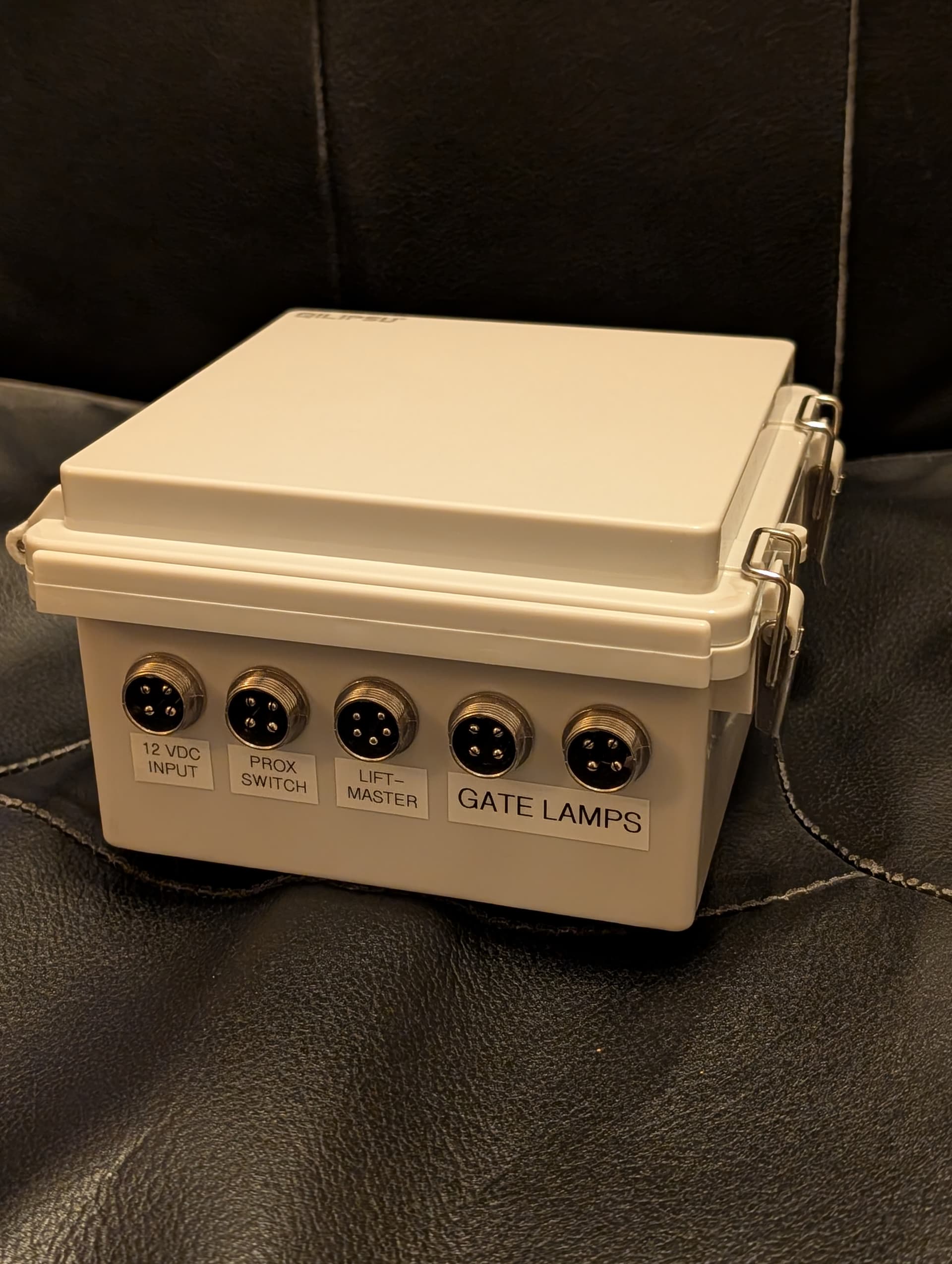

I designed and built this controller:
The case is plastic.

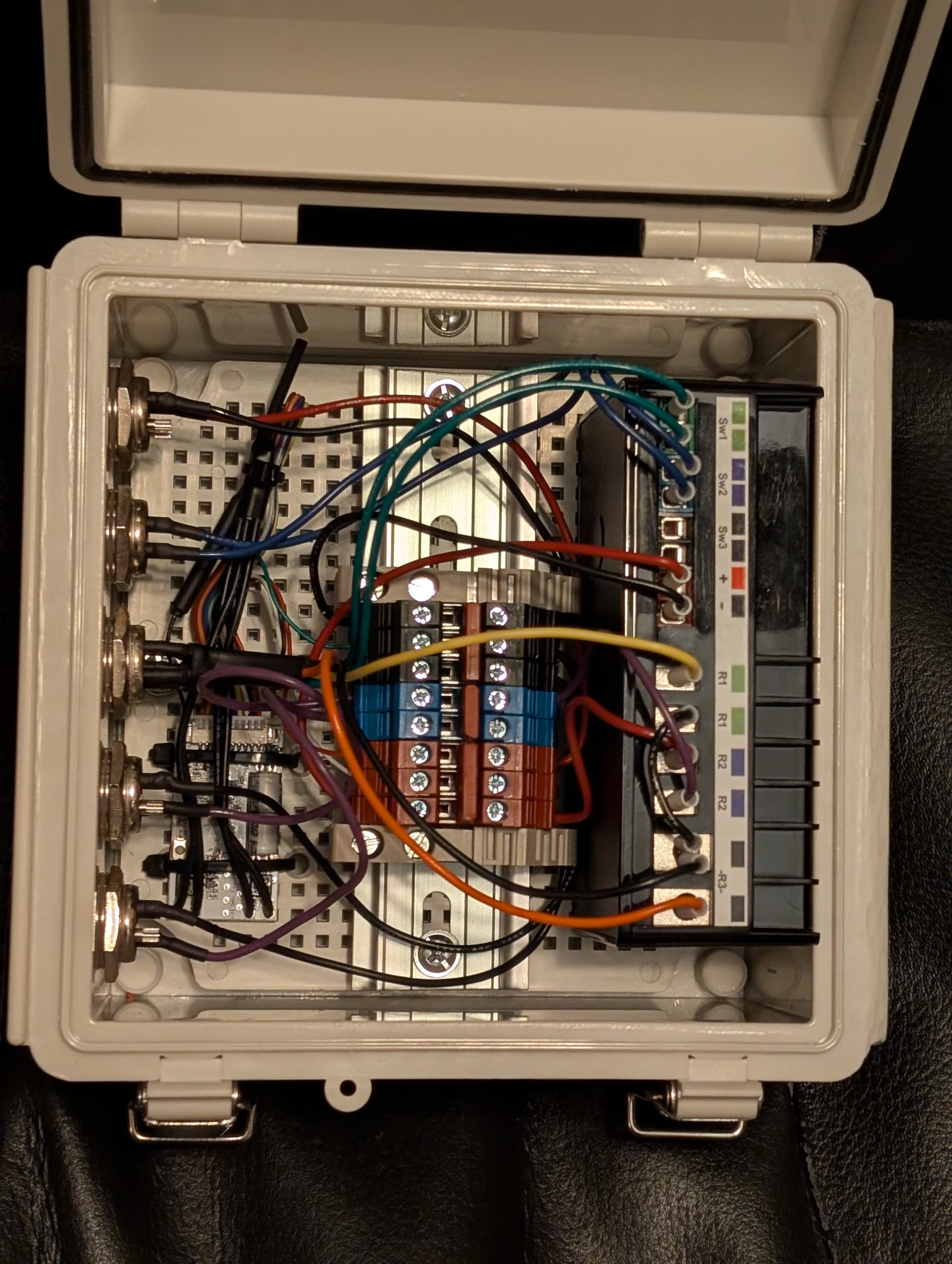

Inside are a Zooz ZEN16 and a Shelly Plus Uni.
The Uni is only for reporting the battery voltage (the Liftmaster runs on a 12 V battery that is solar charged.)
Using z-wave I can open and close the gate, turn on the 12V gate-post lamps, and read the status of a proximity sensor (reed switch) that activates when the gate is closed. So far so good.

It dawns on me, looking at the interior photo, that I've bundled the Uni antenna tightly with the 12 VDC wires. They connect to the battery, but I wonder if they are carrying a lot of Wi-Fi RF right into the Liftmaster control board.
I definitely need to isolate whether it is the z-wave Zooz or the WiFi Uni that is the culprit.
