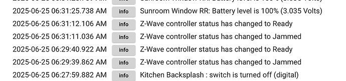

Z Wave controller Jammed
C8Pro 2.4.2.119 ZwaveJS
@bobbyD et. al. Any thoughts?
My guess is that you have a device or devices that are flooding your network, might have to open up the ZWave live logs and do a capture to pinpoint the culprit(s) though.
I’ve had three of these in the last two days but they seem to have no correlation with anything.
Would be nice if I could keep the logs running and dump them when the issue hits.
@bcopeland Would there be anything in engineering logs? Think this I’d related to the ~15 second delays I see every now and then on Zwave operations?
You can keep zwave JS logs open and it will fill up and just keep going. You can then dump a text file with the download button, and trim if needed.
You can also dump ZW JS logs into AI and ask for an analysis, a few people have done this already with good feedback from the AI.
Not engineering logs.. But Z-Wave logs should have something.
Most likely, yes...
