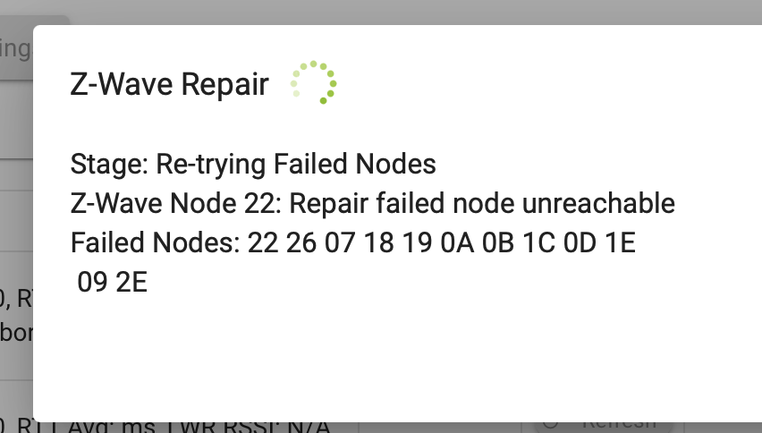

Running latest FW on C7 hub and just noticed that my last device communication was over 5 hours ago. Appears all my z-wave devices have gone offline. (my zigbee devices appear ok)
Done a network repair and get message saying all nodes are unreachable.
I'm guessing there is a quick fix or reset i can try.

What specific FW are you running? Rebooting my temporarily fix it, but depending on your answer to the first question, it may impact other steps. Are you in the beta program?
The usual suggestion is to shut down the hub gracefully then unplug from power for 30 seconds to reset the radio
FW 2.4.0.151
reboot was the first thing i tried then the network repair.
I dont do beta's- only the official releases, which has been current for several weeks now.
reboot isn't a fix for these symptoms. A power cycle is the traditional advice.

Thanks for that tip. Done that and everything appears to be working again.
