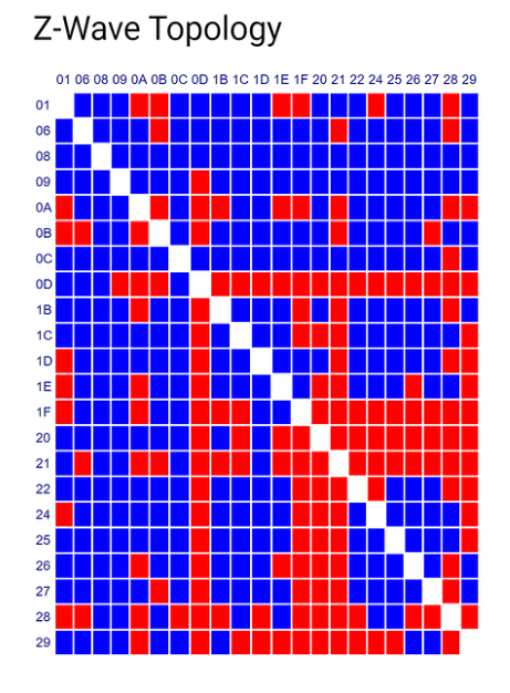

If you do enjoy digging deeper into your Z-Wave info, you can take a look at your Z-Wave topology (button on Z-Wave Details page). Start in first column for each device, and look to the right - when you hit blue squares look up and you'll see the device that is a neighbor (can see each other). Red squares indicate not neighbors. This data (like the Z-Wave stats is "point-in-time" and can change over time, of course.

Checking out your topology might provide you some clues/info supportive of the routes...or might not.
You could do indivdual repairs on the devices w/the routes that you're concerned about, that might help get them to look around and find different routes.
